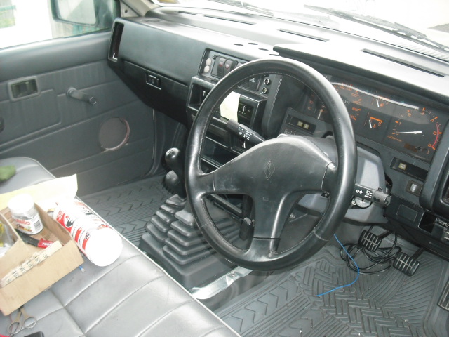

Yeah I put in a 2wd Nav. handbrake when I did my porno bench seat swap, as can be seen in photo. Plug and play, just removed the firewall cover plate and used the 2wd cables etc. Even the Terrano dash had a little plastic cut out all ready for it.

ChurchurDan wrote:http://www.offroadexpress.co.nz/Forums/viewtopic.php?f=18&t=39075
Awesome work on that swap, gets the creative juices flowing reading that thread
