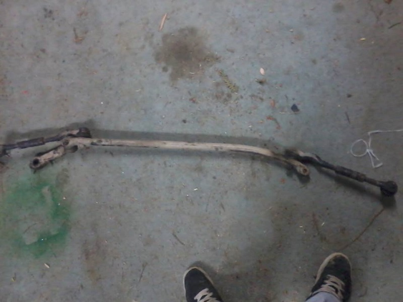

anyone else come home from 4wd on the weekend with some bent steering arms only noticed once wheels was off drove fine haha

This you? Mate how did you manage that?!
Theres a couple of these trucks at pickapart at the moment, pull the draglink for $20 or something ridiculous.

i wouldnt have a clue aye man and yeaah i found a guy in ;levin who has one for 20 buk going to get now . how do i upload pictures . whats your name man? guy with terrano?

if you strengthen your tierod with a bit of angle or something other than the wof guys getting a bit funny about shit welded to your streering components just bare in mind your shifting the weak or fail point to somewhere else so it could be a balljoint or other part of the steering linkage that bends or fails next time causing you bigger or more serious problems (seen it happen with a tube sleeved over the tierod and the balljoint ended up shearing off
), sometimes its safer to keep dealing with a bit of a bend in the tie rod and you learn how to do bush repairs and straighten it with a strop or winch pretty easily

derk wrote: your shifting the weak or fail point to somewhere else so it could be a balljoint or other part of the steering linkage that bends or fails next time causing you bigger or more serious problems (seen it happen with a tube sleeved over the tierod and the balljoint ended up shearing off),
Not sure I follow your logic w this one derk...
Breaking a suspension balljoint stud is extremely rare and no more likely than breaking a leaf spring. That should only happen through extremely poor maintenance or massive overloading (tyre size). I dont see how sleeving tierods is going to lead to a balljoint failure.
My question is how the hell do you bend a draglink made out of 1.25" solid bar, without bending a tierod first? Frontal impact?

didnt bend anything else just that was lucky i could get it home
