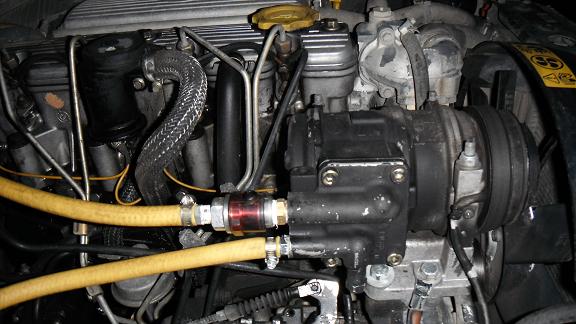

Use proper compressor oil rather than engine oil or CRC. Mixes better in air and will also lub your air tools better. Cheap as from Supercreep. I used a Hiace master cylinder as an oil resevoir & a 1mm oil line into the suc side of pump. Works sweet as. don't worry about collecting the oil again as it is minimal. Put some new tyres on a couple of weeks back. No sign of oil in the tyres

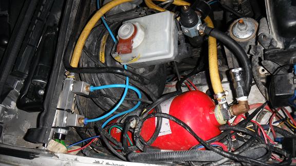

have not long finnished a install on my disco.
i had a rear chinese locker that came with loom , switchs and pressure valve.
so split that all up and ran the power to the little 12v pump to the air con clutch
air is drawn from the air box so it is filtered and shouldnt get wet
put a inline oiler infront of the pump and a water/oil trap after it.
used a 2.5kg fire ex bottle and my brother made me a little alloy block for the 2 locker switchs and the pressure sensor.
works great. also great to have both lockers in
