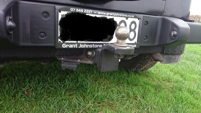

If it has a rear towbar you should be able to use that. If it has a removable tongue you can buy something like this http://www.4wdbits.co.nz/ProductDetails.aspx?productID=4285 Or if the tongue isn't removable just take out the towball and fit a shackle through the hole. But make sure the towbar is bolted on properly. :wink:

zukmeista wrote:If it has a rear towbar you should be able to use that. If it has a removable tongue you can buy something like this http://www.4wdbits.co.nz/ProductDetails.aspx?productID=4285 Or if the tongue isn't removable just take out the towball and fit a shackle through the hole. But make sure the towbar is bolted on properly. :wink:
It is of the removable variety so I will look at getting something like what you have suggested. Thanks for the advice!

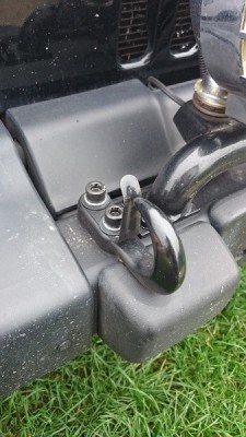

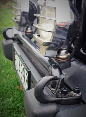

Front hooks
Front hooks
Front hooks again
Front hooks again
They look fairly substantial to me. But then again, I don't really know what they should be like :)
The back
The back
And one of the back, just for good measure

Do the hooks have any numbers on them? Most aftermarket tow hooks will have a max pull rating on them and will bend open when this is exceeded, some hooks will just break off which is obviously not good.

Take a closer look. Those hooks do have the load rating stamped on them.
More importantly is to not shock load them when doing a recovery by using the wrong type of recovery strap.

While not an upgrade, or a safety item, I would probably move the plastic trailer light plug from where it is before it gets broken.

^^ good point that will get ripped off first time you go offroad.

Hooks may be ok. But check those bolts. Are they rated? Can't tell from the photo on my phone. You can easily replace them with rated ones.

I had a look at the front hooks today, both have max load 10000 LB. And yes, I double checked the zeros :wink: I can't see anything written on the bolts though...

Ok the hooks will be fine to tow off although would recommend putting a strap between them to spread the load on a heavy pull. If you can't see any markings on the bolts it would be a good idea to replace them with high tensile ones, 8.8 should do the trick. Take the old ones into an engineering supplies shop or similar and ask for bolts the same as the ones you have but high tensile ones. Some spring washers wouldn't be a bad idea either.

Hey babe :shock: , if you want to play without getting hurt please have your vehicle checked by reputable 4WD people, you have done the right thing by asking and you are getting good advice ----- but we can only look at photos and that doesn't tell all the story. For starters, the front hooks are fine to recover from and the bolts --- well most hex bolts are 10.9 rated so should be ok ---- but what is under the hooks ? are they through the chassis or bumper irons or a bit of light weight metal with captivated nuts ?. Go to someone who has experience with off road vehicles, even with clubs you can get very knowledgeable people and then there are people who think they know everything. All the best,
