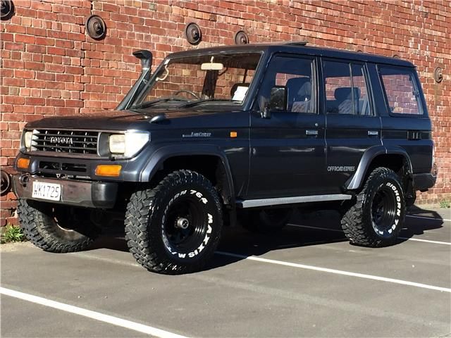

So I've been shopping for a manual KZJ78 with sunroof and difflocks for a while now and this came up. I've seen 4 so far and I missed 2 of them and couldn't afford one of them. KZJ78 manual with sunroof and difflocks are pretty rare.
http://www.trademe.co.nz/motors/used-cars/toyota/auction-761265820.htm
But the thing is this one's 250,000kms, not as tidy and a whopping 15k! I can afford it but I don't know if I want to spend that much. My original budget is around 12k for the truck and an extra 3k for intercooler add on.
The previous 3 I saw were very stock and original, which is what I'm looking for.
1st one:
122,000 kms - $9000 (Listed 8pm at night, next morning I went at 8am with cash on hand and it's gone already)
2nd one:
168,000 kms - $12000 (Couldn't afford it at that time)
3rd one:
225,000 kms - $11000 (Someone else beat me to it)
What do you guys think? Worth the buy? Or should I just wait for a next cheaper and better one to come up? $15000, dealer's 90% sure head's been replaced recently, had big bore exhaust.
I won't be doing any hardcore offroading on this. It'll be a daily driver and family wagon for holiday camping trips. But the ultimate reason of purchase is personal preference. I just like the square shape of it lol.
1st one:
2nd one:
3rd one:

Btw, I can see an OffRoadExpress sticker on there. If the previous owner can pm me that would be of most help as the dealer's not really answering my questions properly.
Re: Is this KZJ78 a good buy or way too expensive?
15k is too much I have seen manual ones go for about 9500 unmolested with a rear locker, 8-12 max, no mention of the head being done and its at 250k so factor in another 2500 to get this done
Check any along the roofline for rust and the sills and rear corners for rust/damage
ECU's are another known problem, $300 to repair
Also if it has a dual mass flywheel that's worn out .... 2k from memory
Check the power steering pump for leaks
Get the fuel pump checked
Check the viscous fan hub as well as the condition of the radiator fluid
Check the underside for damage

I havn't been watching prices but it looks dear to me. I've got kzj78, manual, factory diff. For comparison I paid $18, 6 years ago - incl 2 sets of wheels, near new road and mud tires, winch, cargo drawers, bars, prs radio, full height clip on caravan awning, snorkel, alarm, etc, etc 150K's, full service history, very very tidy (not any more).
Having the manual and driven a couple of friends autos - I would go auto unless you do a lot of open road driving- the small turbo diesels like the 1KZ work really well in front of an auto off road. Round town the auto's nice as well. The factory locker is a nice extra but you can get an auto locker for $500 or even less, I'd guess another $500 to get professionally fitted?

Thanks for your input guys. Yeah I think it's slightly expensive as well Jerry. I think I'll pass on this one and wait for an unmolested one to come up in the future.
I think I remember which one were you talking about. I saw a champagne gold one few months ago. Manual & difflocks but no sunroof ($9500). Might be the one you were talking about.
Drive it,
I used to have an auto KZJ78 but the head cracked and I sold it. Someone bought it cheap, fixed it up himself and sold it back for a higher price. My dad currently still has his auto one. But it's really boring to drive. Gear changes are way too sluggish for me. Manual is so much more fun!
Are aftermarket e-lockers as strong as factory ones? I never knew they cost that little? ARB's airlockers front and rear are about 3.5k fitted the last time I asked..
Drive it,

Be very, very careful of that seller.... PM me for details.
1997 Toyota Surf KZN185 Intercooled, Silver/Grey, 2" Suspension Lift, 285/75/r16 Hercules Terra Trac D/T, 16x8 ROH Black Track Steelies, Roof Cage, 42" LED Light Bar, Limb Risers, Snorkel, Auber Gauges, Thicker Core Radiator, MCC Winch Bar
regan johnston used to $1 reserve his trucks and shill bid them to get what he wants, I made the mistake of buying one, all the fresh black paint and silicon soon wore off and the dog i bought exposed itself, it should not have even had a wof. I would give anything he has for sale a VERY thorough look over before even considering purchasing. . .
If you look carefully at pic 11. The bolt at end of suspension arm doesn't look right .Its not centered, appears to be too high meaning bush might be slogged out.

tallsam66 wrote:If you look carefully at pic 11. The bolt at end of suspension arm doesn't look right .Its not centered, appears to be too high meaning bush might be slogged out.
Or it has castor correction bushes??

Thanks for the warning guys. It appears that a few people had bad experiences with this trader in the past. Yeah I think I'll definitely give this one a pass now. Considering I can't personally be in ChCh to inspect the truck. He does make the pictures look pretty good though.
tomsoffroad wrote:tallsam66 wrote:If you look carefully at pic 11. The bolt at end of suspension arm doesn't look right .Its not centered, appears to be too high meaning bush might be slogged out.
Shouldn't need any not like its got any real lift ... but could be.
All that guy does is buy cheap trucks on TM stick some black rims and MT's on then about 2 litres of silicone and asks thousands more than original price. Was a hilux on there a couple of months ago, original list price was $5k he did his tarting up and then tried to sell it for $12K
