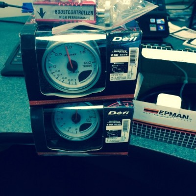

Hey ya,
Christmas arrived today. See below...
I'm installing these in the challenger 4m40.
So will post the process.
Boost gauge
EGT Gauge
Boost controll
I understand no point spacing the waste gate as boost controller does similar thing? Is that right?
Might have some spare Egt and boost controllers to sell too.

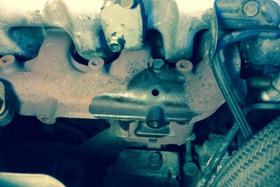

Re: Gauges and boost controller install
would have been better if you bought diesel ones rather than petrol.
you will need to have the egt gauge as pre turbo sensor otherwise it will annoy you as it will do very little if its after turbo.
I'm installing in middle of exhaust manifold pre turbo so gauges are well suited.

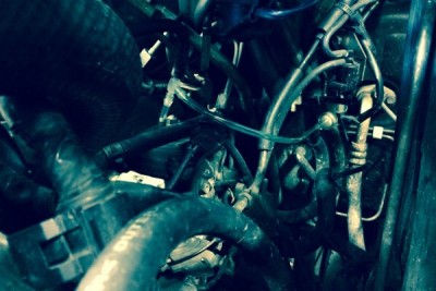

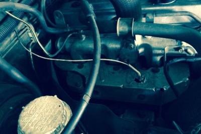

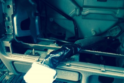

Update...
Wired gauges in and set in place on the steering column surrounds.
Fed wires through firewall and next is pluming in the boost line and egt probe

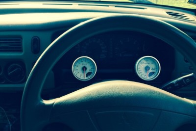

All done and working well.
I love the peak and warning light function and backlight options for night.
Easy enough job which could save big bucks in the future.
Once I've got some temps down I will play with boost and fuel.
Very pleased with end result.
