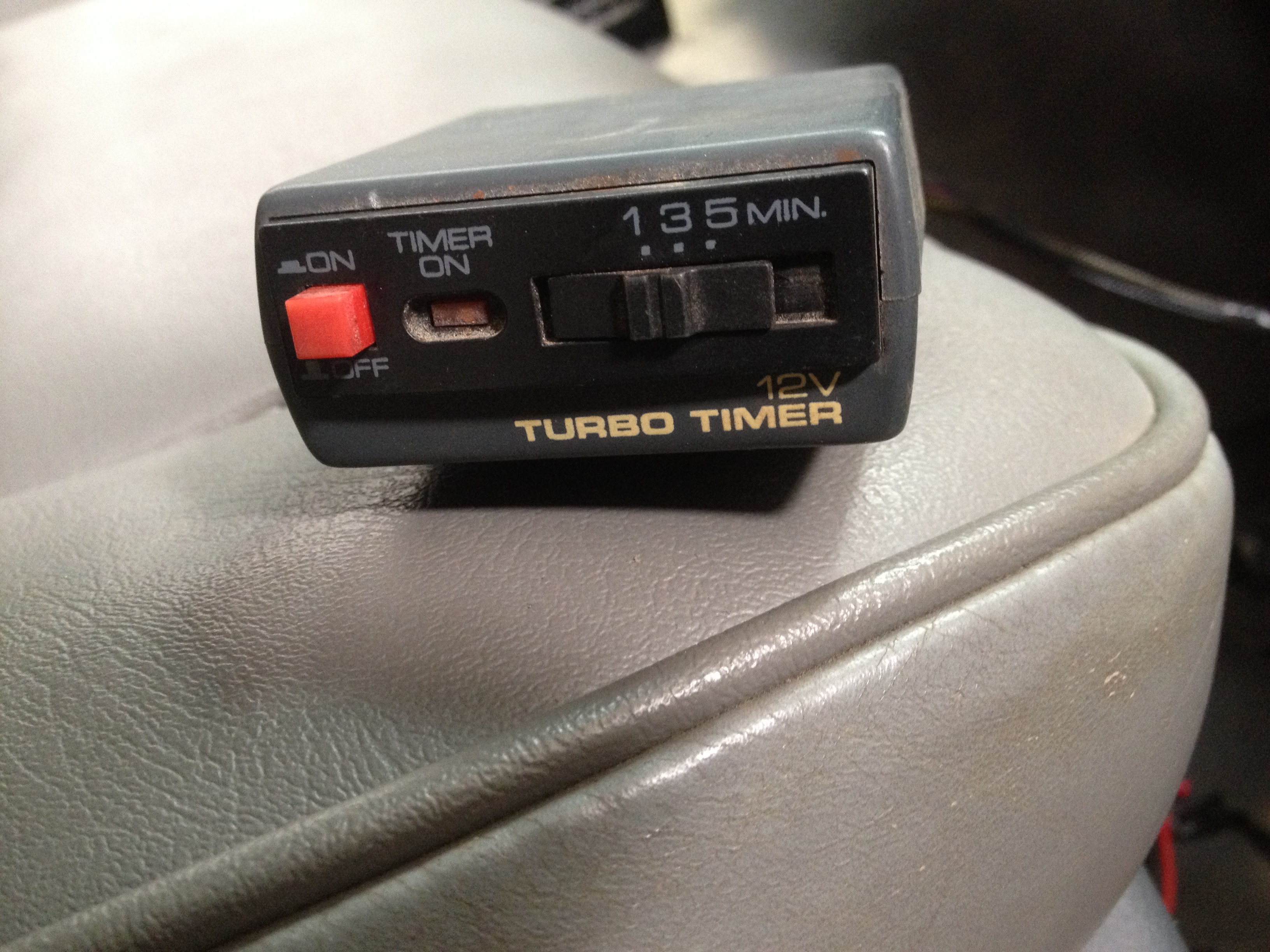

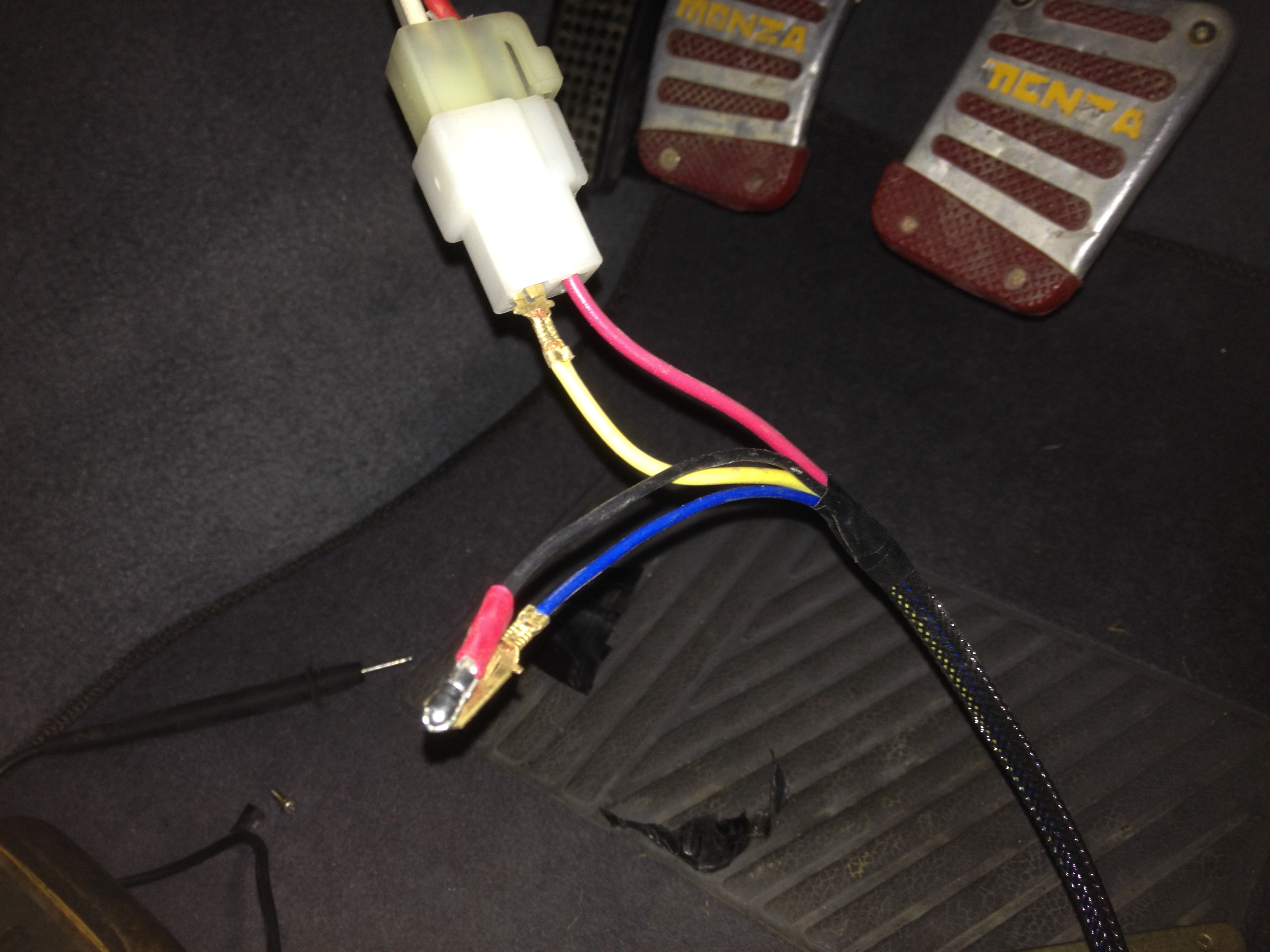

I am fitting a turbo timer on my patrol. It is a simple 12 volt analog type with four wires, red, yellow, blue and black.
Does anyone know which wire goes where? I guess the red is battery and probably yellow is acc with black being earth. whatnis blue for? And are my assumptions correct?
See photo for timer type and wire colours.

Red - Battery
Yellow - Ignition
Blue - Accessory
Black - earth
