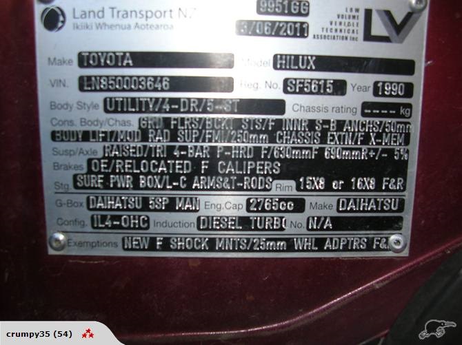

Re: Another cert question, swapping wheels
not my plate but kept the pic for future reference
The plate pic that derk has is for my Bitsalux that Craig (Craigs4wd) built up. Indeed it does have two sets of rims stated on the plate.
I did the same thing when I took my previous Hilux (WRNGLR has it now) in for a cert - Got two sets done at the same time. It was a bit of mucking around swapping wheels over and doing two lots of the brake test, but all was good in the end and well worth the extra half hour of my time.
So it is possible, just make sure it's fine with your inspector. They also keep records of the rubber size mounted onto the rims at the time in order to prevent people thinking they can just go to the next tyre size up and still be legal.
