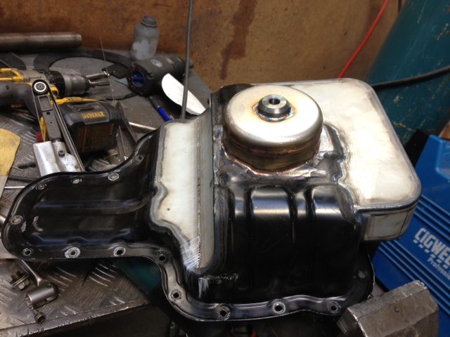

I've managed to put together a budget dry-sump. Power-steering pump (with modified relief valve) mounted in the aircon slot as scavenger running to rear-mounted 10kg fire extinguisher as oil tank. Hardest part was getting the sump right and fitting the hydraulic hose inside the sump to connect the supply pump inlet through the sump to the rear oil tank. Works well though, and cost bugger all - plus a fair bit of time... And an engine when it ran dry before going the dry-sump route....
Re: which sump to go with?

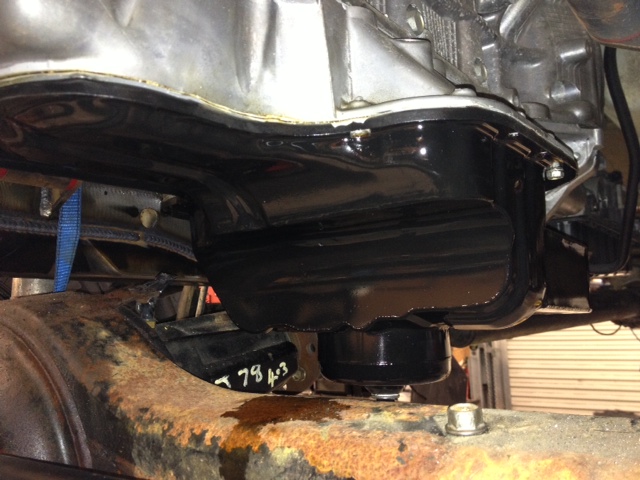

Not the greatest photo - but you can see the bottom of the sump has been trimmed and a low-ish profile box welded on - initially I hoped it would be deep enough as it was all the room I had above the front axle /diff housing, But after running a bottom end bearing, you can now see the 2 tubes welded through the side of the sump. One is for the scavenger and is located central at the bottom of the sump and runs to the inlet side of the power-steering pump (next photo), which then runs to the top of the rear mounted inverted 10kg fire extinguisher oil tank. The feed line from the oil tank runs to the other sump tube which has a flexible hydraulic hose connecting it to the oil pump inlet where I just chopped the tube about 20mm long inside the sump. That was the really tricky bit cos it's a bastard to connect up and took a lot of trial & error to get the hose the right length with no kinks, and working in a small gap to tighten the jubilee clips.

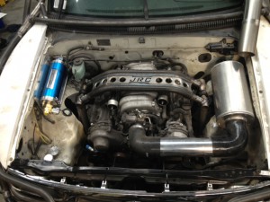

^^^^^^ So much room in that engine bay. Jealous as bro.
