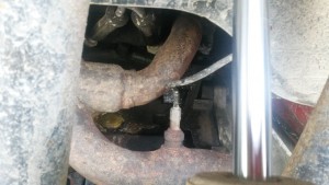

Got an o2 sensor on the exhaust? They come out with the wires for one and a bung hole in the manifold (steel manifold) but no sensor. Go figure lol
Re: vn v6 in hilux, running rich, aldl setup?
I have been told the nz vn never came with o2 sensors? Should i install one or is there a way i can trick ecu? Nah no fuel leaks, first thing i did. How do i test the injectors?

The narvara my right hand man gets around in is a vn and has an o2 sensor

Cheers guys, will get one installed and see how i go, i never had that part of exhaust on my headers when i got motor. So i take it o2 sensor does major part and makes big difference to running and fuel?

Yip my laymans understanding is that it measures how rich its running and adjusts things accordingly. Made a huge difference in the navara. Couldnt pass emissions for cert without it

My VN 3.8 car 1989 did not have an O2 sensor, it was the series I VN, think the Series II had an O2 sensor.

Ok sweet, well i have series 2 vn, so must need o2 sensor. Will explain why it is running rich then. Will report back on my findings. Cheers
