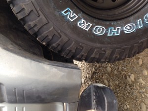

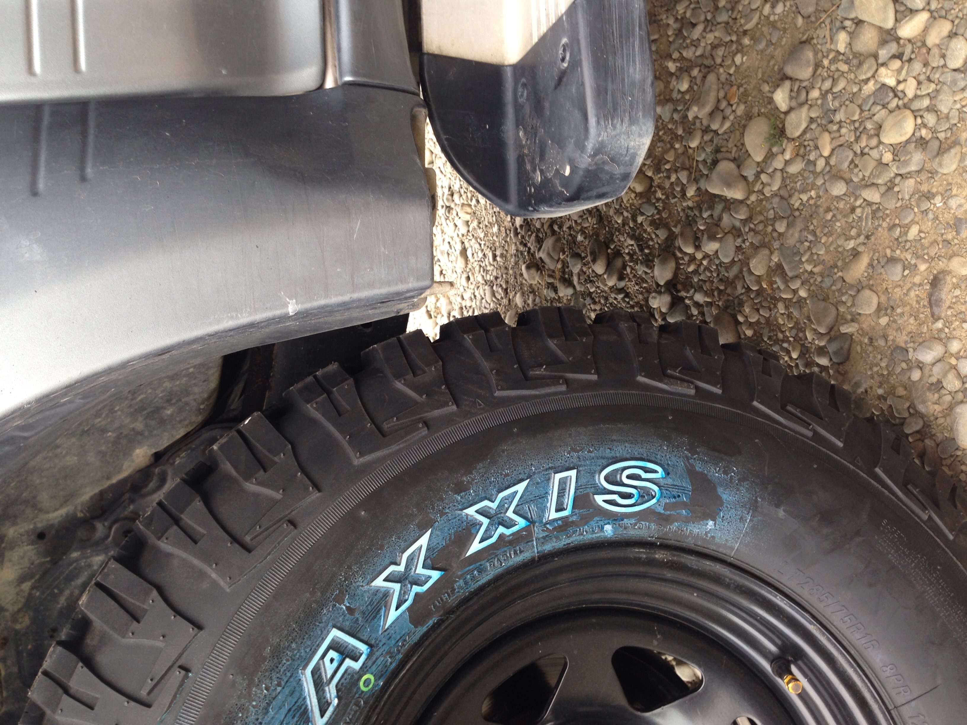

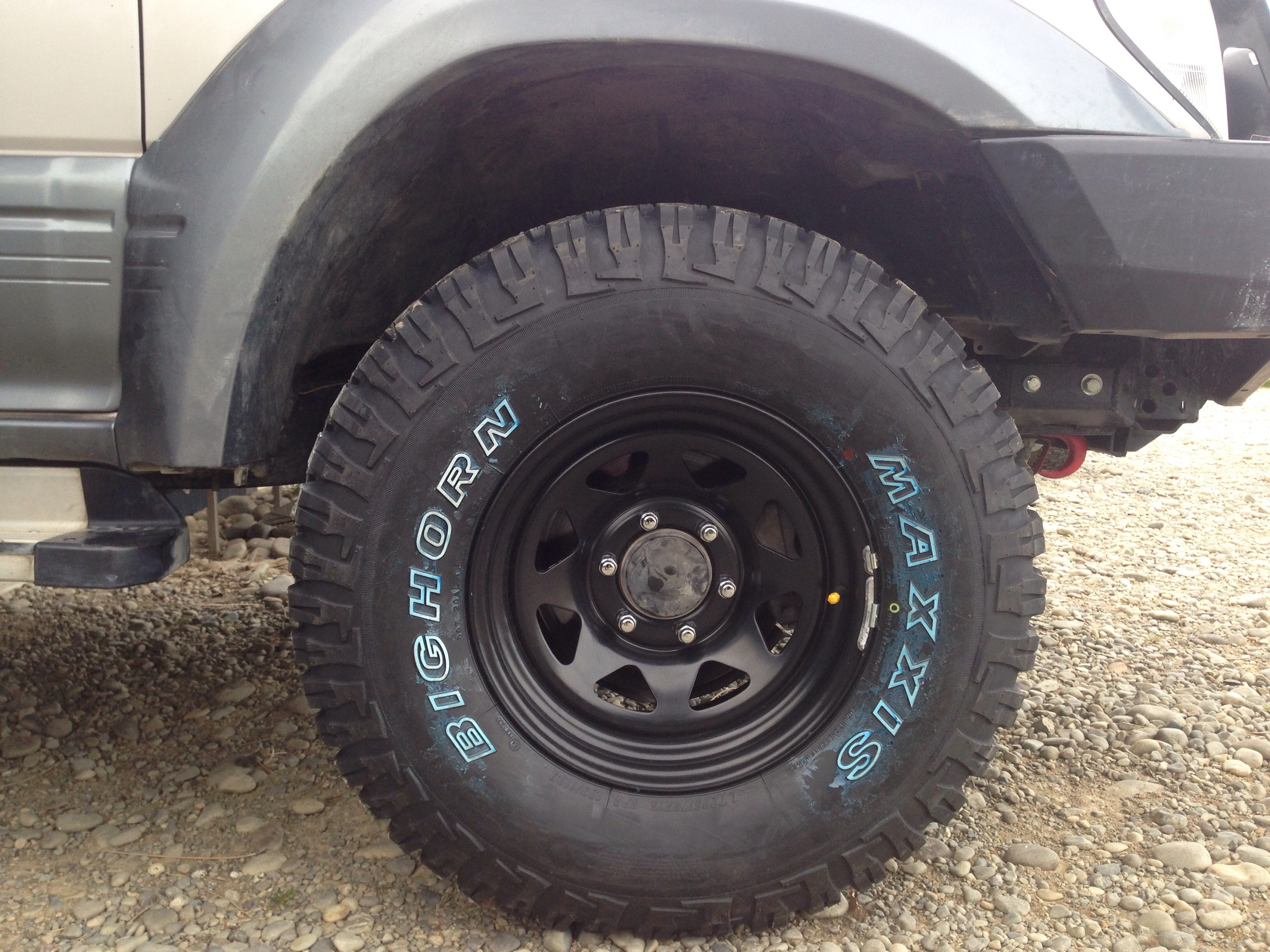

Here's a couple of pics. Front right and front left. There's about 8 mm of gap between the tyre and the inner plastic trim once the mudguards are off. I'm wondering whether to trim this back.
Any advice very welcome ...
