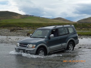

I am in the process of joining up with a Christchurch 4x4wd club. The requirements for the club are front and rear recovery hooks.
Shouldn't be a problem I thought - I was wrong. The guys at the club are also a bit stumped.
Placing recovery hooks on a new generation Pajero (2000) seems to be an issue.
Is there anyone out there that can assist or advice my predicament.
Truck = Mitsi Pajero Exceed GDI GLS LWB
My Pajero Exceed LWB 2000
