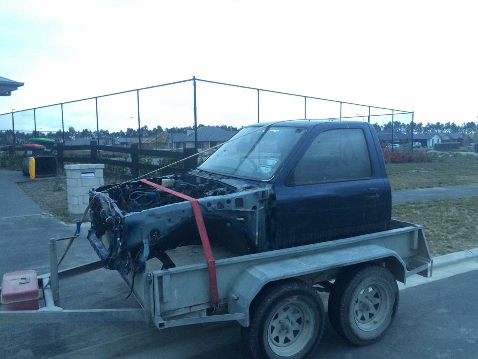

Re: Pradlux

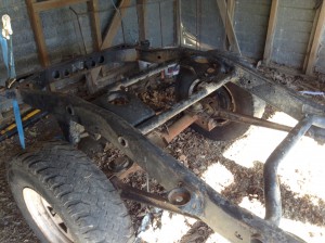

So picked up chassie gave it a good bath, boys at lineside want me to keep them posted on how i go
Turns out ita a bundy cab so need to do research on suspension parts, its pretty clean

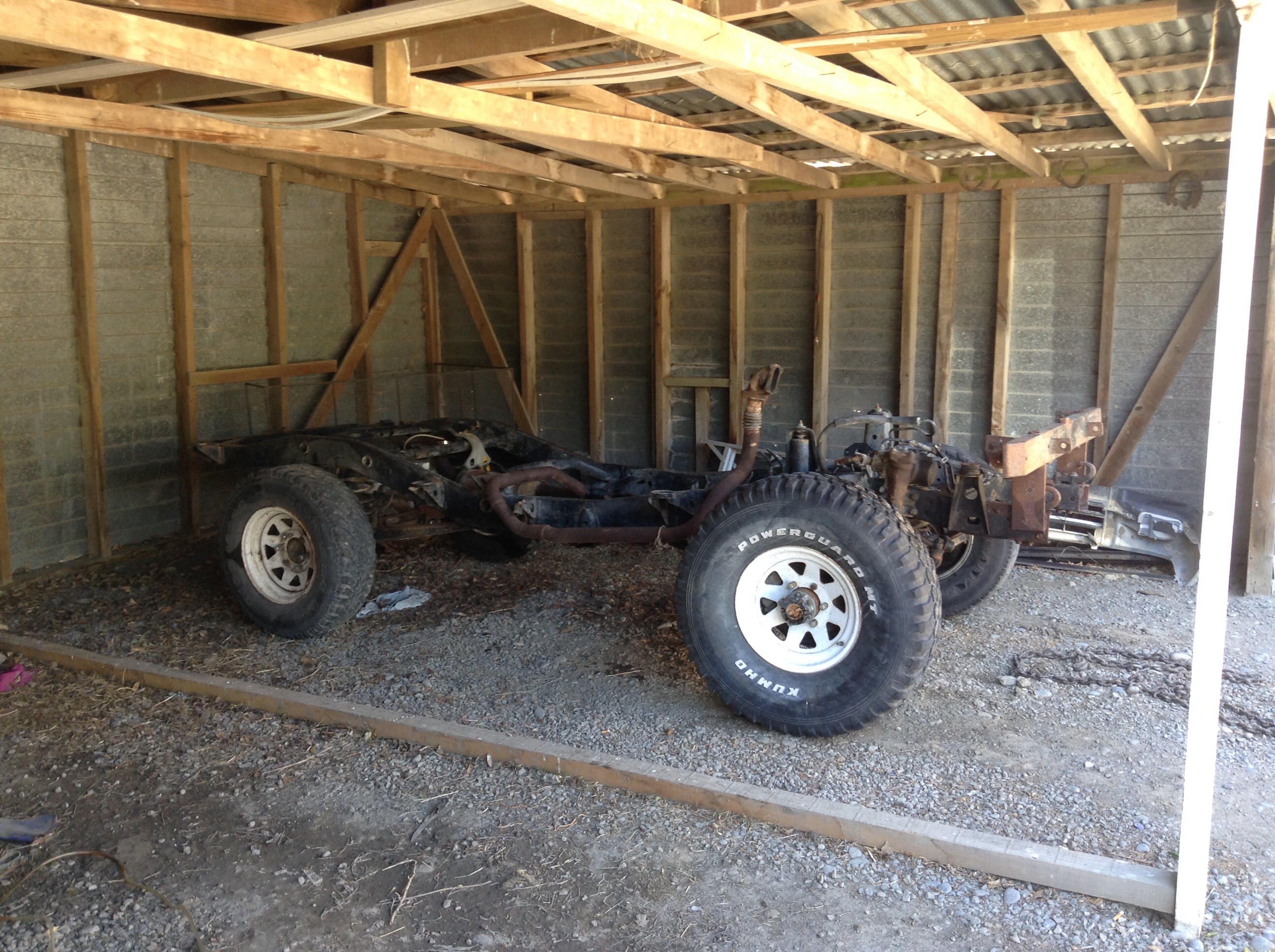

Next weekend il strip chassie back and hopefully get diffs out from under it to start rebuilding them

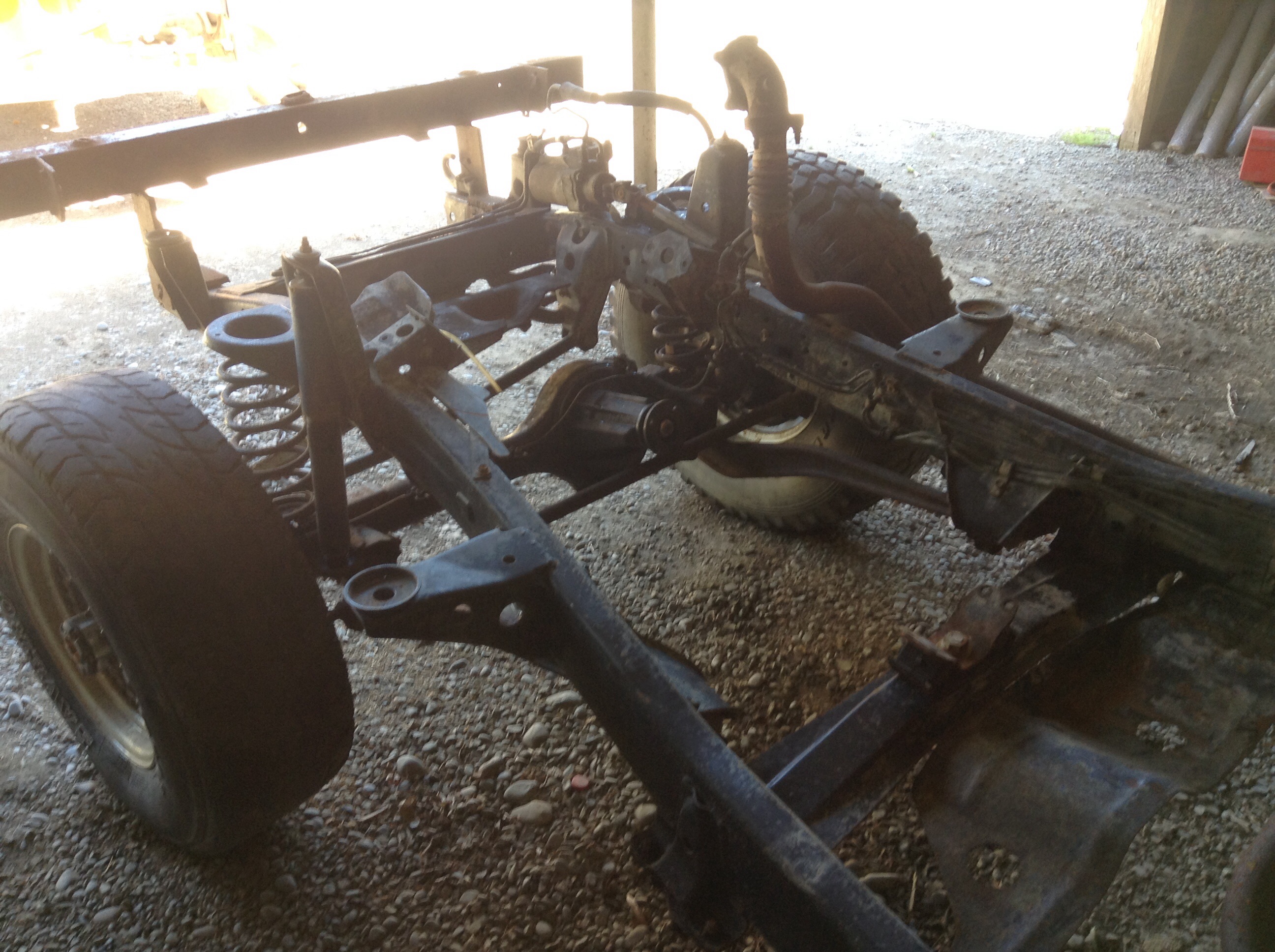

Re: Pradlux
Little bit of work tonight, just steering box to come off and un bolt radius arms and it will be a striped chassie
Re: Pradlux
Yup Bundy chassis, have one shock in front one behind rear diff. Not trying to be picky but your original post says you picked up Mwb chassis, there just swb. Be cool to extend it tho while its all apart! Cool build.

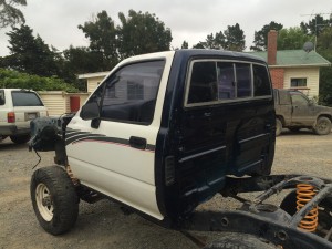

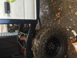

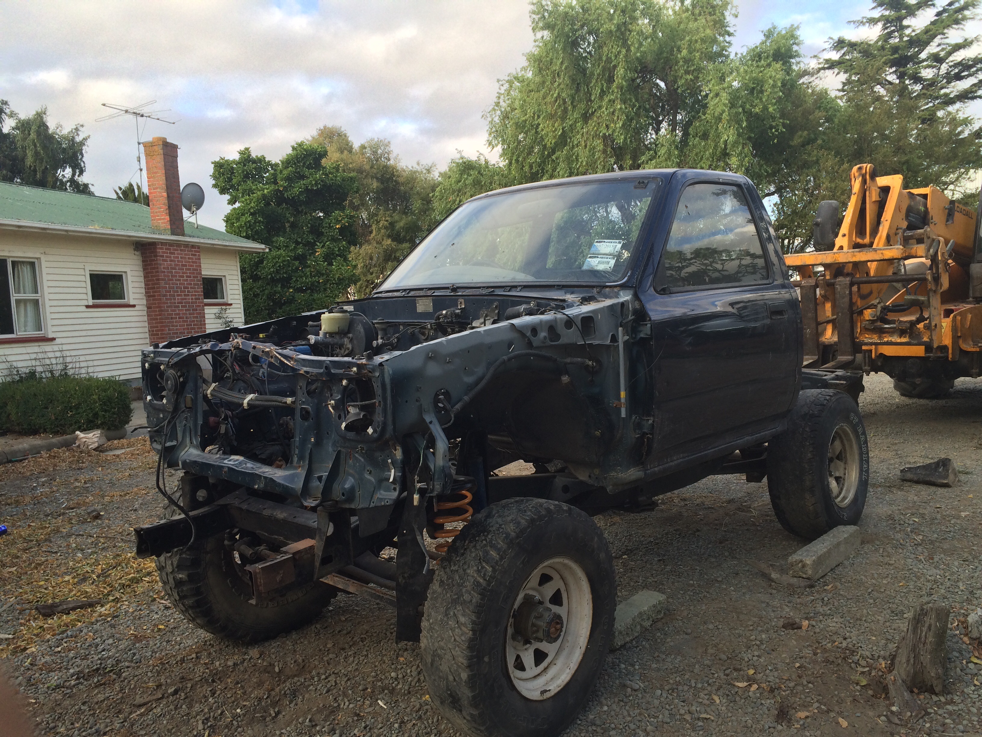

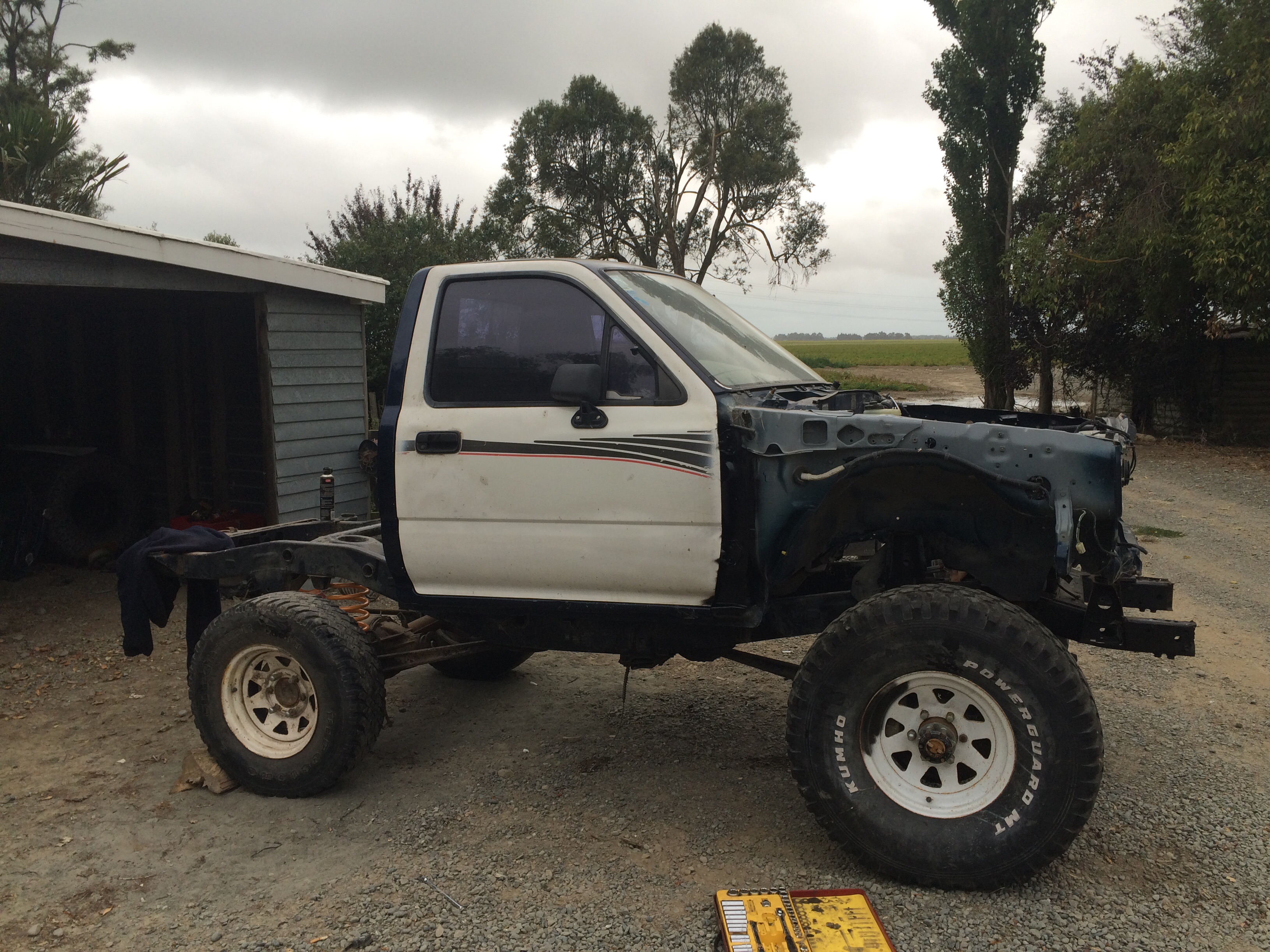

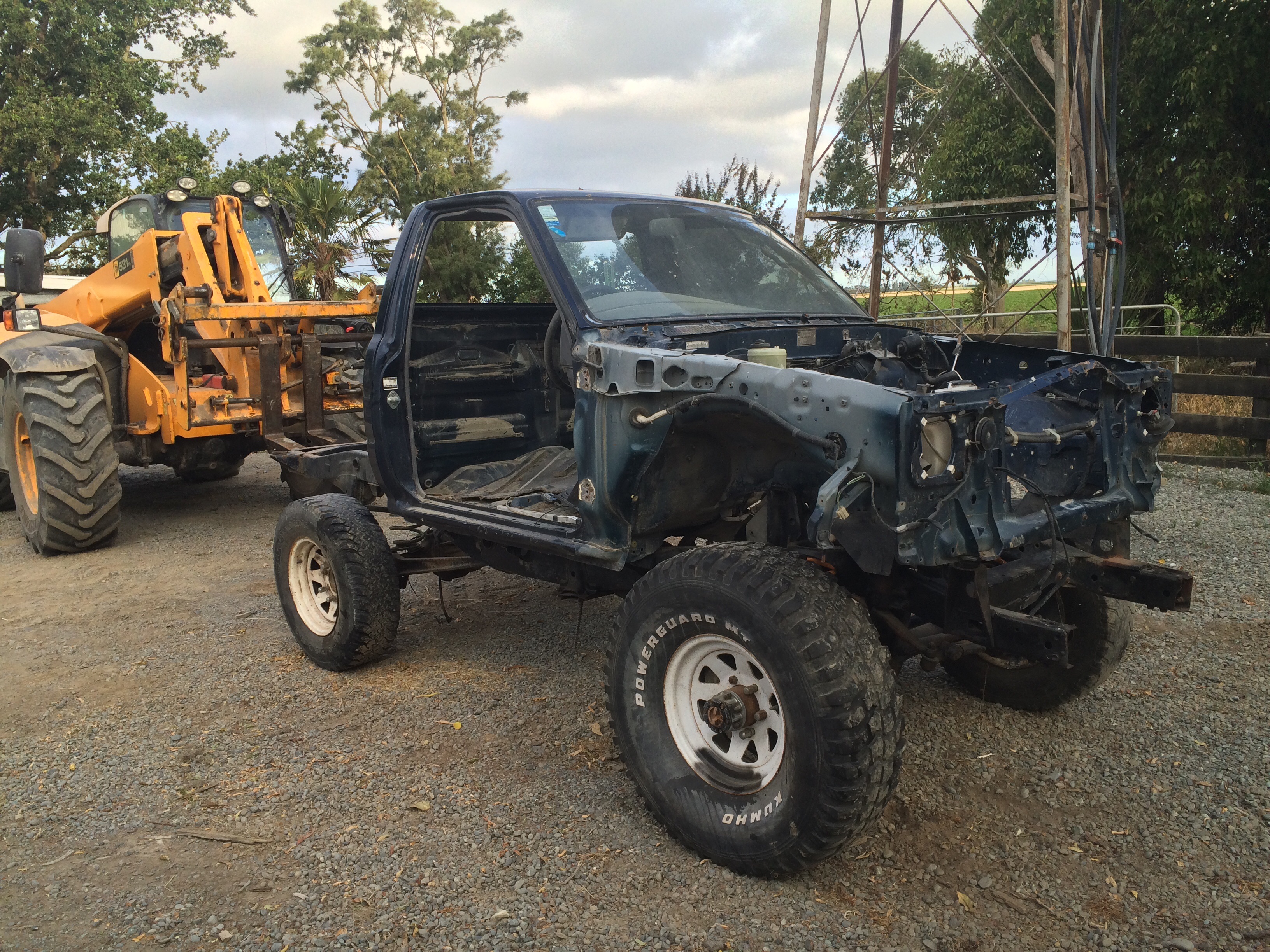

Re: Landlux... Cab now sitting in position
Cab sitting on.. Looks like 4 mounts will bolt straight up.... Fingers crossed
Drivers side front wheel is 35.. Passangers is 31... It has 2inch apring lift happy with cab height how it sits now
Re: Pradlux
Looks like its gonna be a pretty cool rig man, whats the clearance like with the 35 on the rear? Looks like it'll be pretty close to the body or is it just the angle of the pic?
- KIWI_TERRANO
- Posts: 1138
- Location: Kirwee
Re: Pradlux
Havent got 35 all round yet (only came on one) but yes rear is close but getting different rear diff and going back a foot too sp it will match a surf wheel base

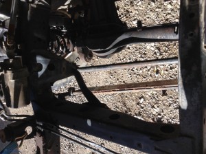

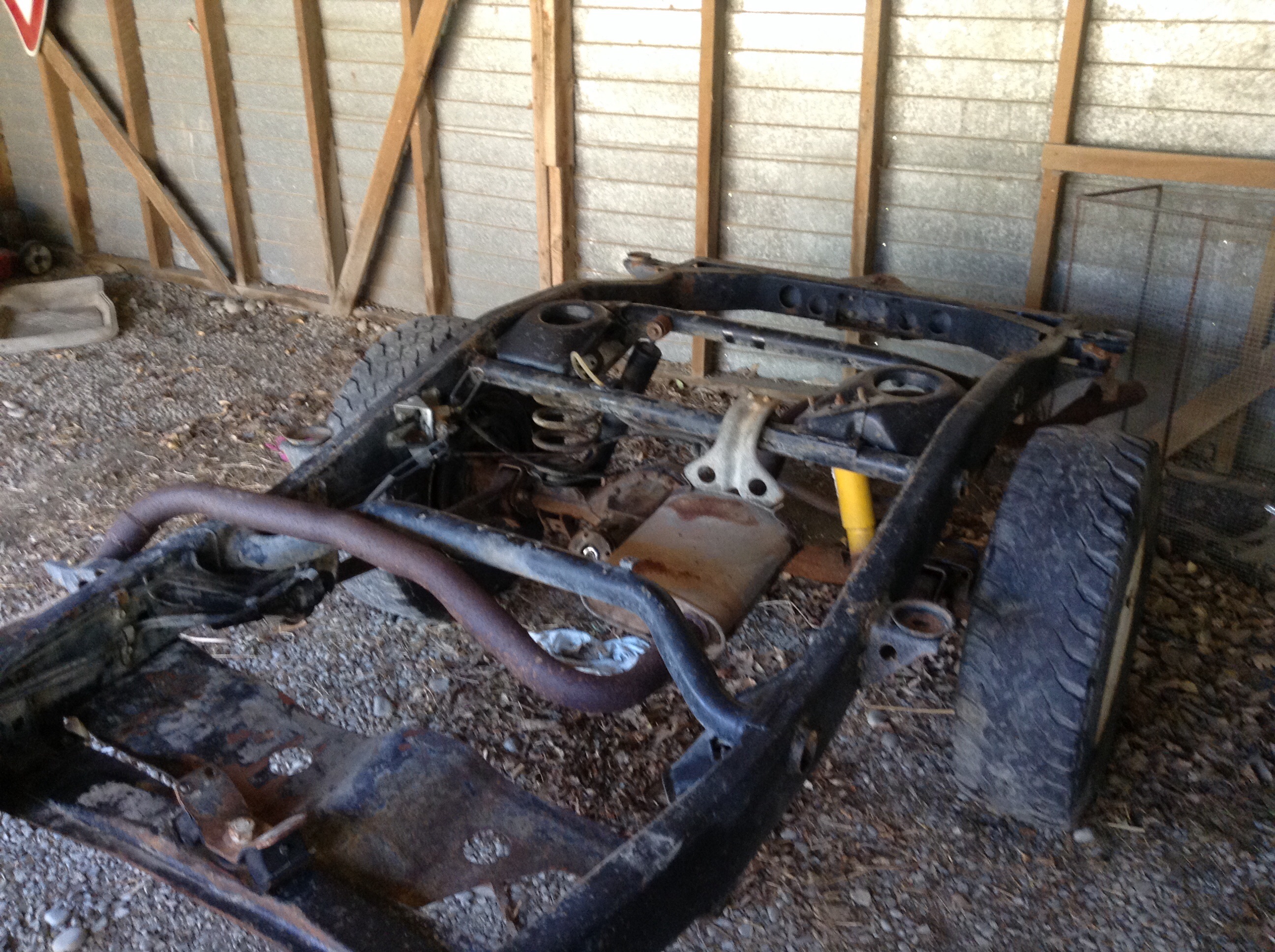

That was plan clint, makes it easier to get diff rear a foot to...
Attached photo of before the cab i brought was drowned as well

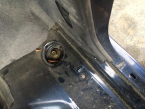

Anything but....
Hosed it out and pulled some of dash out, must have got half a ton of sand out easy... Aircon box is ful to brim to... Cant see anyrust so hopefully fish pil in sills will prevent any to

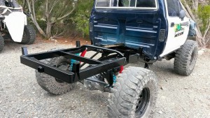

So wee update
Rims turned up off 4wdbits, got tyres on and then fitted...
Picked up some mint 130 flared front guards and grill lights ready for surf front....
So now looks like....

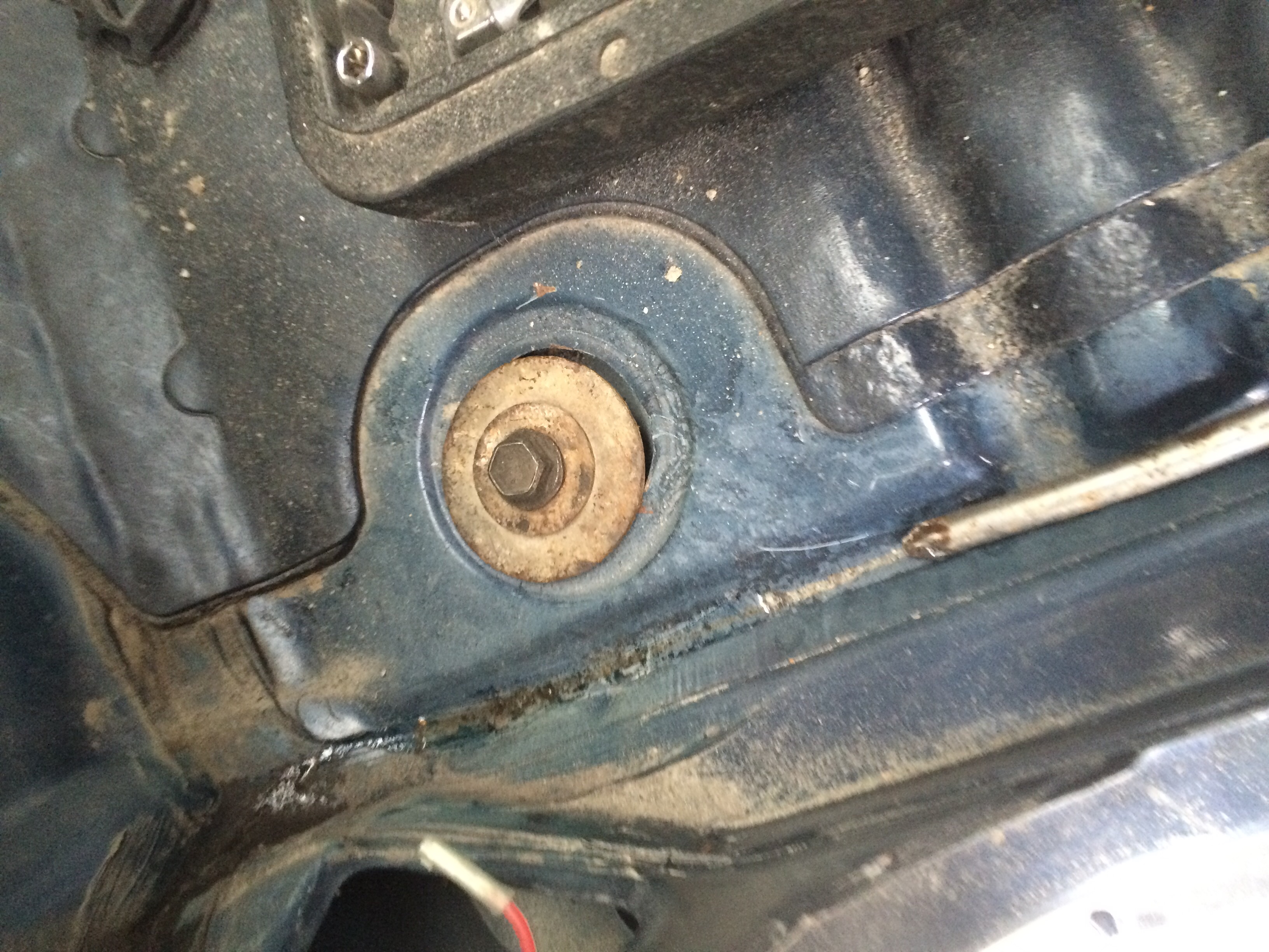

So last night i managed to drag it over to work shop cause we had a early knock off due to this nice rain we got..

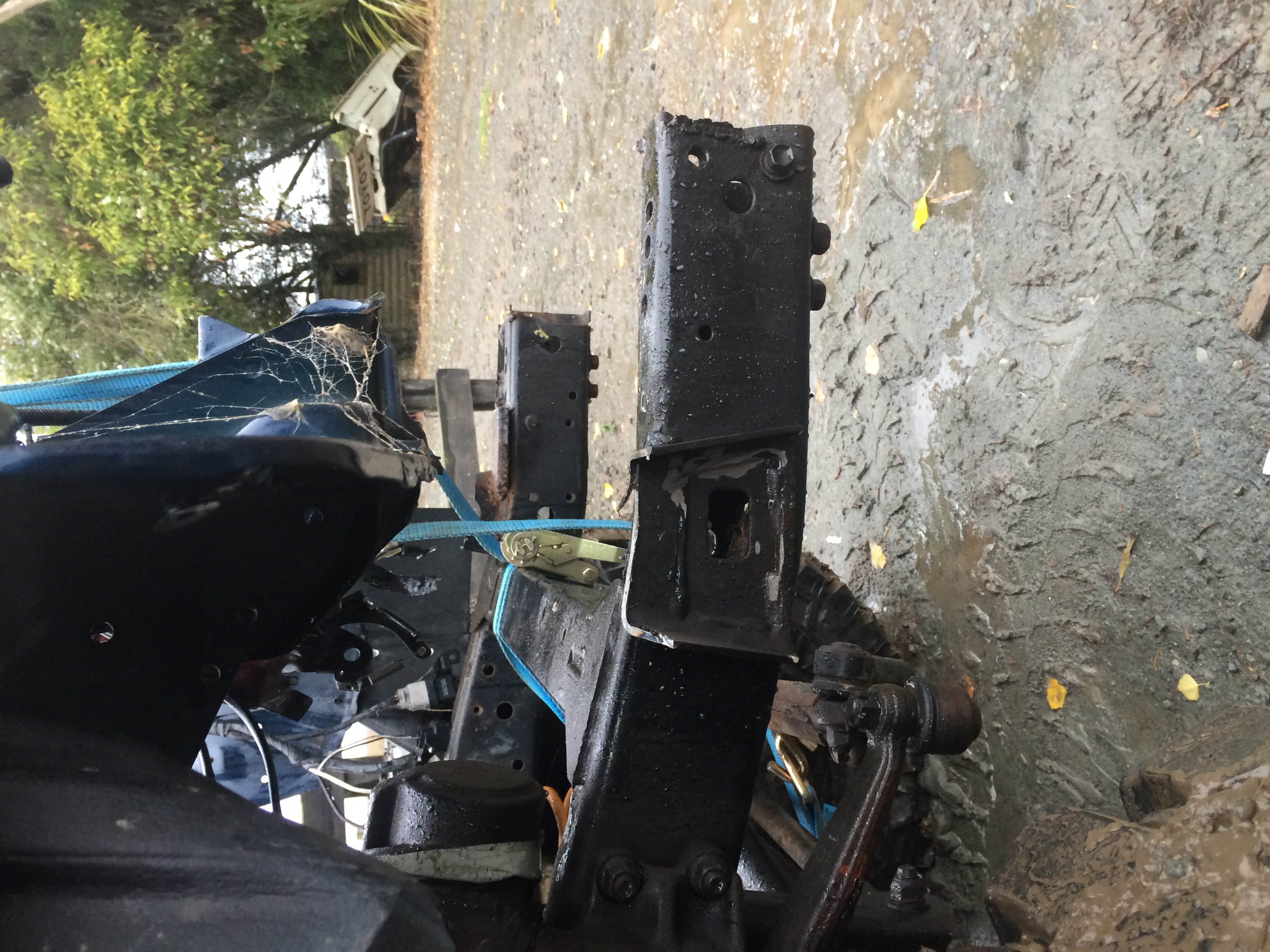

I manage to do some grinding and now have factory hilux rubber body mounts fitted.. All 4 mounts inside cab are going to work out perfect had to cut front 2 at grill off chassie as they are to far back... Now just to get some longer bolts and nuts and cab will be bolted down
Off to toms at easter to get rear diff sorted

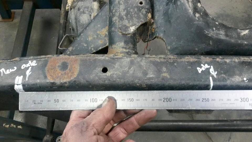

- KIWI_TERRANO
- Posts: 1138
- Location: Kirwee

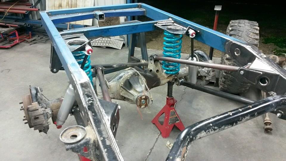

Re: Pradlux

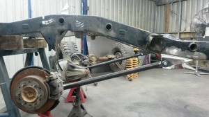

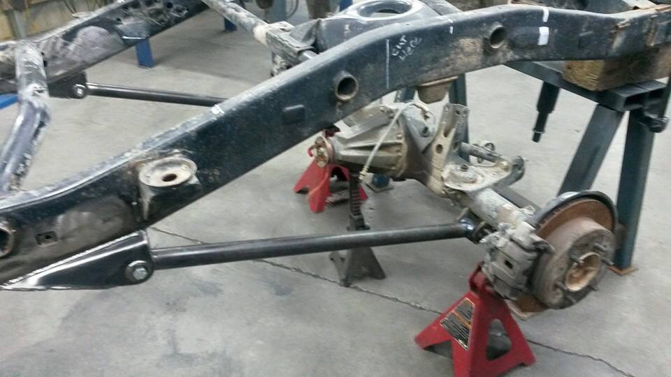

Well the truck is now in the capable hands of tom @tomsoffroad to get rear diff swapt in for later model, heavier rear cross member and hopefully a motor and box fitted once sourced
Slowly achieving success with the old girl

Re: Pradlux
Looks good. Are you going to have a std-ish 4 link + panhard setup or ditch the panhard & go for triangulated top links?
Clint
Clint

Re: Pradlux
Standardish 4 link Clint.

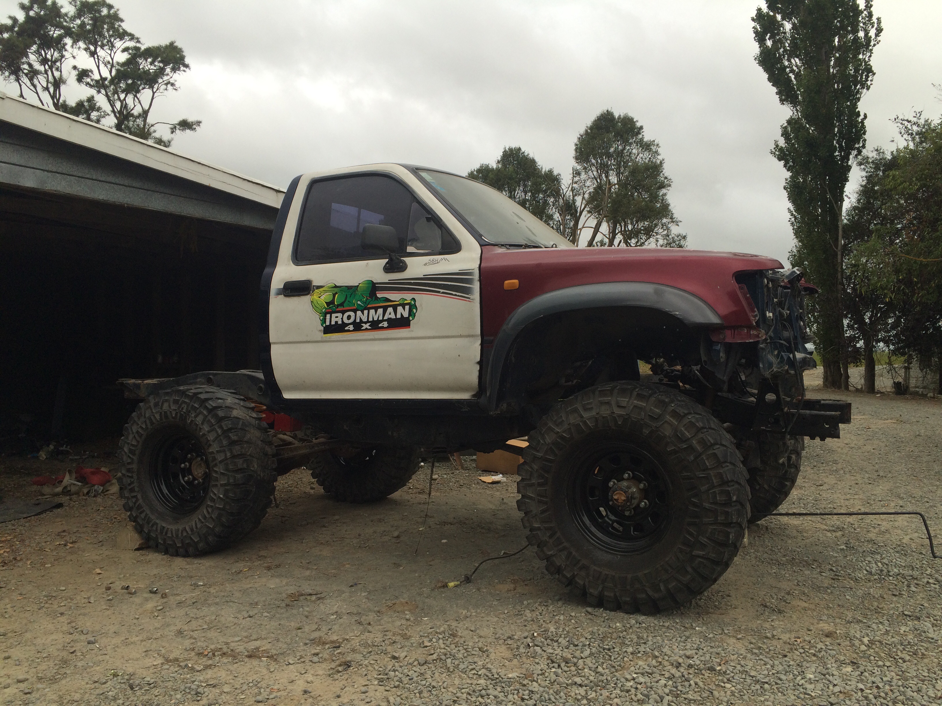

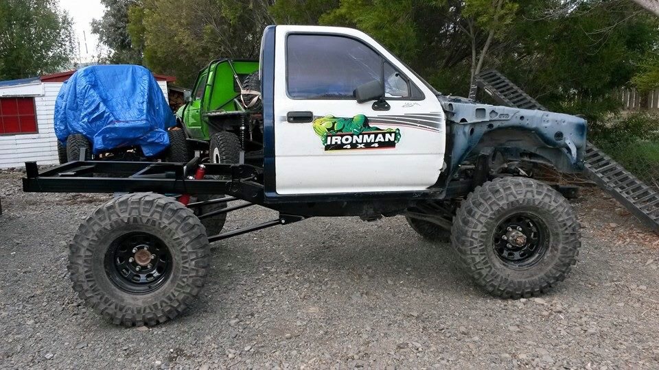

- Location: Kirwee

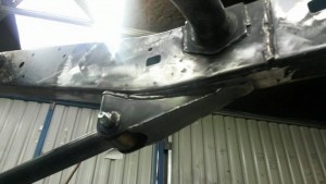

Re: Landlux
So i let tom get a wee bit carried away with grinder... But im happy with the out come now not only is wheel base a match to surf but also chassie is longer giving me more room to fit things in chassie rails
