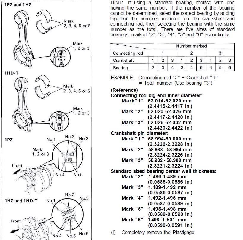

I think I've found what I was looking for. The below information mentions to match the bearing numbers against the crank shaft and connecting rod numbers.
Do the bearing kits all have numbered bearings?
