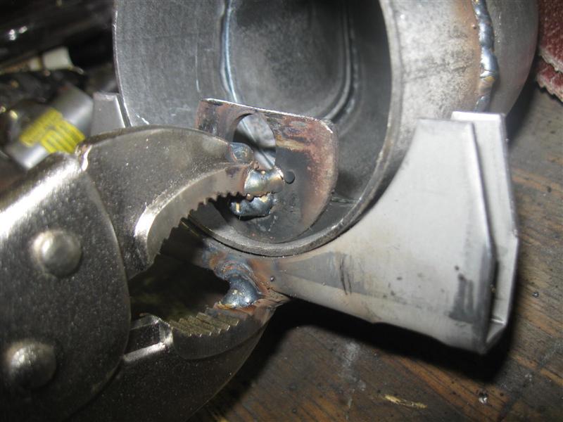

i was round at a mates place he had his arc welder out attacking a zuki sj, so i made tool in pic no 2, very impressed with ther outcome! way neater than i expected and my pipes stayed on! just got other problems to fix now, like over heating and low oil pressure sender, it never stops.

Shit, that looks easier than laying a bead round alloy pipes,and tidier...might need to make me one of them
