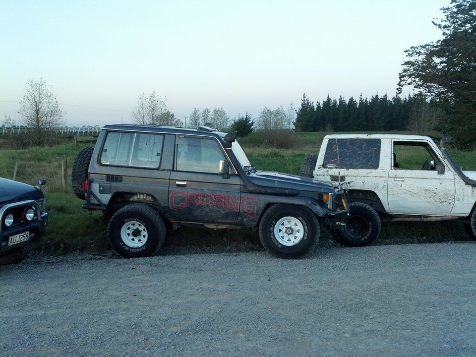

Before on 31's
Before on 31's
Before on 31's
Before on 31's

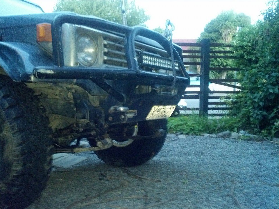

Front bar 35's and some dent's

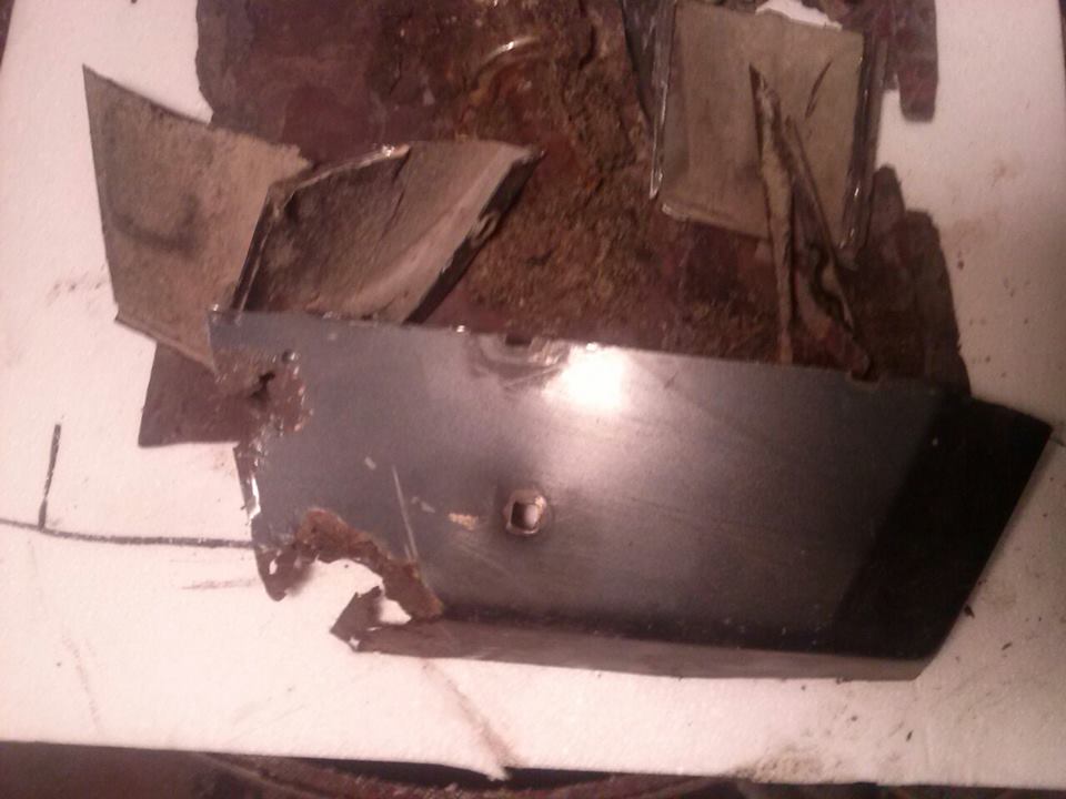

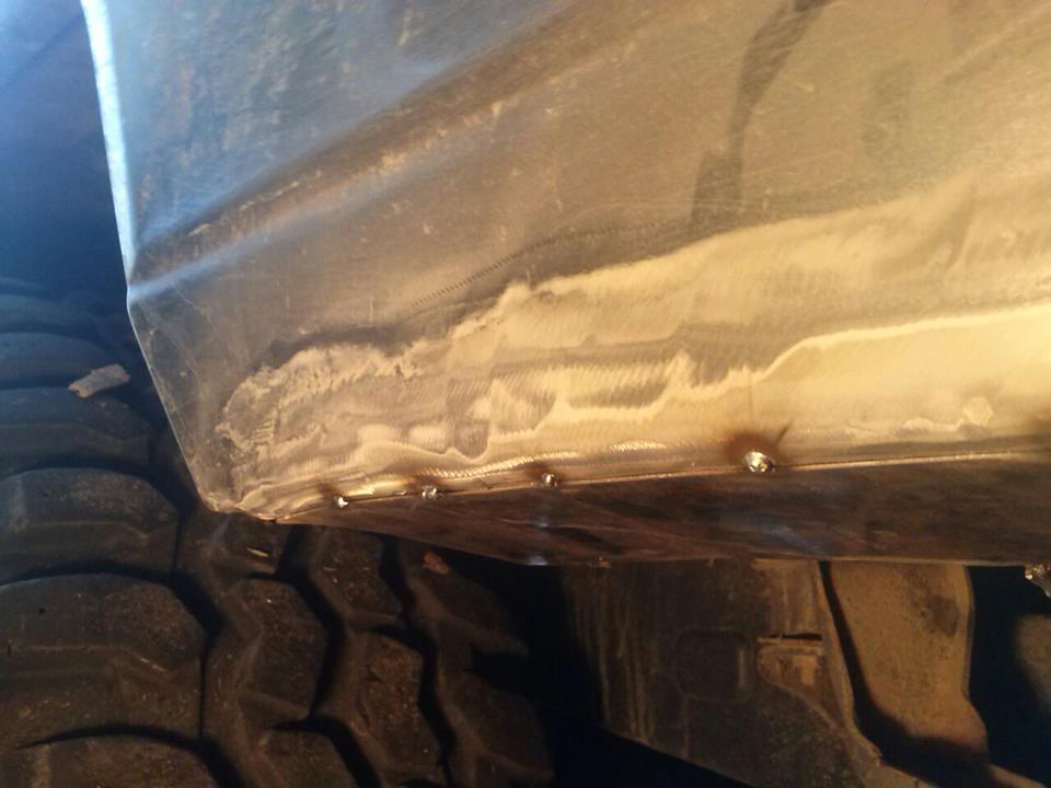

Found some rust on the floor

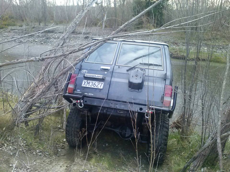

Fell off here
Fell off here

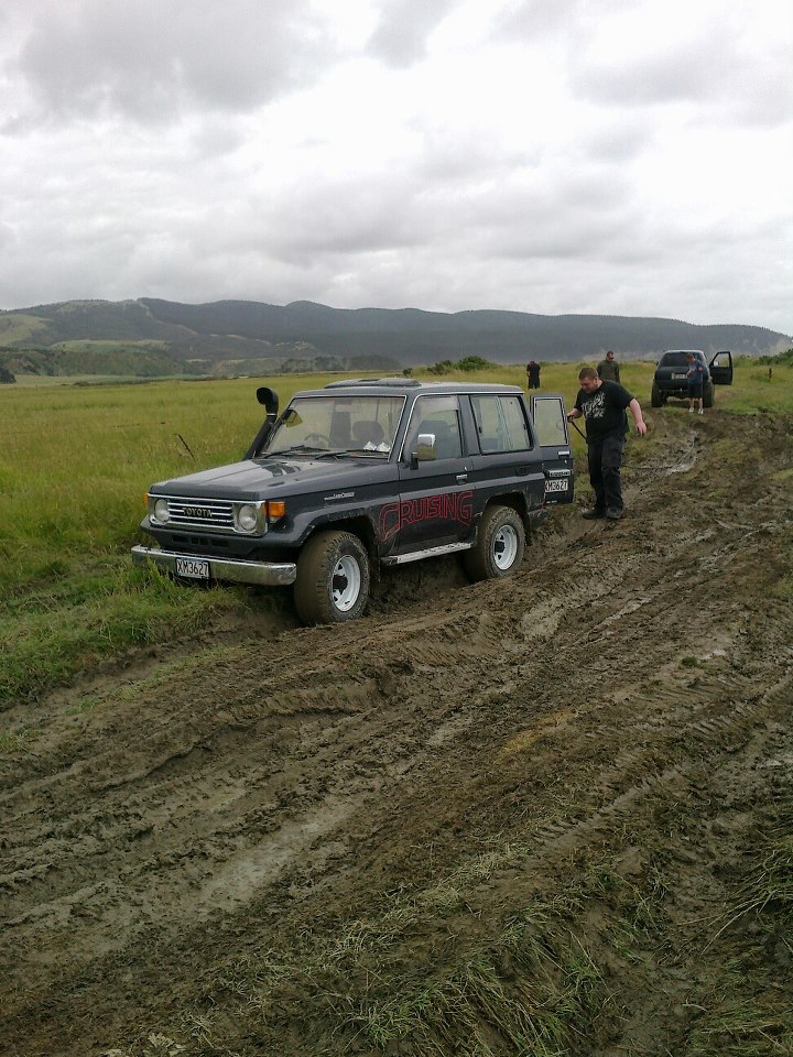

Done some more 4wding

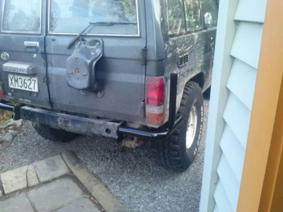

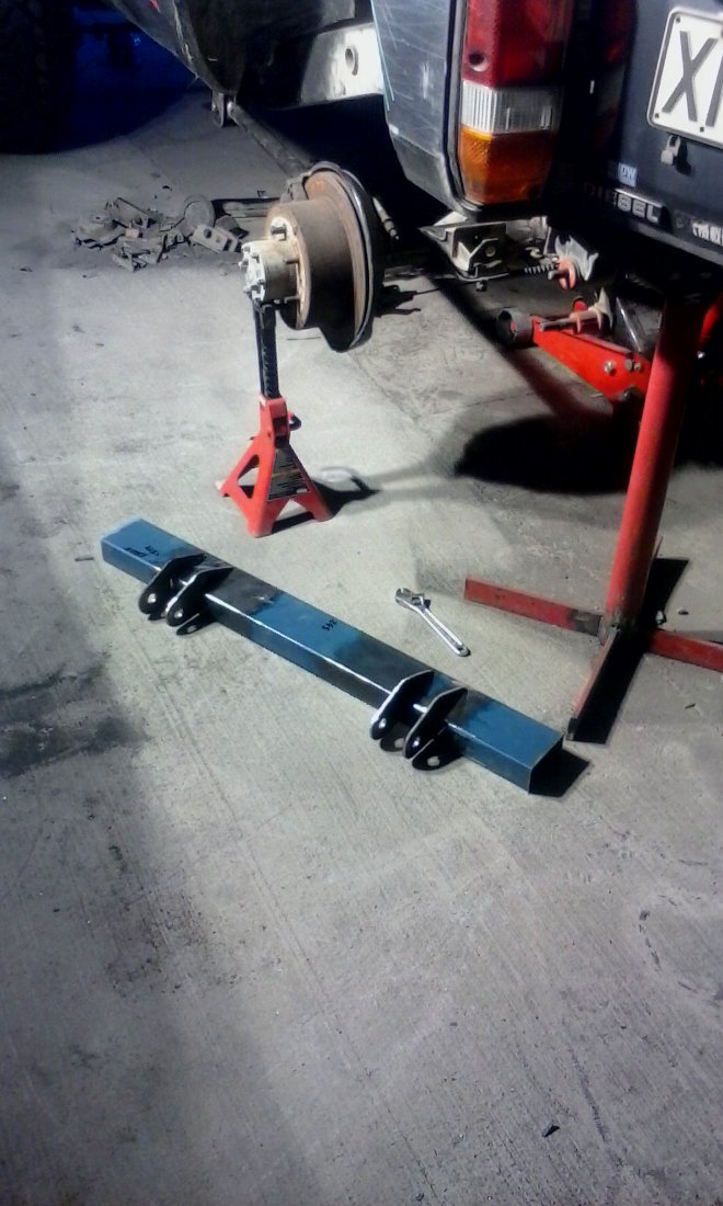

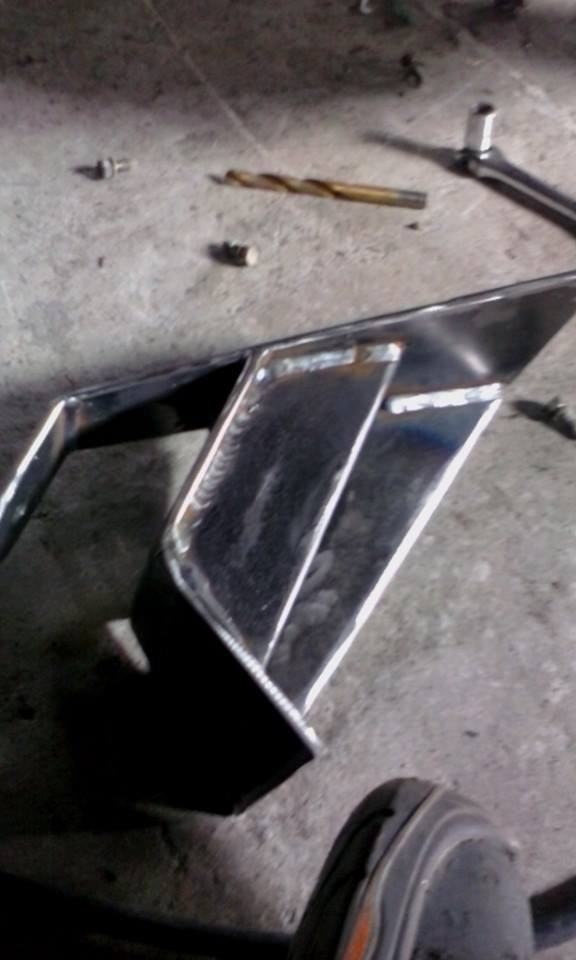

Made some corner bars

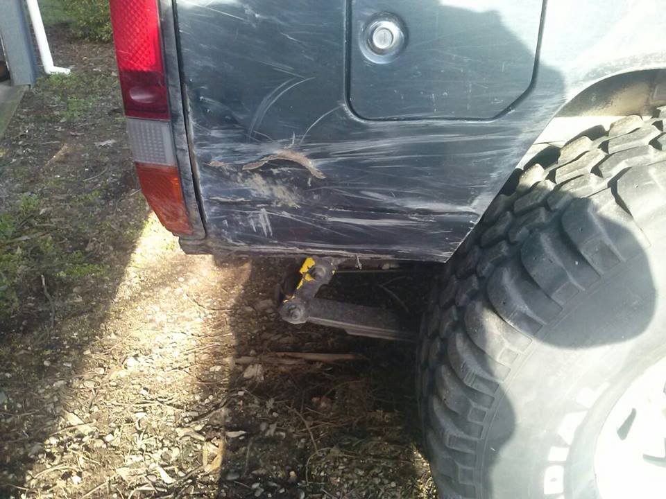

please tell me those corner bars fold right around and bolt back onto the chassi behind the rear wheel...or the next bank you find , kiss your tail lights good bye...or just llose the upright piece, that's just going to be a lever to rip the rest off......just sayin. :mrgreen:

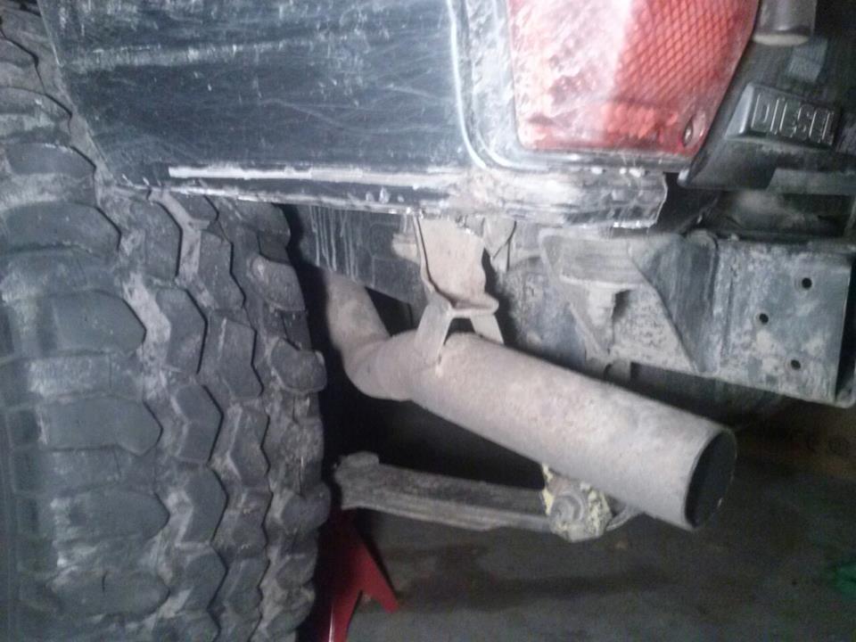

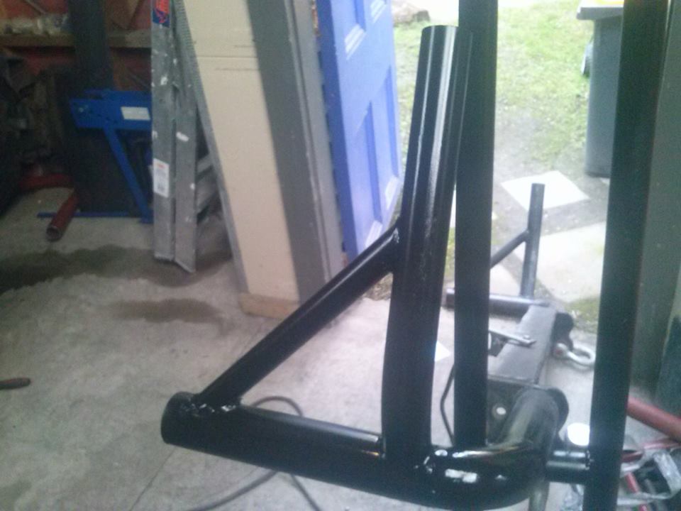

Made corner bars one piece added a brace,

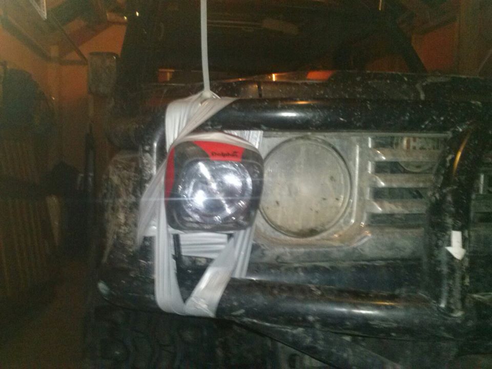

Something tell's me hot bulbs don't like cold water midnight drive home with my high output headlight ;)

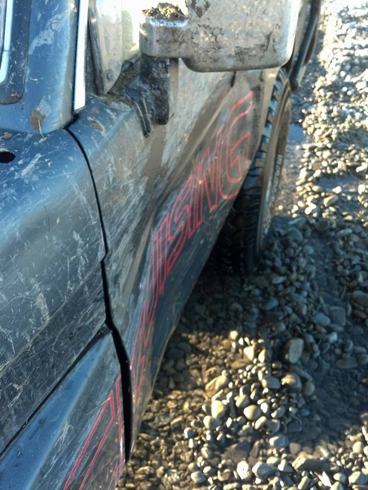

Safari axles &gt;.&gt;
Safari axles >.>
Poor Door :(
Poor Door :(
Factory Cruiser flex on 35's (out flexed by a terrano Jamesoldboy show off)

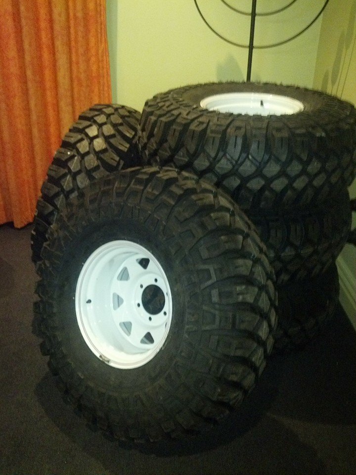

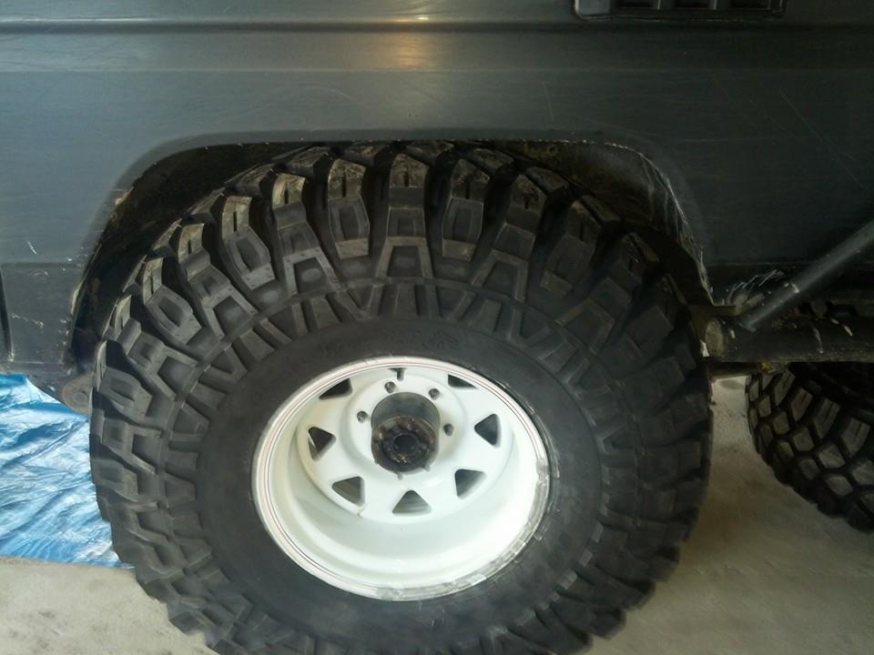

Got some 37's
Got some 37's
factory height 37's? yeah nah.....

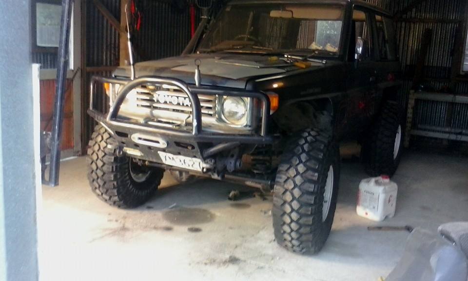

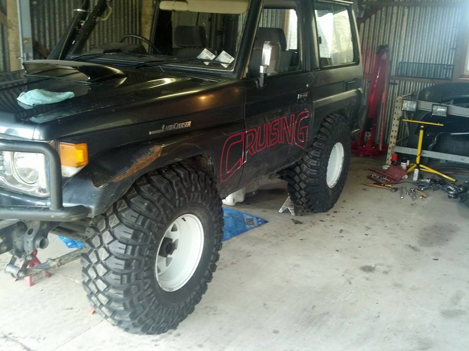

Of Course 37's fit with no lift ;)

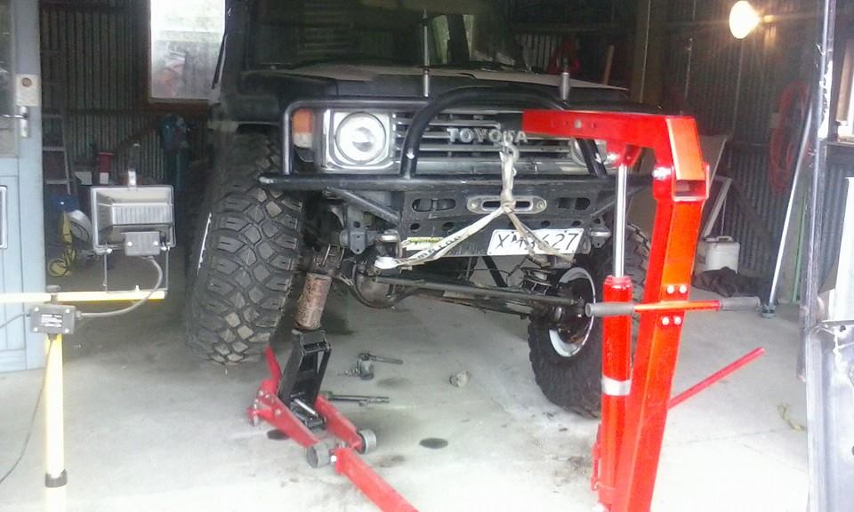

Hmm whats going on here

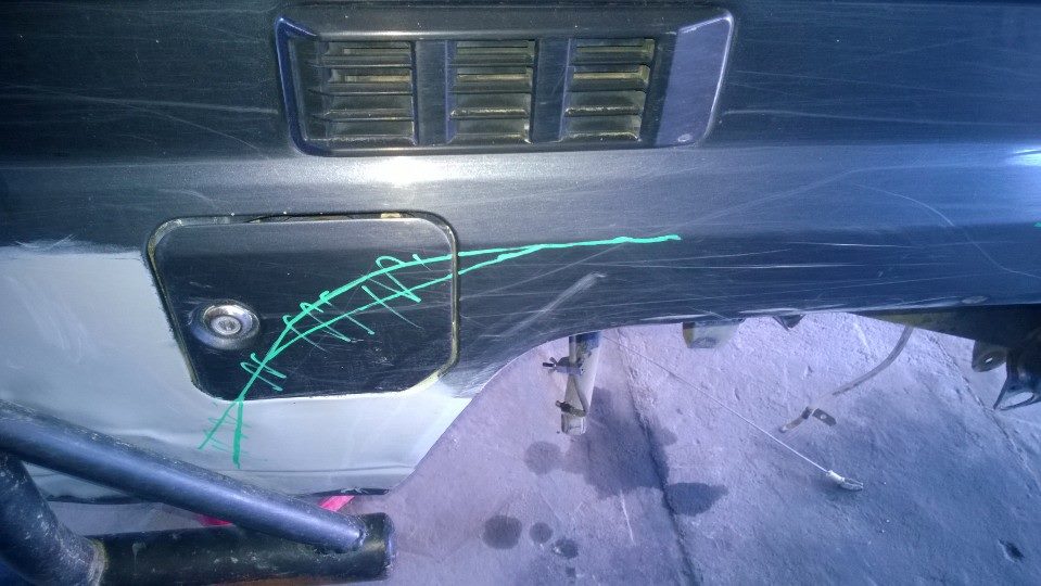

Gaurd chop? filler might be in the way....
Guess the filler has to go...... haha

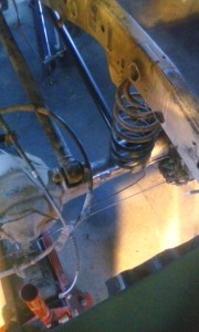

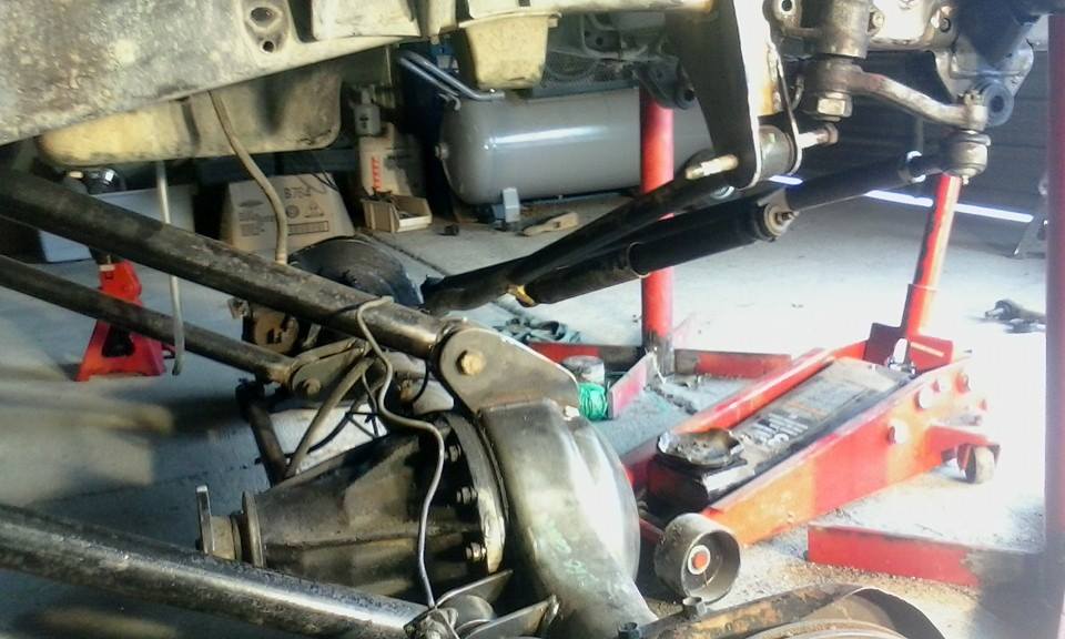

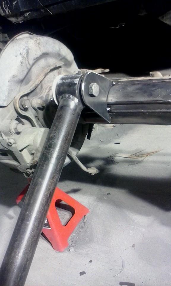

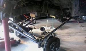

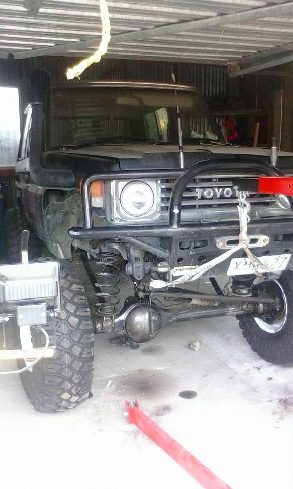

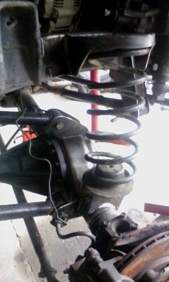

mocking up rear 4 link.
Cycling rear 4 link
Cycling rear 4 link
Quick flick with the grinder and the mounts fell off :O
made some more mounting objects with the hot glue gun and some metal coloured cardboard plenty strong enough for my 3 Link

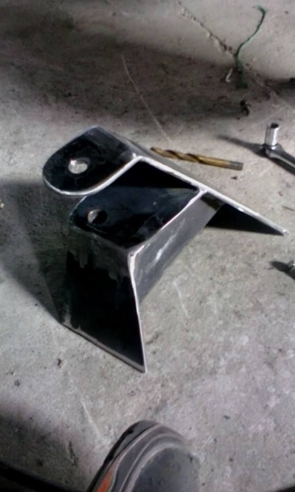

Upper Chassis mount this is a very very very tight for space.

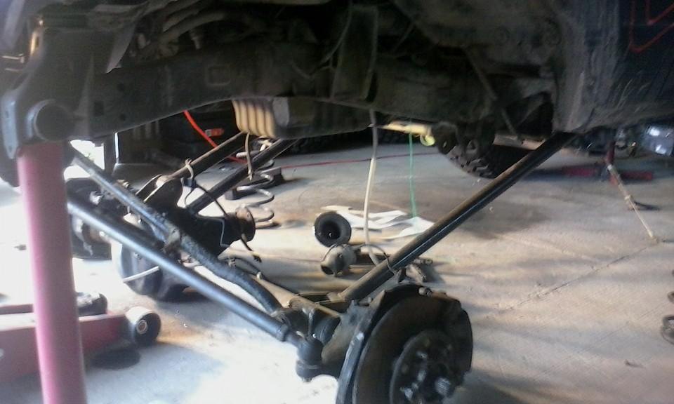

another angle of the madness....
Seems to cycle up all right
nothing really binds Happy so far....
Picture's
Picture's

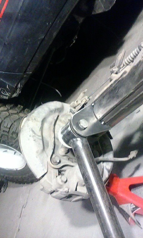

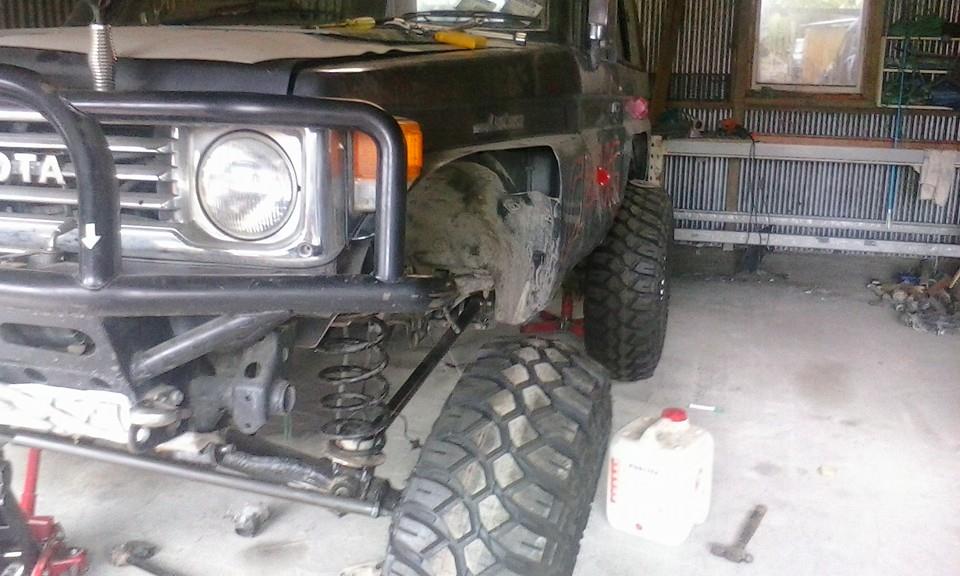

add Steering box/Drag link and Panhard.

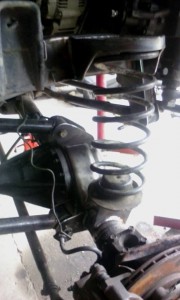

Bounce holder devices
Some rubber doughnuts

Crash bandicoot wrote:please tell me those corner bars fold right around and bolt back onto the chassi behind the rear wheel...or the next bank you find , kiss your tail lights good bye...or just llose the upright piece, that's just going to be a lever to rip the rest off......just sayin. :mrgreen:
It didnt stay like that long, it protected my existing dents and scratches well :mrgreen:

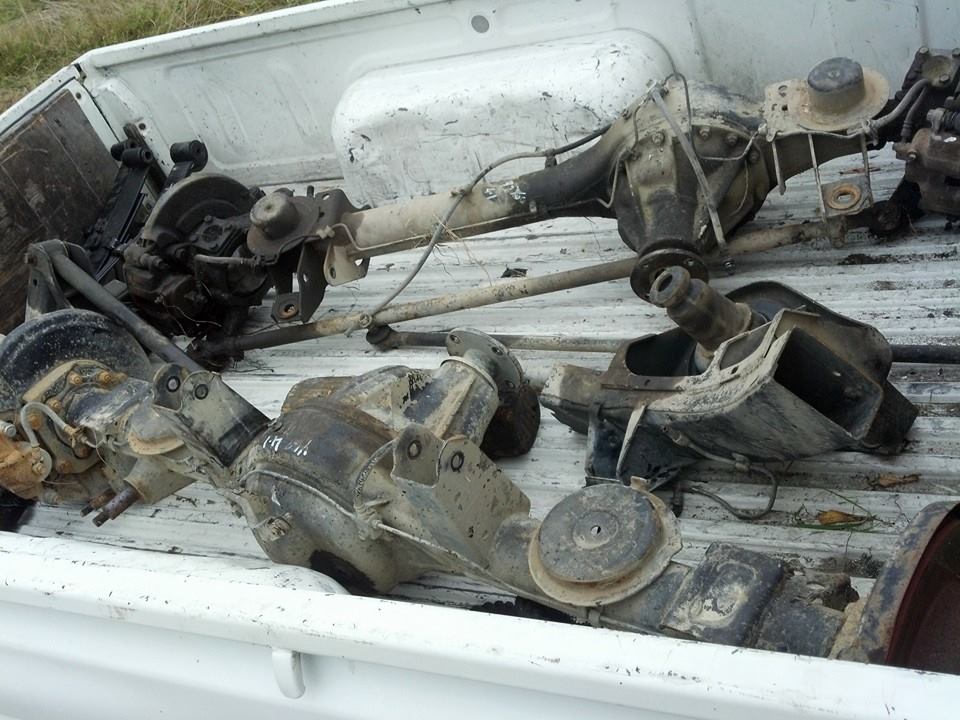

It's going slightly more Toyota again safari rear is coming out 80 series going in dual front safari diff's with hydro rear crossed my mind briefly so did trying to find unimog axles ;)

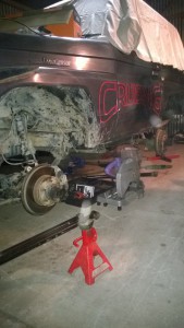

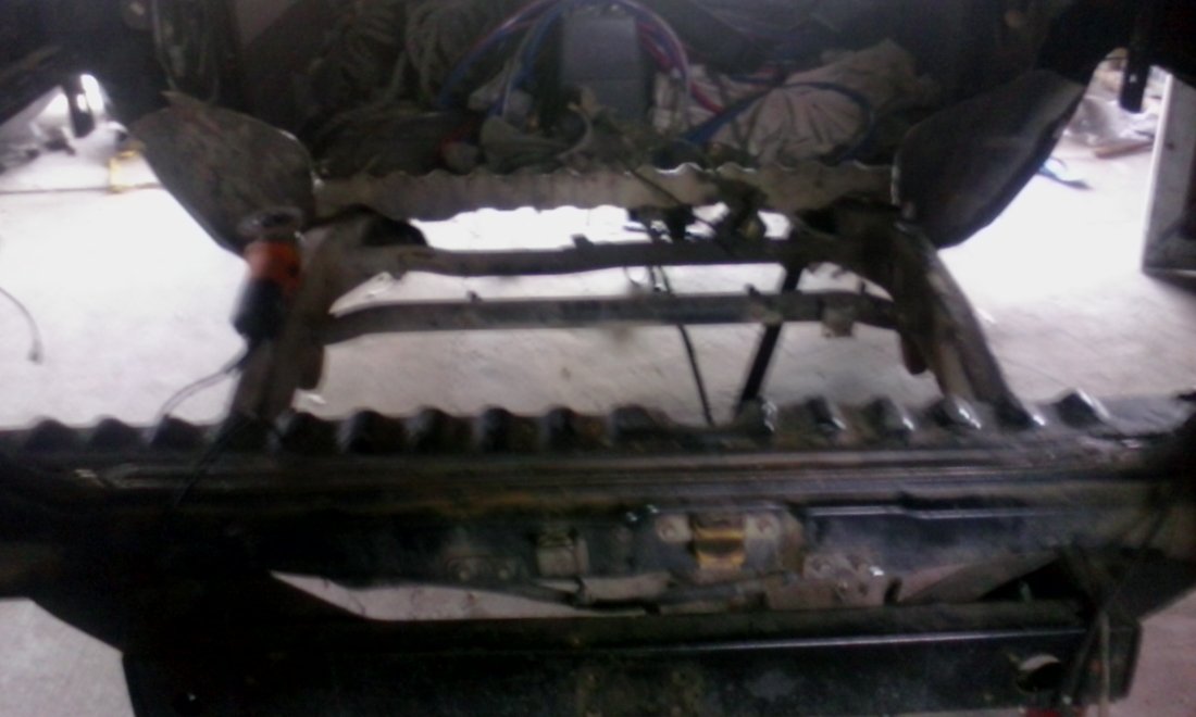

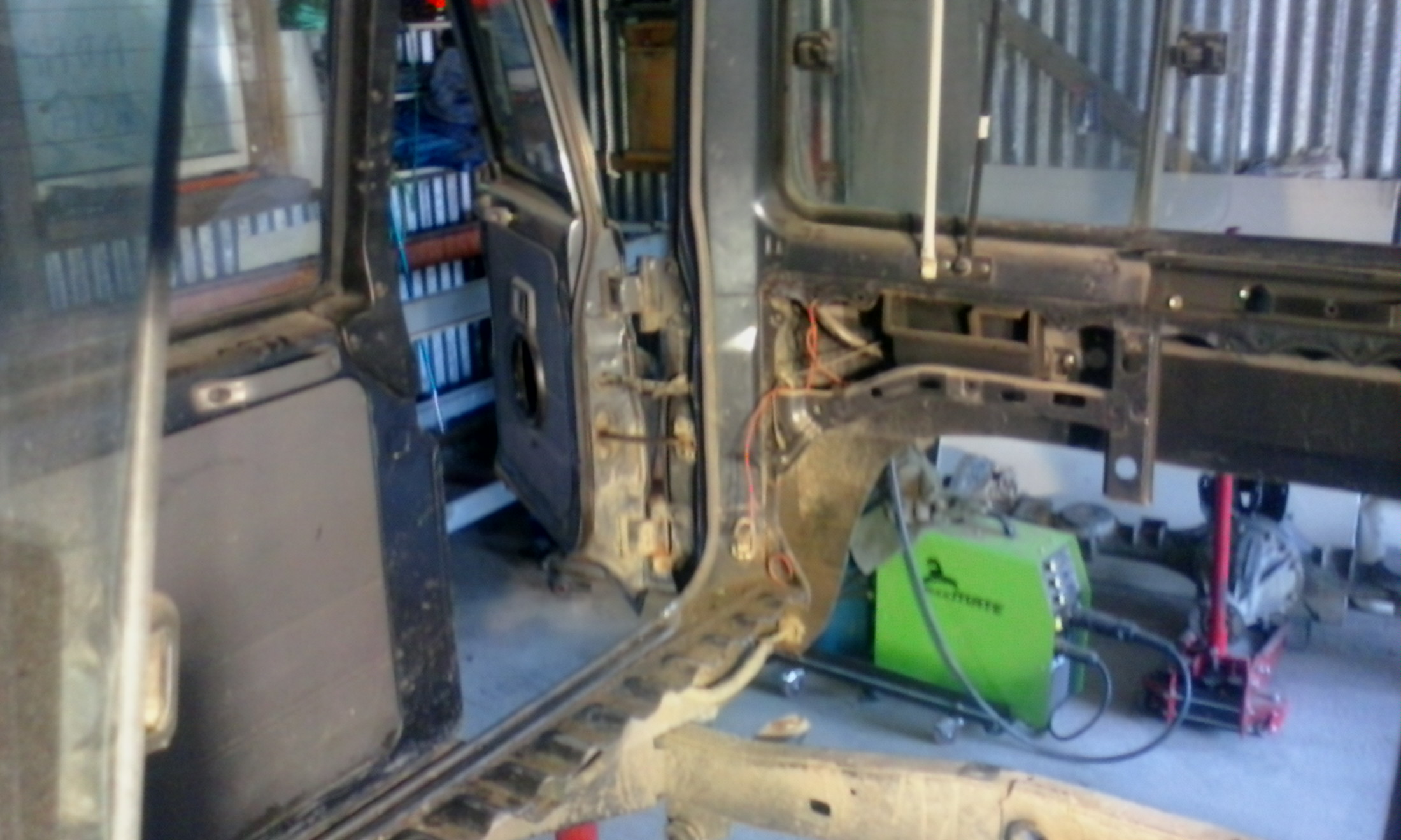

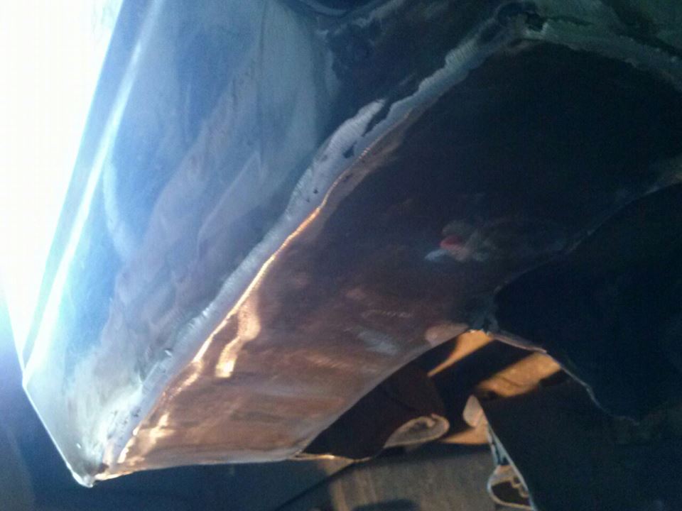

making room again love changing my mind
The_wehi@hotmail.com
(027 788 1046)
Pzj77 Turbo/auto,33's .
The WEHI
Posts: 387
Re: My Toyota? Slow project....
Post by The WEHI »

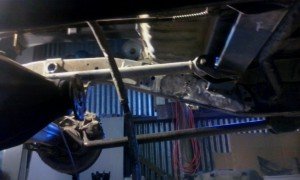

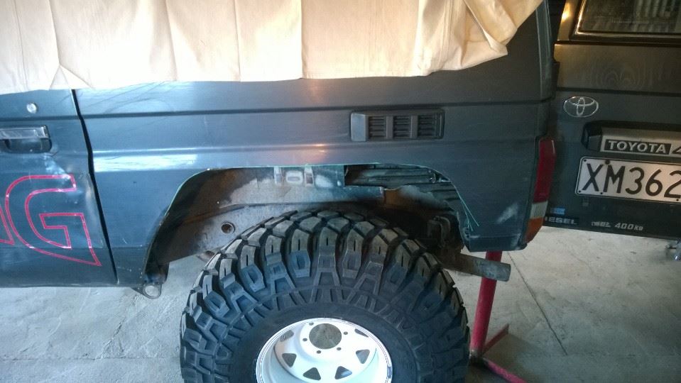

Got carried away making room

Slip with the grinder?
What's the plan for the back now? Or wait and see?
The WEHI
Posts: 387
Post by The WEHI »
skidmark wrote:Slip with the grinder?
Just 4link and pan hard in the rear cut the floor out because i needed room for coilovers and crossmembers the section i needed to cut out held the fuel tank and the front where a crossmember would be so just chopped the lot out

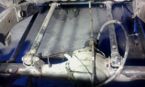

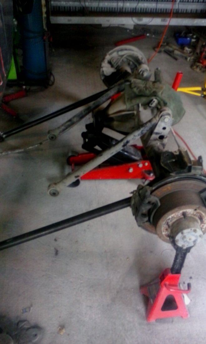

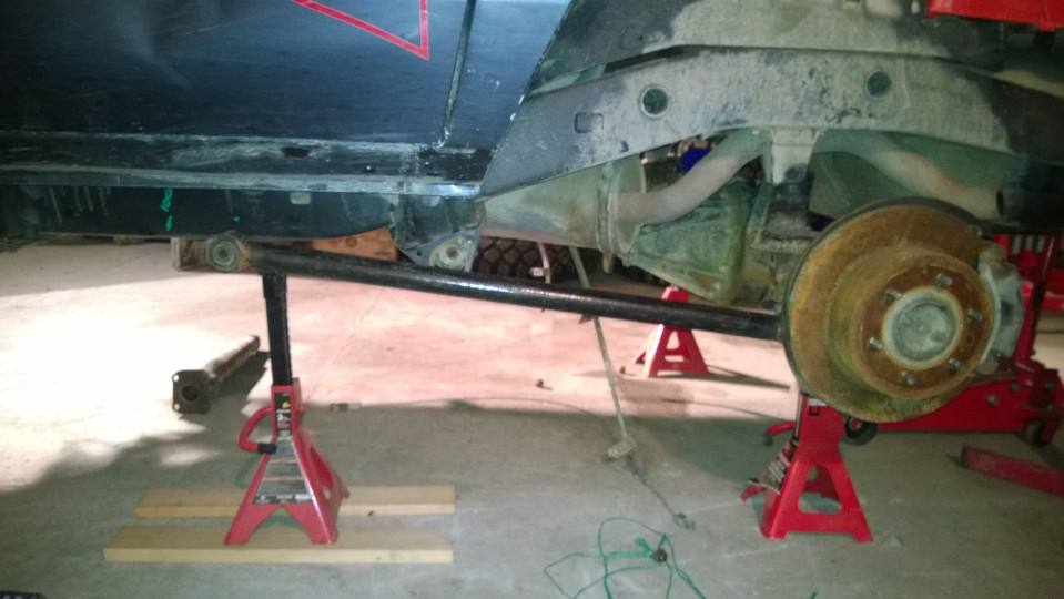

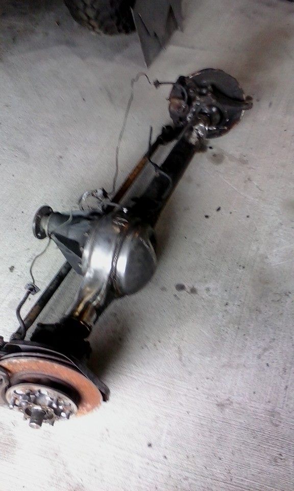

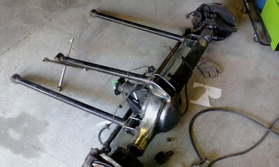

lower links on new rear diff

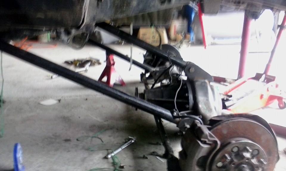

The WEHI
Posts: 387
Post by The WEHI »
More pictures

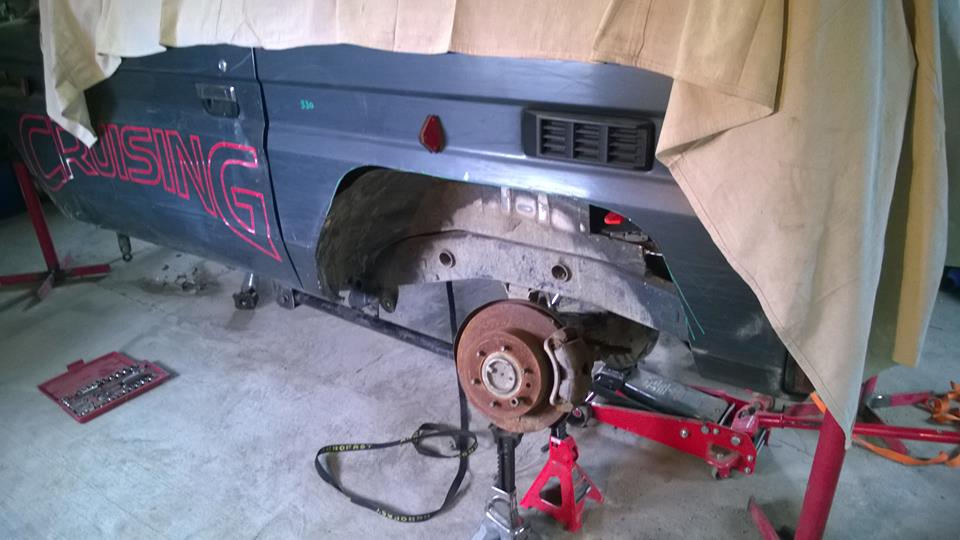

The WEHI
Posts: 387
Post by The WEHI »
(027 788 1046)
Checkerhead
Posts: 463
Post by Checkerhead »
No triangulation? I assume you are running a panhard?
The WEHI
Posts: 387
Post by The WEHI »
was triangulated with the safari rear, but now runs 80series lowers as uppers and custom lowers with panhard
