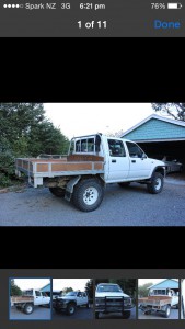

I like the look of this rough saw timber what sort of timber would this be?
Re: Hilux decking
Hard to see.
Could be dirty ol pine that's been stained
Re: Hilux decking
its just stained ply. looks like a couple of ours when they where new.
