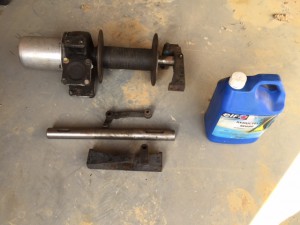

I'm putting a little something together.
The50 is getting pretty close to rebuild time, and part of that rebuild is fitting a PTO winch.
I have got my hands on a Cruiser PTO winch.
I also have a PTO that runs off the Suzuki T.Case.

Looks like I might be missing the dog clutch part that slides on the shaft to engage the drum??
Gonna have a crack at setting the fee spool up via a direct mechanical linkage from the cab, so the dog clutch could be useful :lol: :lol: :lol: :lol:

DieselBoy wrote:Yeah, here's to hoping huh!!!!
were they the ones one trademe a while ago?
DieselBoy
Posts: 4568
Re: PTO Winches
Post by DieselBoy »
Yeah, ex Mikes (Mr Runva and MCC ) winch challenge Hilux, hence the monster oil reservoir on the gearbox :lol: :lol:
