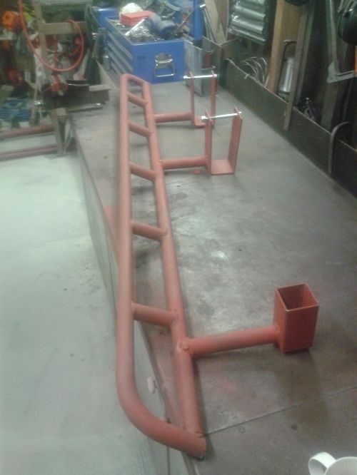

Here is a pic of mine before after I painted them. I used a bit of box section to go up inside where the front body mount is and braced that and the u brackets gave jacked off them dropped the whole vehicle on them and they don't move.
The angle bracing was an after thought
