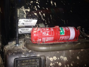

I've got a supercheap one mounted internally
Re: TD42 Radio Antenna Replacement
3.2 Ali welding wire lasted well so far
