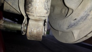

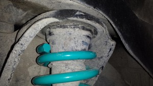

Maybe longer shocks have been put in to give more articulation, common mod with these. Generally Commodore shocks are used. If this is the case try putting standard shocks back in as they are around 50mm shorter in travel.
See if you can a part number of the shock, if not measure it's extended length and get a pic of it up here so I can have a look.

Oh, and get a pic of the top and bottom shock mounting as well if possible.

Found a part number and the shock is a monroe gas 2-0115 and another number d-03mr923

Post by drewz1 »
Top of the shock
drewz1
Posts: 64
Joined: Sat Jan 26, 2013 11:35 am
Re: 1990 zook suspension lift
Post by drewz1 »
Bottom of the shock

Hard to say if they are the original shocks from those pics. Monroe website states the standard shock extended length is 463mm, I suspect that this is from the center of the lower eye to the bottom of the lower steel washer on the top mount. Measure yours to determine of the shocks are longer.

All sorted now thanks for the advice went back to place i bought springs from told them the problem and they mesured up shorter shocks got them all fitted now it seats perfect
