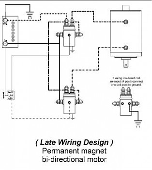

I probably should have listed the model, it's a Superwinch PM 3000 so just has two poles on one end... like this but sans the plastic cap on the end haha
diogenese
Posts: 307
Location: Temuka
Re: WTB: Winch controls? Akl/wherever
Post by diogenese »
If you want solenoids use this diagram, the solenoids are about $25 each of trademe, you would need 2 plus wiring and a switch.

Post by Del Fuego »
Cheers man :)
