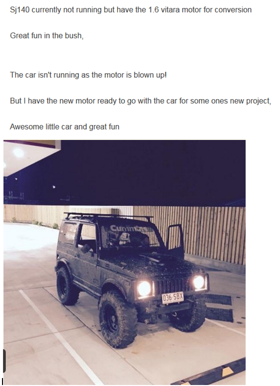

Hey Members,
I am seeking advice on the possibility of putting a 1992 1.6L Vitara engine into a 1988 SJ410.
Seller is selling the SJ410 with a blown 1.0L engine and a running 1992 1.6L Vitara engine with 220,000km for $1500.
How difficult would this conversion be to complete as a project, e.g.
What gearbox should go in / Transfer case?
Tail shaft and gear issues?
Electric Fuel Pump
Wiring / ECU Issues?
Mounts for Engine and Gearbox?
Its my first project and seems good for an entry level as they seem easy enough to work with, plus I have the support of a few Zook fanatics? But is it a money pit?
Any pointers would be great!
Regards,
Reece

You will need a sj413 gearbox .
BenT Adaptor plate to bolt engine to gearbox
Custom gearbox cross member
Possibly custom transfer case mount
Custom engine mounts
Custom exhaust
Trans tunnel modifications to fit the 413 gearbox
Custom eletrical loom and electric HP fuel pump
Maybe a body lift to clear engine ,
Can use stock transfer , but liking at the tyre size you probably want after market gears in the transfer .
410 cvs , not the strongest , R&p gear changes hard to find .
Prob a bunch more small stuff as well
410 is different running gear to 413 and samurai
