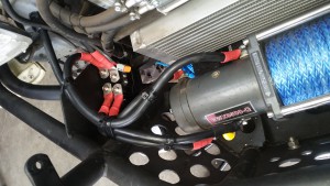

I ran outa any room in engine bay, so on front bar.yet to be used in anger...but it's wired up with 90mm cable....

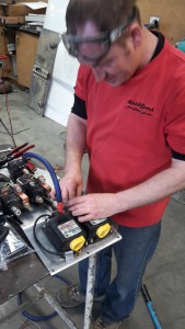

When space is tight, try mounting all your big electrics on a sub member / removable panel. That way all the heavy cabling can stay connected and in place, while the mount is put back in to it's permanent position.
Check this out to see what I mean. Most of the heavy wiring doesn't get touched, once installed and the whole unit lifts in and out. All the cables required to remove the system are easy to reach Fit's into a gap only a 100mm or so wide. Battery isolators, over boost solenoids and winch solenoid.
