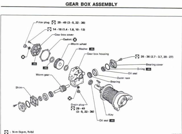

I understand there were at least two different winches for the safs, based on Nissan plans I have managed to find.
Is there a third because I think that there is a key or something holding the drum, axle, and gearbox surround together.

I think I was a unclear, I just wanted to know the chance of there being a key locking the drum from moving sideways off the shaft. Judging by your replies and the two assembly plans I have I guessed there wasn't. Hit it harder with a wedge between the gearbox surround and drum. It's now off.

Re: TD42 PTO drum seized
Thanks Coxsy,
I have this drawing but it is not the only assembly Nissan made, mine is a little different.
bottom assembly a early model PTO , shaft held by key at gearbox end for rotation lock only and clirclip at the hub end
