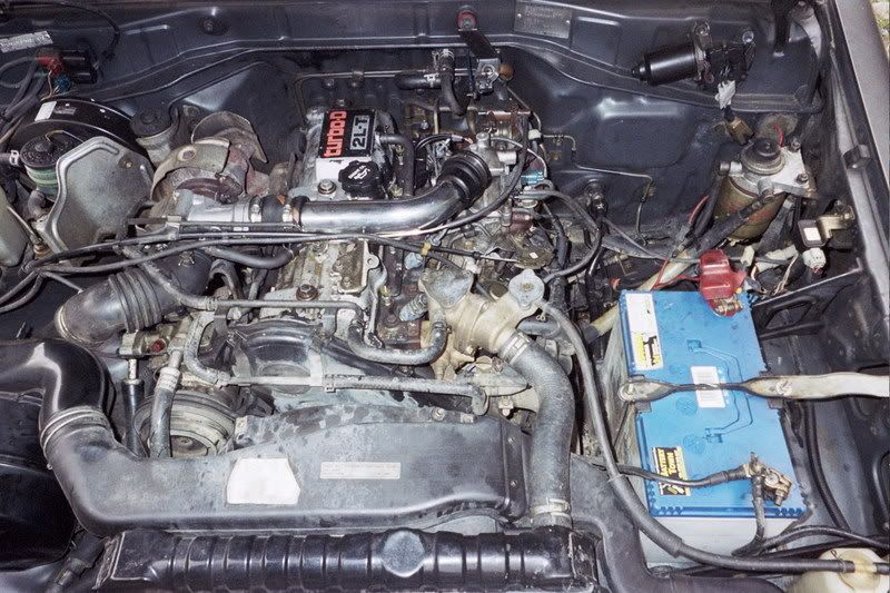

haha finally worked out to upload photos from photobucket . This is my stock engine bay as i type this , towards the end the of the year , it'll look nothing like it ( braided hoses , heat shielding , orgainised , etc )with a tad larger engine in place with serious grunt to be had .
