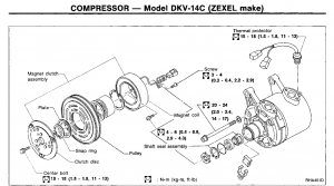

This diagram is from the petrol versions as i couldn't find one for the TD27T. Looks very similar, had a read of how it comes apart, looks like an annoy job without the special tools.
Might need to take it somewhere
Its very noisy and goes away when i turn the air con on. Also sounds terrible when i spin the pulley by hand.

1. Remove the M6 threaded bolt. Pull the clutch off by hand (sometimes need a puller, from memory an M8 or M10 threaded bolt will thread straight in to act as a puller, Be sure not to lose any shims that were in there (which set clutch clearance)
2. Remove the circlip, then use a three jaw (or similar) puller to get the pulley off.
3. Go muck around with a press and various sockets/bits of pipe to press the bearing out (making sure to support the pulley at the centre or you will bend it for sure).
4. Press new bearing in (again, support at centre).
5. Punch/Stake the pulley to ensure it all stays put (look at pulley before pressing bearing out and you should see that they have a few punches from factory)
6. Reinstall pulley, bit of bearing retainer is a good idea. Sometimes they basically press on by hand, other times they require a bit of encouragement. Make sure you strike near the centre, and evenly around the edge (This is probably the hard bit if you were doing it in place on the truck).
7. Reinstall circlip.
8. Push clutch back on. At this point remove shims to adjust clutch clearance as good as you can (aim for as close as possible but not touching).
9. Reinstall M6 bolt.
If that sounds to hard/don't have access to press and puller, pay someone.

It can be done on the vehicle. Bearing is about $40 (nz). I made a simple puller, and put a thread the 3 holes in the clutch plate to m5 and use puller to pull those. If plate is on real tight then you may need to thread holes to m6. But if checkerheads right that the centres threaded to remove it'll be an easier job (follow his steps). Take care with the small spacer washers (in picture next to snap ring) as its easy to drop and loose.

Yeah your three small bolts rings a bell. I might be getting mixed up. One brand has the old bolt down the middle thing but I might be wrong on it being the Zexel ones.
