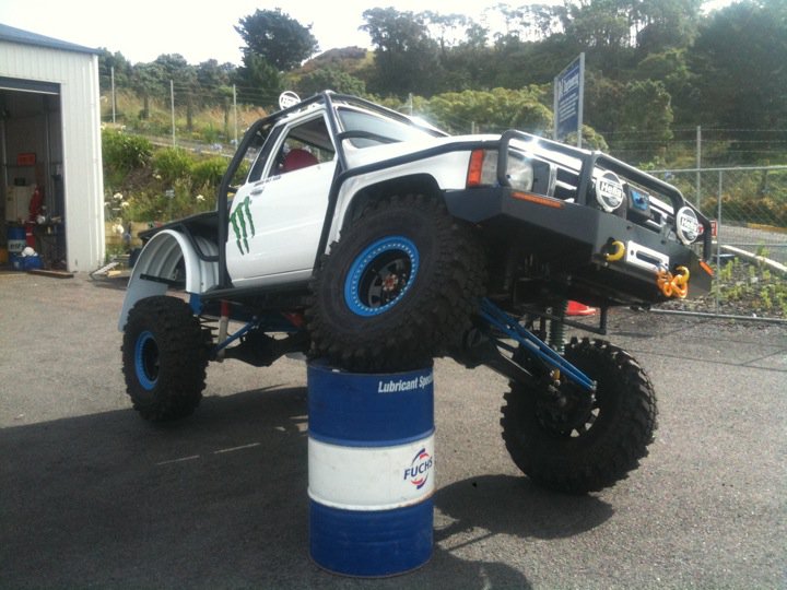

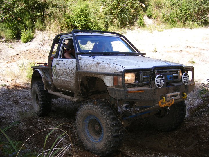

Looks winch challenge spec to me mate! Very cool.

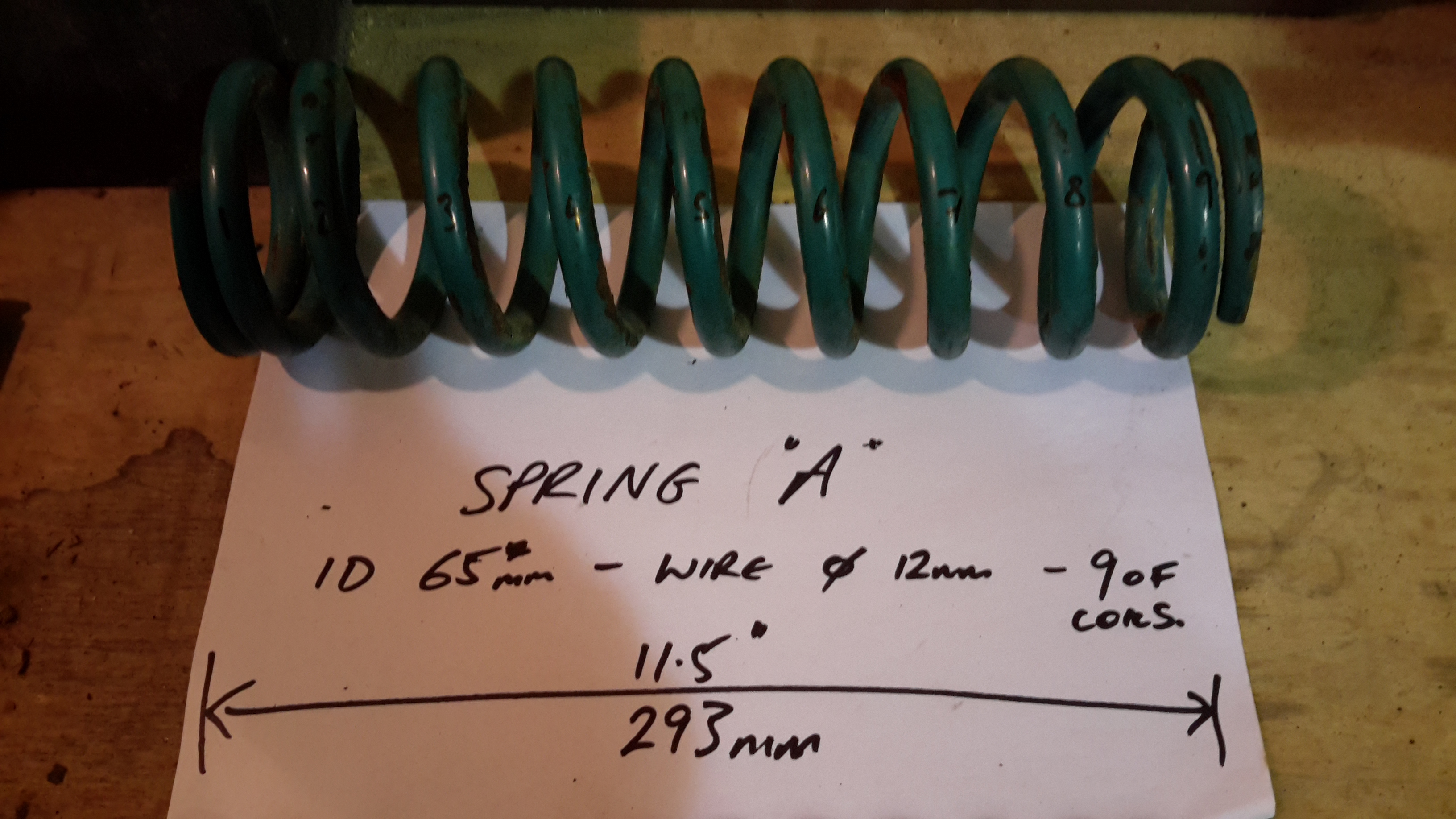

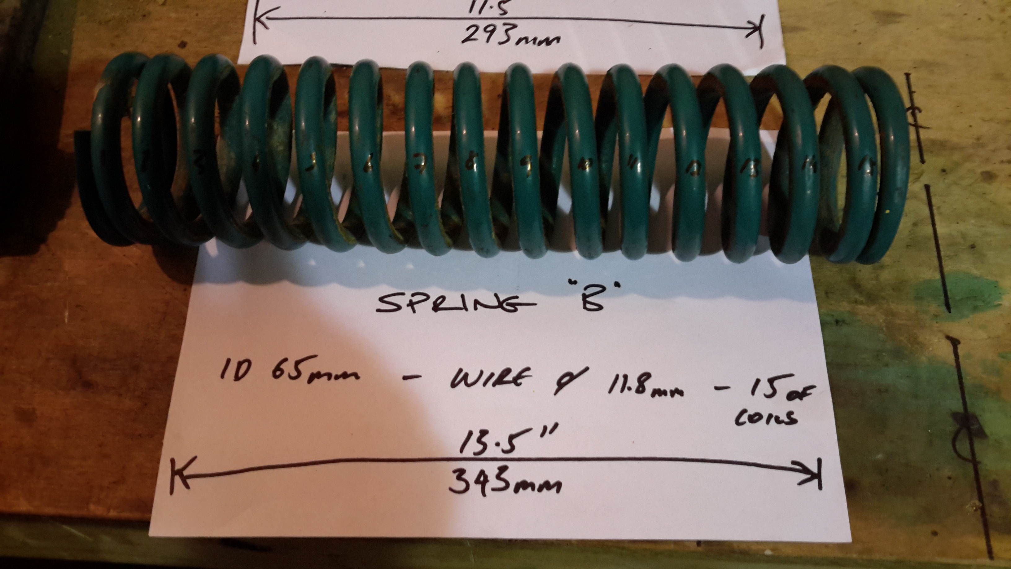

I need the dia of the wire, looking down on the coil the dia of the coil and the active laps of coil (don't count the seating coils at each end) and I'll calculate it for you

Thanks, De-Ranged ill get those specs for you next time im home which will be next week, and would much appreciate some numbers if you can. Ultimate goal would be Modified/Outlaw class for winch comps in a year or so.

That's an awesome looking truck!

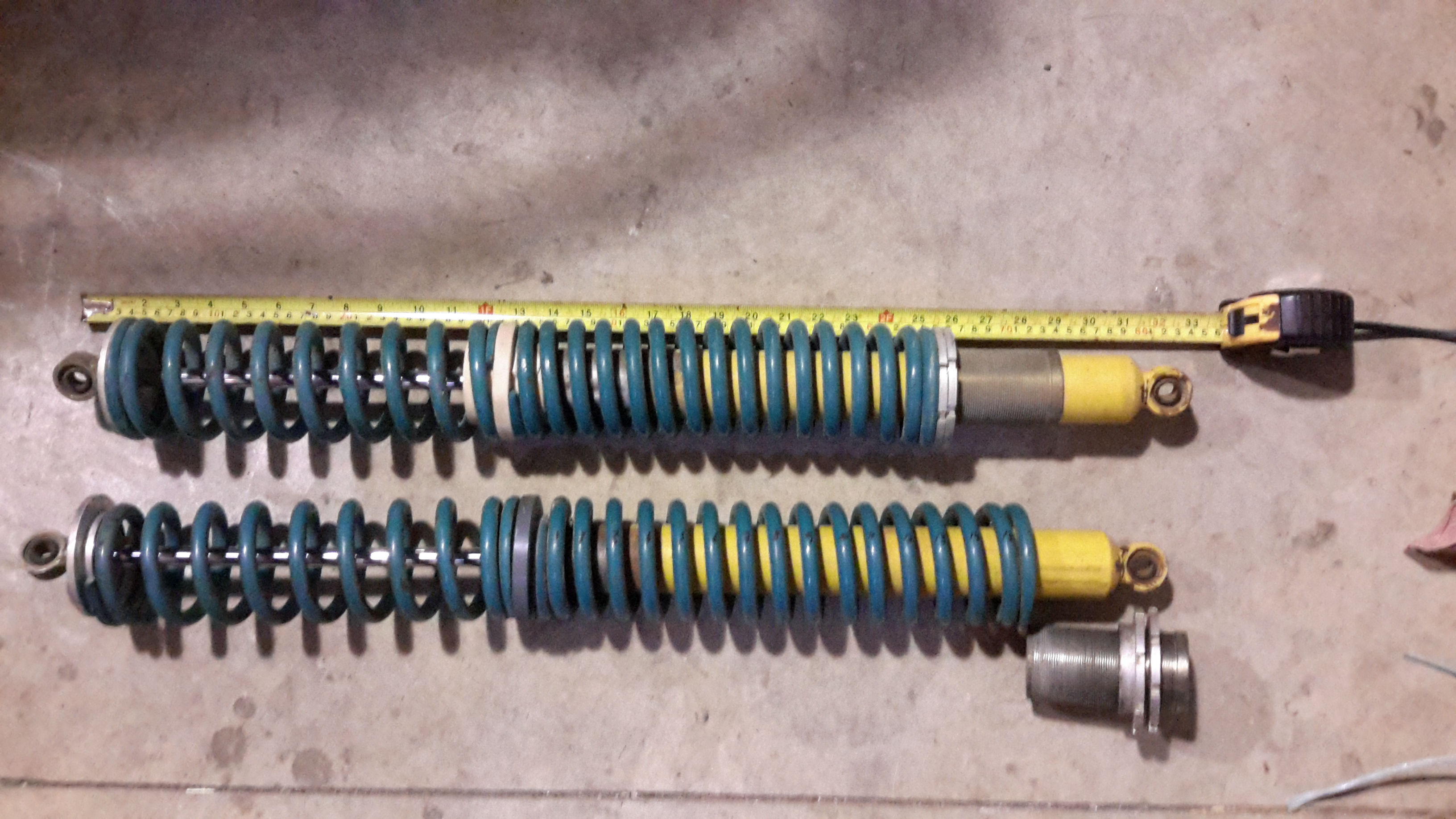

De-Ranged, attached are a couple of pics of the bilstein coils. If you could Calc some rates for me, would be appricated. Cheers

Hi, I know this thread is a little bit old but I noticed that you seem to be running your Bilstiens upside down, usually the body is at the top and the shaft at the bottom
