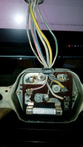

Hi all ive butcherd my looms to get rid of redundant wires an make it easier for trail repairs
in my haste to cut the loom i didnt take note of what wires on the Reg go where
is my reg and

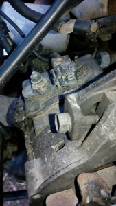

my alt
Any help would be awsome

Alternator plug is Blue = neutral, Green = field & Black = earth
Then the regulator should be as pic attached. I believe pic is looking into diconnected regulator plug. Code isn't for wire colour but for its function i.e L is light, N is neutral etc
