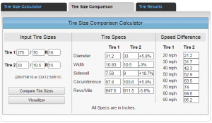

this is useful if you need to calculate:
https://tiresize.com/calculator/
Tire Size Calc
Tire Size Calc
Who knew Prados could fly?

NJV6 wrote:So I did some quick maths and left with a wof as you'll see below. If you have a generation 2 Pajero they came factory on 31x10.5x15 or 265/75R15 (sticker inside door jam) so you'll find that 33's are about 6% bigger, most measure about 32.7, a small enough difference for them not to bother arguing.
With the 4% tolerance in place now, you'll need to be careful :-D
