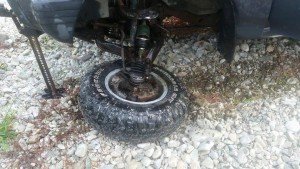

Keep an eye on top balljoints; )
mudsurfv6
Posts: 648
Location: pahiatua
Re: The Pajero
Post by mudsurfv6 »
you wouldn't want that to happen at speed! :evil: (or at all).

That broken ones had a ball joint flip aye? Did it break the bolts or rip them thru?

diogenese
Posts: 307
Location: Temuka
Re: The Pajero
Post by diogenese »
On the broken one it was flipped but the bolts came loose and fell out, it dose get evil treatment though!
