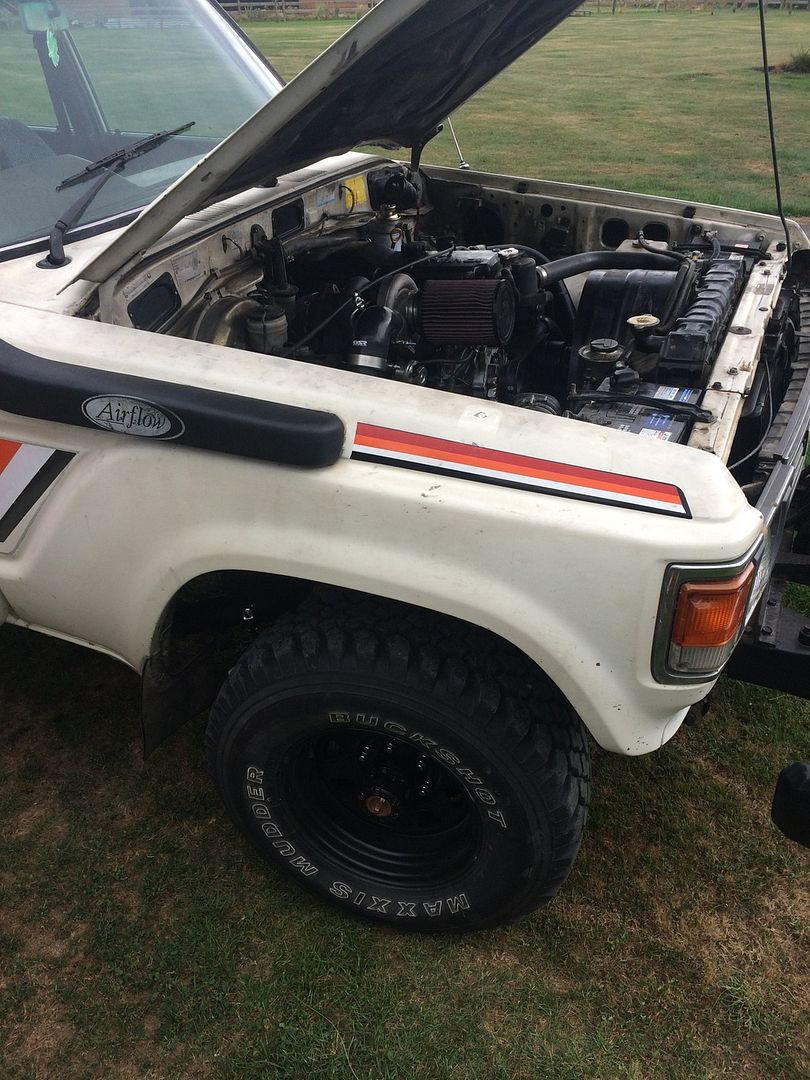

HI all,
ive got me a BJ60 and it needs some more life. I do a bit of towing and the bulk of the time itll be used for mountain roads and riverbeds ( jet boating ). I want a non-ecu turbo 4 pot ideally. its currently a 3B with 5 speed.
I want to retain the factory PTO winch if possible and am looking at 13BT, 14Bt and 15BFT engines for ease of install ( will bolt to stock H55F trans Im told ). For power Id like a 15BFT if I can find one, which seems to be the problem.
