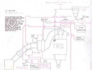

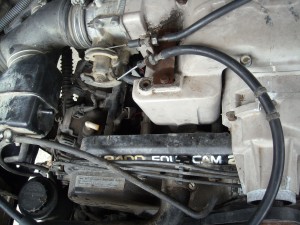

got most of supercharger fitted but can't figure out what some of the hose fittings are.
1/ the little white 90 degree pipe on centre left with no hose on it. went into intake manifold after the throttle body, but there is no connection for this on the supercharger.
2/ there is however a pipe on the back of the supercharger that the instructions say to attach to a 'PCV' valve. this is shown on the schematic on the last page of the instructions:
does 1/ connect to 2/?
3/ one of the pipes from the idle rise thingy on the power steering used to go to intake manifold after the throttle body, but there is no connection for this on the supercharger. any ideas where it would go?
the end of the hose is bent 90 degrees and straight below the word 'cam' in the first photo.

Yes little white tail is pcv,so I'd hook 1 to 2

skidmark wrote:Yes little white tail is pcv,so I'd hook 1 to 2
thanks for that.
think I may have figured out the 3/. it may go to a T in the line from 'evap canister' to back of sc. past the 'brake booster' in diagram. (yanks brake booster on the wrong side).
