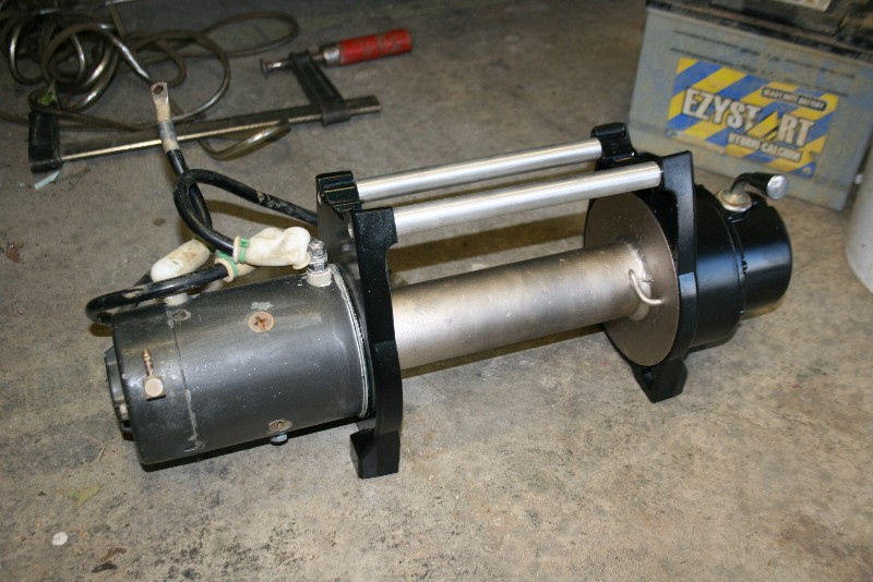

When I ran an electric winch I fully sealed the motor and tapped in a hose fitting in the end cap.... It never got water in it when I had it....
As for the gear box end.... Just made sure it had a coating of grease....(not packed full)
(Warn Xd9000i) You can see the hose fitting in the brush cover towards the left of the pic.

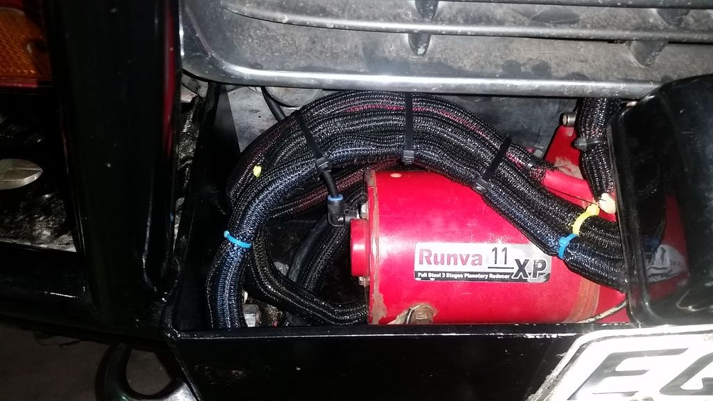

This my one
I also sealed it all up with good silicon
Had spare connections and line in diff breather kit so put it on winch
