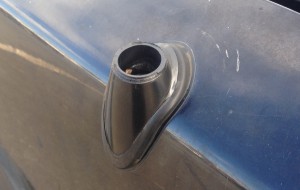

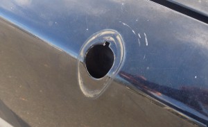

Hi all, can anyone recommend a replacement to the electric aerial on my 1990 Safari?
As you can see the cowl mount goes round the corner and none of the standard aerials fit. I don't want another electric one, just a rubber thing that can be bent over and smacked about without snapping!

Had the same problem with my pajero, found a short felxi one at jaycar and just used the factory base on i. Think the mates got theres at repco or supercheap and they both fit pretty good too.

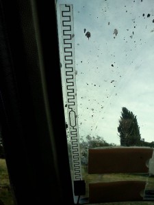

I just installed one of these, works way better than expected. No way to brake it unless you smash your windscreen :shock:
It just sticks to inside of the screen and you will need power for +- to its lil amplifier circuit, normal plug into socket in back of head unit. Now get stations I didnt know we had in the area. :D

I have made inserts in the past that fit into the top of the electric aerial (once the mast and sleeve are removed) that accept a 3.5mm Diameter stainless Rt whip aerial. I make them out of aluminum and use the sleeve as a template then use the top nut to hold it in.

Hmm, been holding off getting new aerial because I was expecting to have same crappy reception afterwards. Might give to windscreen mount type a go, for $15, will be worth a shot!
