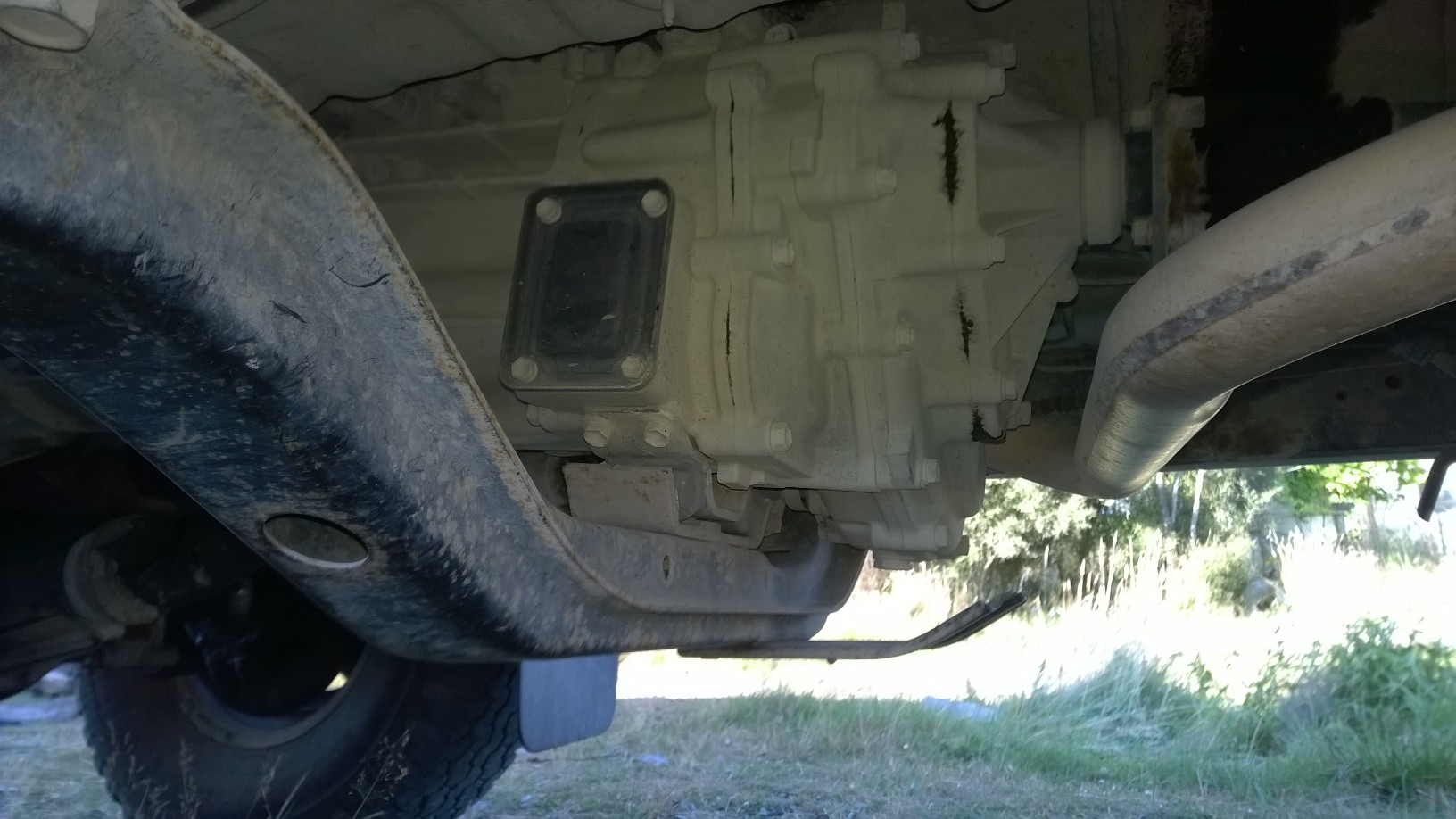

1. In this photo of my Gearbox (Transfer Case?), the black bit with four bolts in it, is that a PTO gear cover?

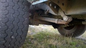

2. My front leaf springs seems to bend down instead of up; I presume they are shot yeah?

1. Yes.
2. Yes; he recommended getting two short leaf springs from a hilux rear leafs and add them into the front.

1) Yes, but don't go trying to find a PTO to bolt to it or a gear to go inside the box to drive said PTO. Toyota don't seem to know anything about them, there is a PTO company in Italy who make one that will bolt on, not sure about the gear for inside. I guess some type of Toyota some where at some time came with one, but they seem to be a thing of legend. Some one will say they have seen one, but ask for details and it gets hazy. That was my experience chasing them anyway. Hopefully I'm wrong and you'll find one (if you are even looking for one).
2) Yes, but even new standard one aren't much past flat.

thanks for that; i hadn't considéred the gear for it may not be behind cover. I found that italian site and also a thailand site selling the attachment but no prices and they each have different gear shapes. I may look into this further when i get to a stage of getting a winch.
