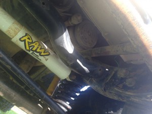

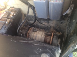

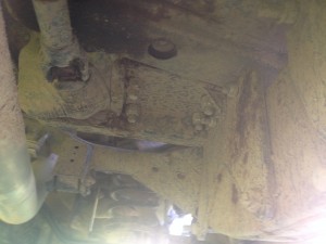

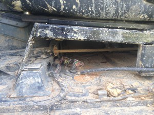

Pics , note I've got to pull pto for some tlc shortly so may have some more pics of cradle

Cool pics Cray. I assume from these that your truck is still full bodied?
Ever had dramas with your rope running so close to the exhaust? or is it not as close as the pic makes it look? (looks like it touches?).
Mine used to run close, maybe 40 mm air gap, that never had issues.

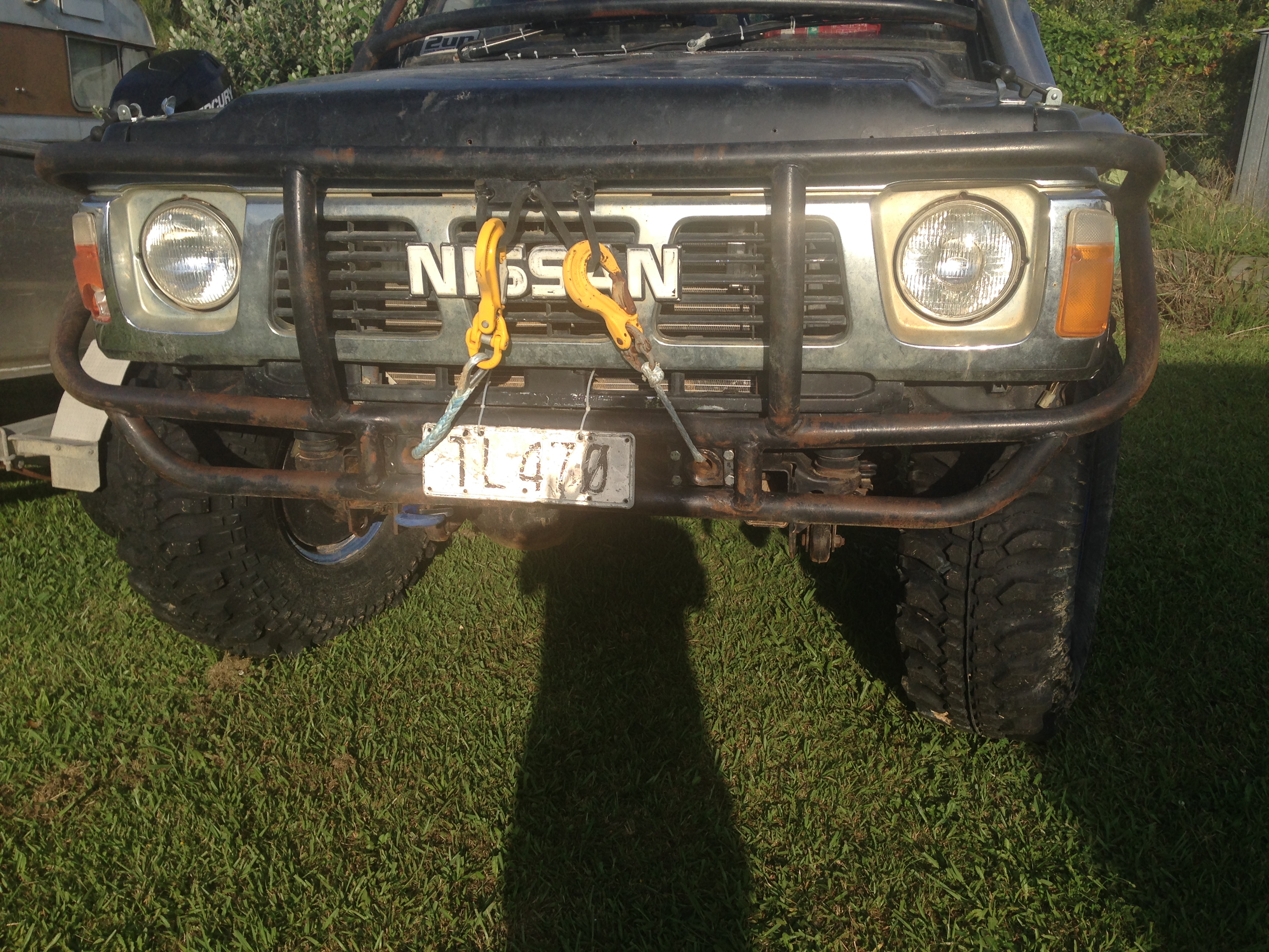

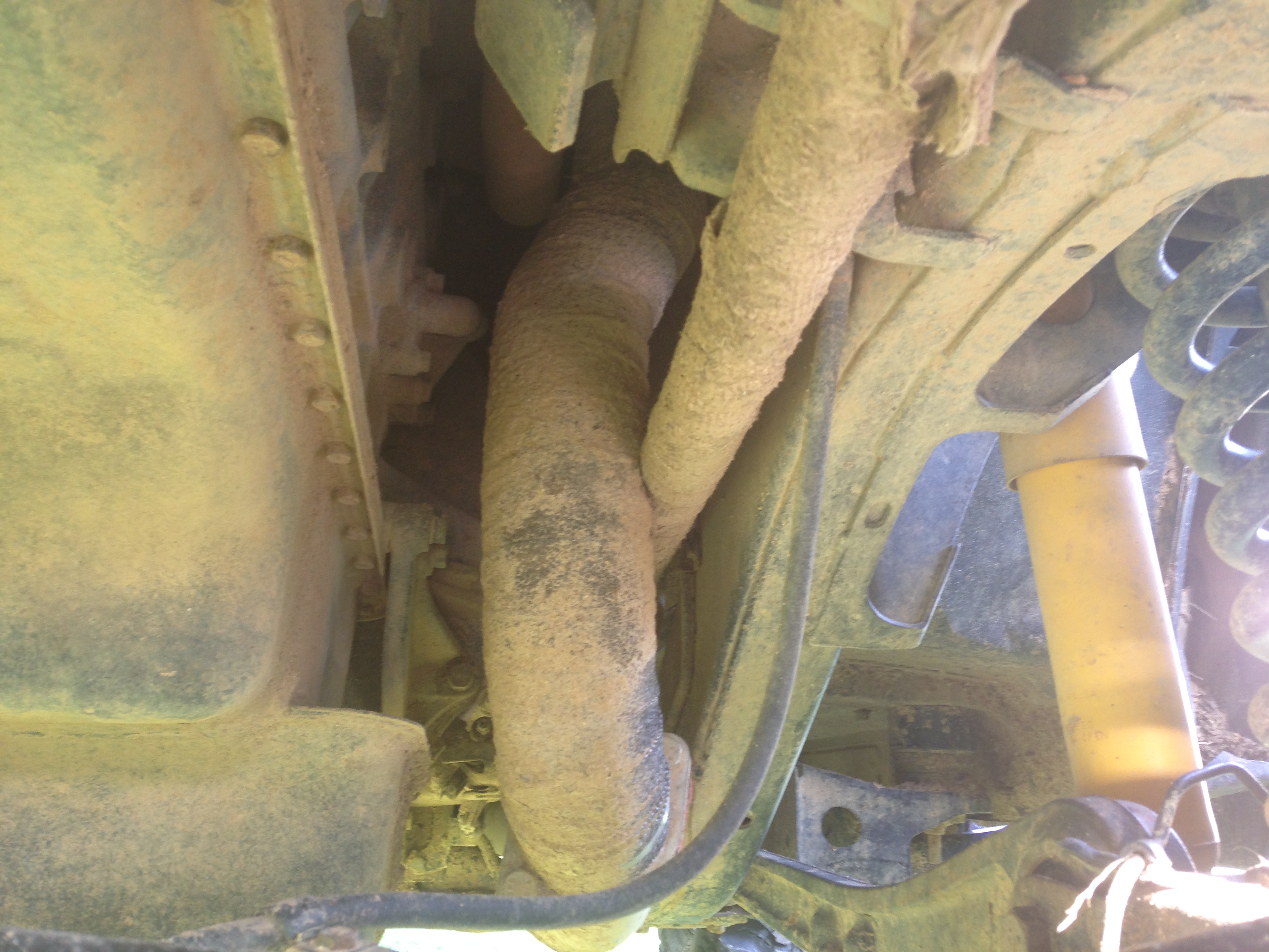

Yes full bodied swb gq
Winch tube hard against exhaust both both wrapped and have no heat issues
Agree with your 900mm, it's what I'm about to do as the 500-600mm isn't enough to fully spool across width of drum. Couple more pics as I've got a Runva mounted on other side
The added bonus of moving winch, bats etc back is the front now sits an extra 25mm higher.
