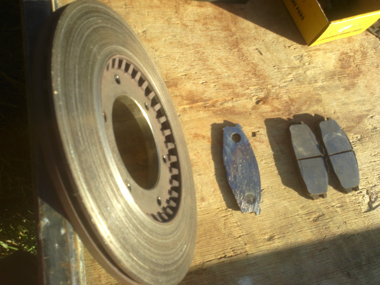

De-laminated brake pads!
Post by MihiT »
So it was quite a while ago that I fixed this, but the FL inside brake pad had completely de-laminated, so it was metal-on-metal! on my 6 month old NEW rotor! :oops: :evil:
1989 LWB 5-Seat TD42
fh2014
Posts: 304
Location: North Shore AKL
Re: (No longer) URGENT East Auckland
Post by fh2014 »
bugger. have had that happen with those cheap oem replacement pads from pm/bnt etc, get em real hot they seperate the next morning
