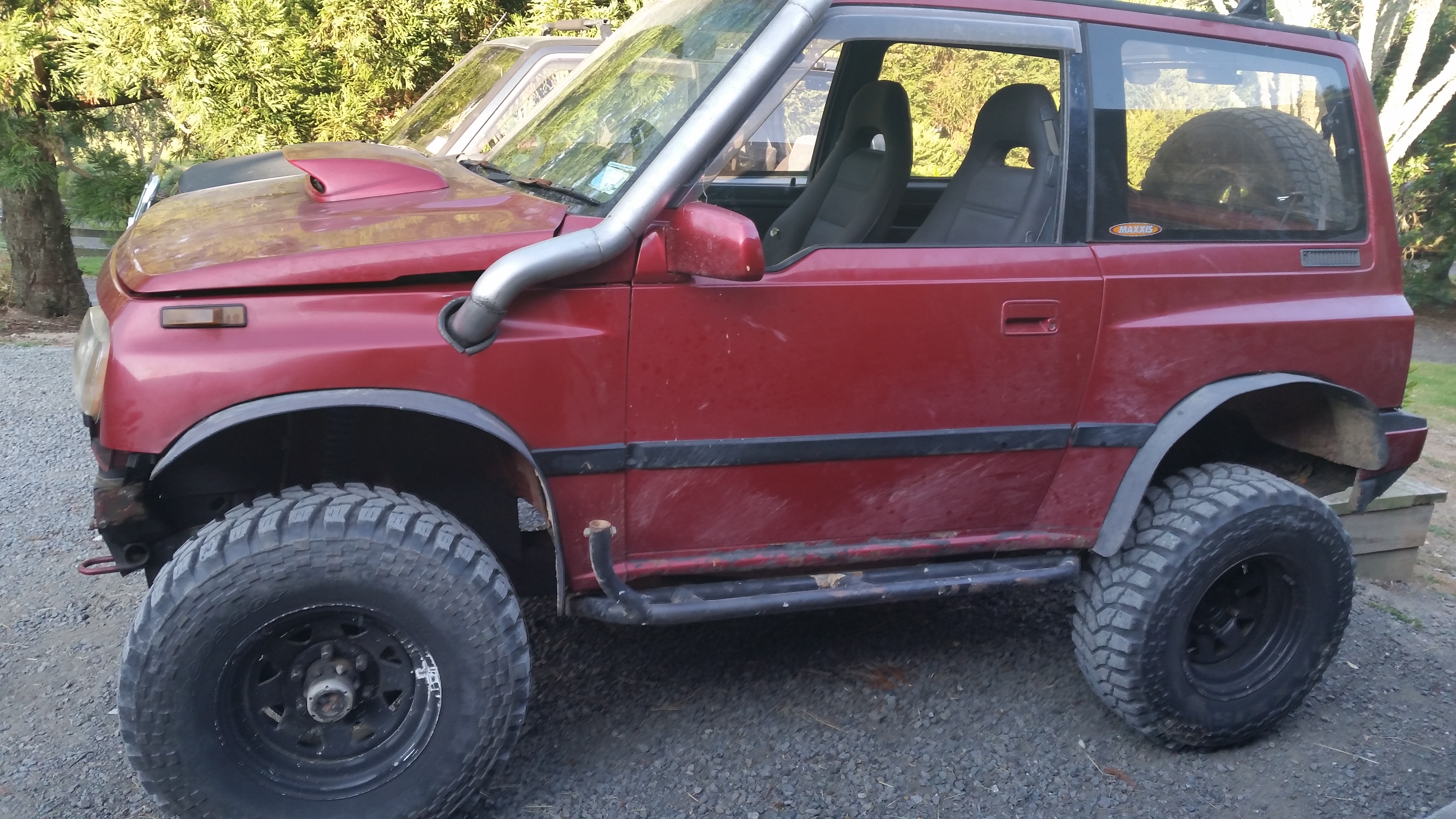

Hi guys.
i find myself owning a new toy im wondering if anyone recognizes it or knows who originally built it .
is a 92 swb escudo had a s13 sr20det in it when i got hold of it the engine was stuffed low compression on cylinder 1 and 3 around 30 psi
it has kzn130 front and rear diffs and axle with silvia s13 brakes all round as far as i can tell.

Yeah I've seen that in woodhill few years back
Guy I know also did some work on it trying to sort rear suspension.orginal set up was average from what I saw.

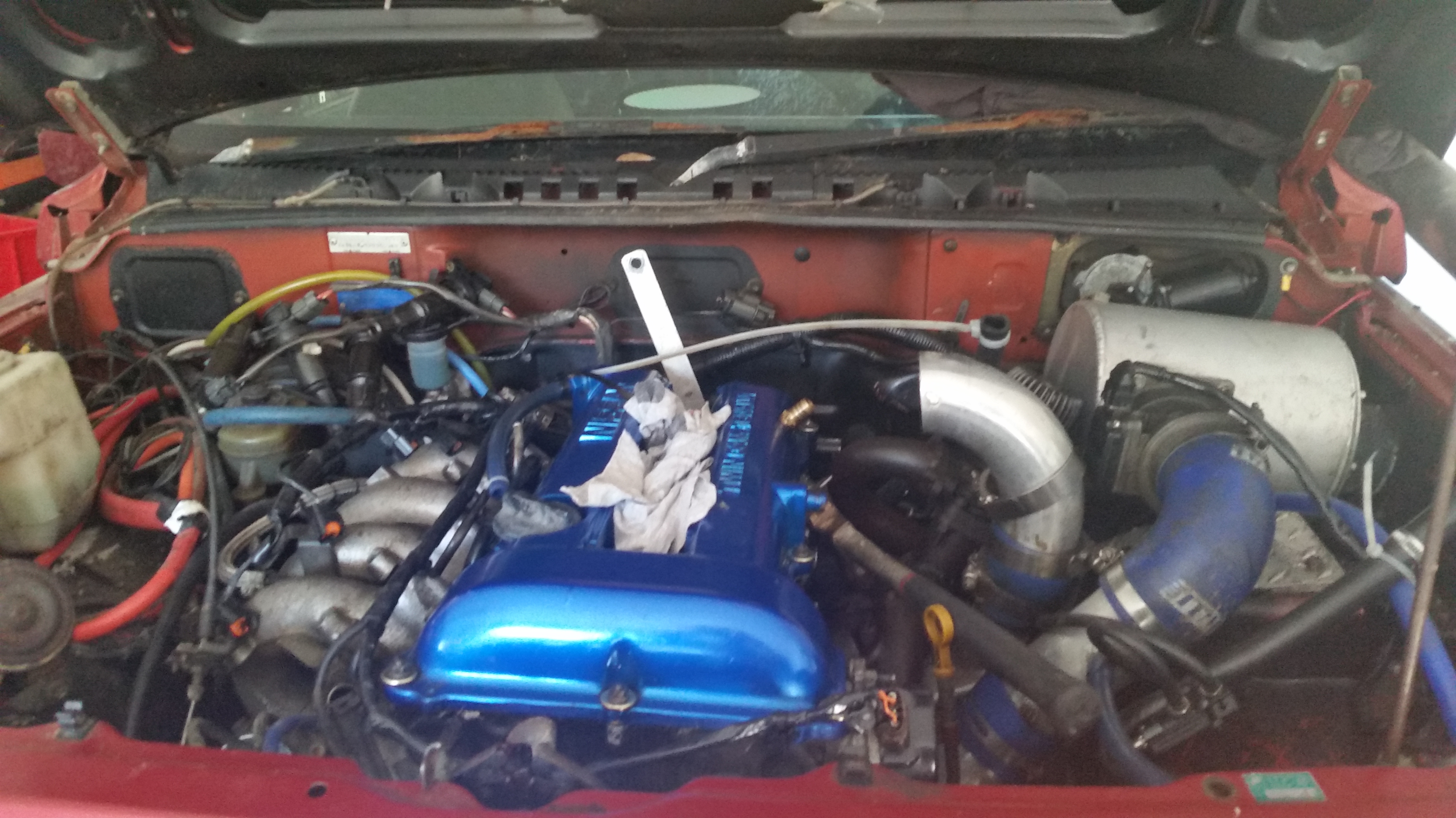

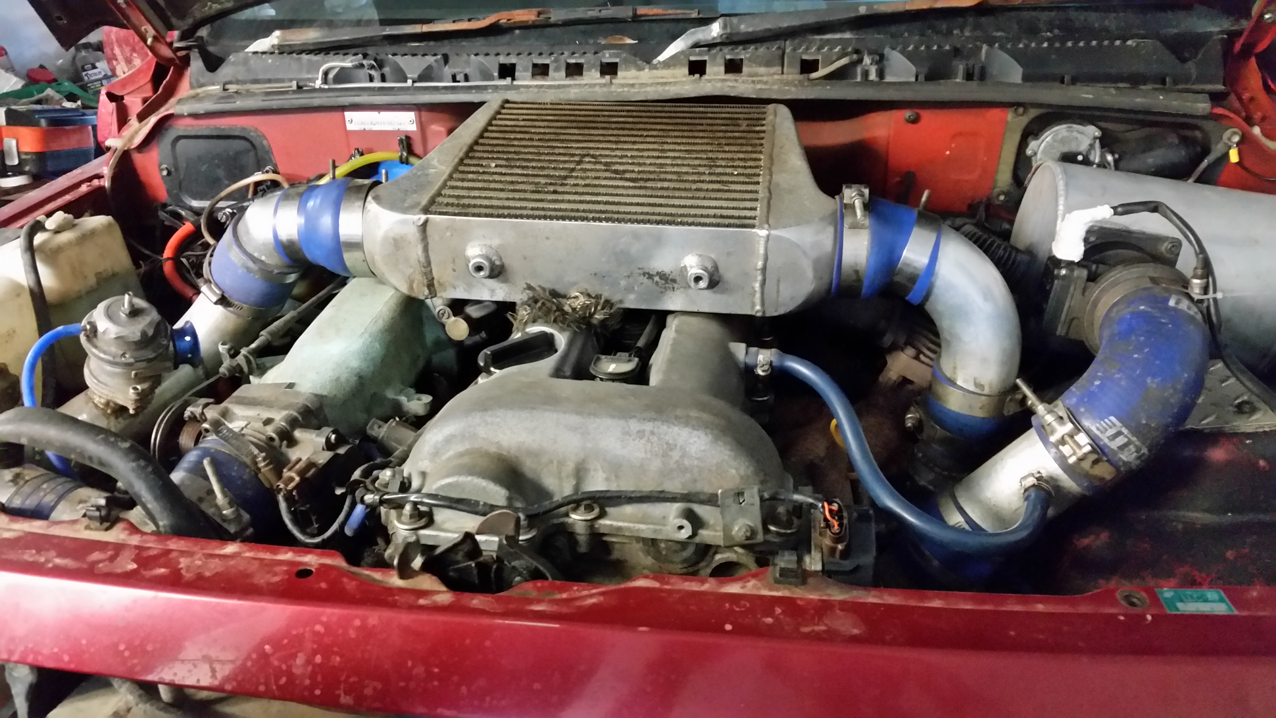

heres the blown motor a silvia s13 high port s420det as far as i can tell
and the new one i dropped in a silvia s14 sr20de+t

made up an IC shroud and mounted a fan to keep air flow through the IC at low speeds and need to sort out a switch for the VCT it idles a bit funny with out it and should give some more power in the lower rev range
