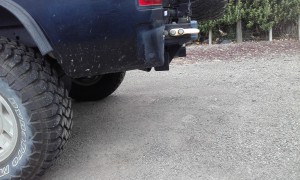

Here's mine. Upper bar is the bulk of the original towbar mounted with angle iron inside and outside the chassis rails. Lower bar protects the rear of fuel tank and has a 2" hitch receiver. Certainly not as aesthetic as some other bars around but not as ugly as I thought it would be. Il eventually add some sort of keeper to each end to stop the hi lift from sliding around.

Nice example that is

Thats a nice rear bar johnny, back to the drawing board for me. Does the the rear tow hitch allow for towing being closer to body?

mudslug88 wrote:Thats a nice rear bar johnny, back to the drawing board for me. Does the the rear tow hitch allow for towing being closer to body?
Josh
Yea mate tow hitch is tucked in close so it doesn't hang up like the original.
