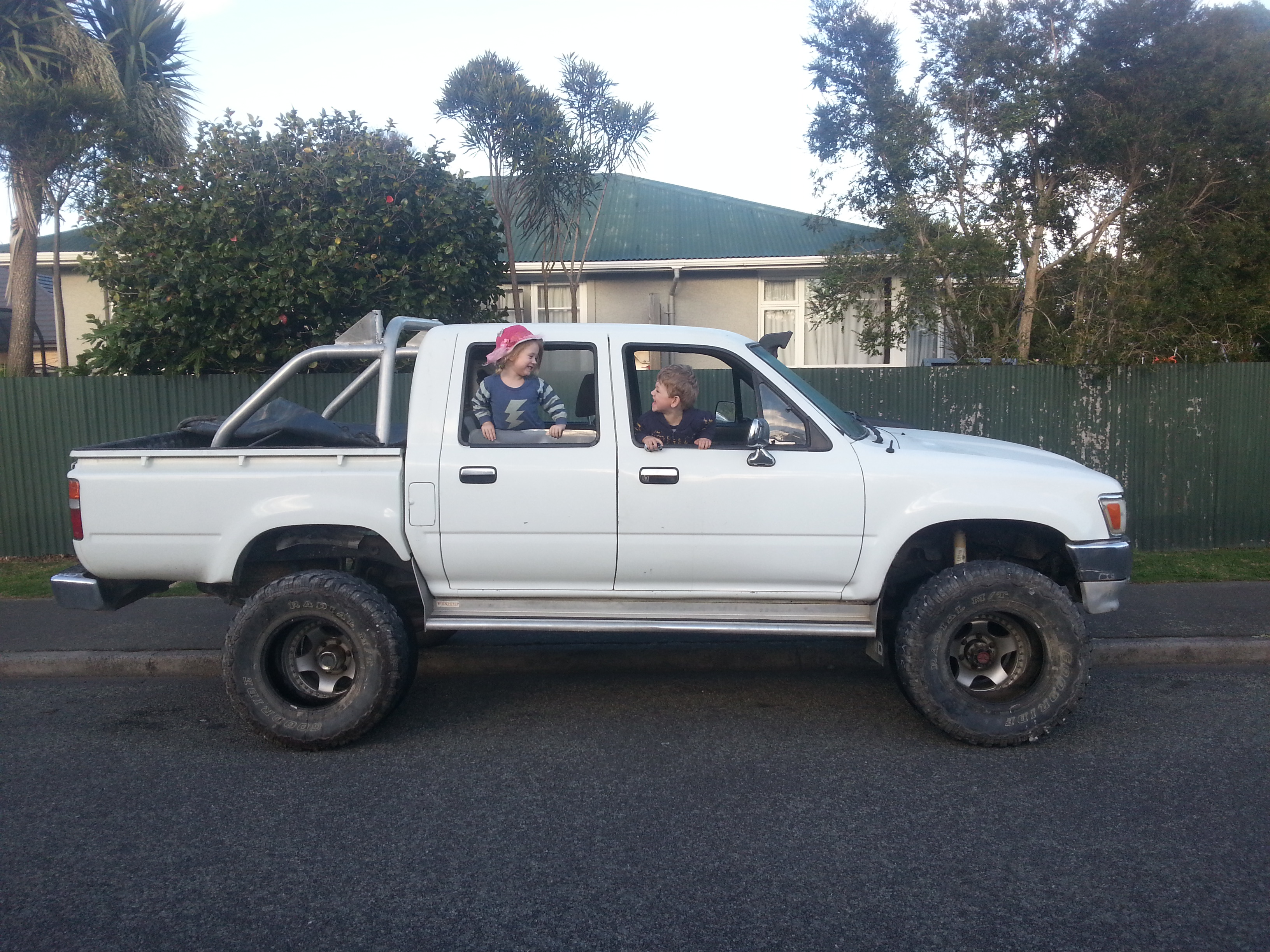

Needed something to put some bikes on and a bit of exploring .
Seen this ln106 pop up down in cromwell . Ready had a 5l and and turbo and cert . Was mainly used as a pilot vehicle hence the ugly bits im going to cut off on tbe roll bar .
Its got new springs of some description . Fresh lsd in the rear .
Came with 2 spare 31 goodride mudders .
Needs swivel seals but ohwell . It goes hard and drives good .

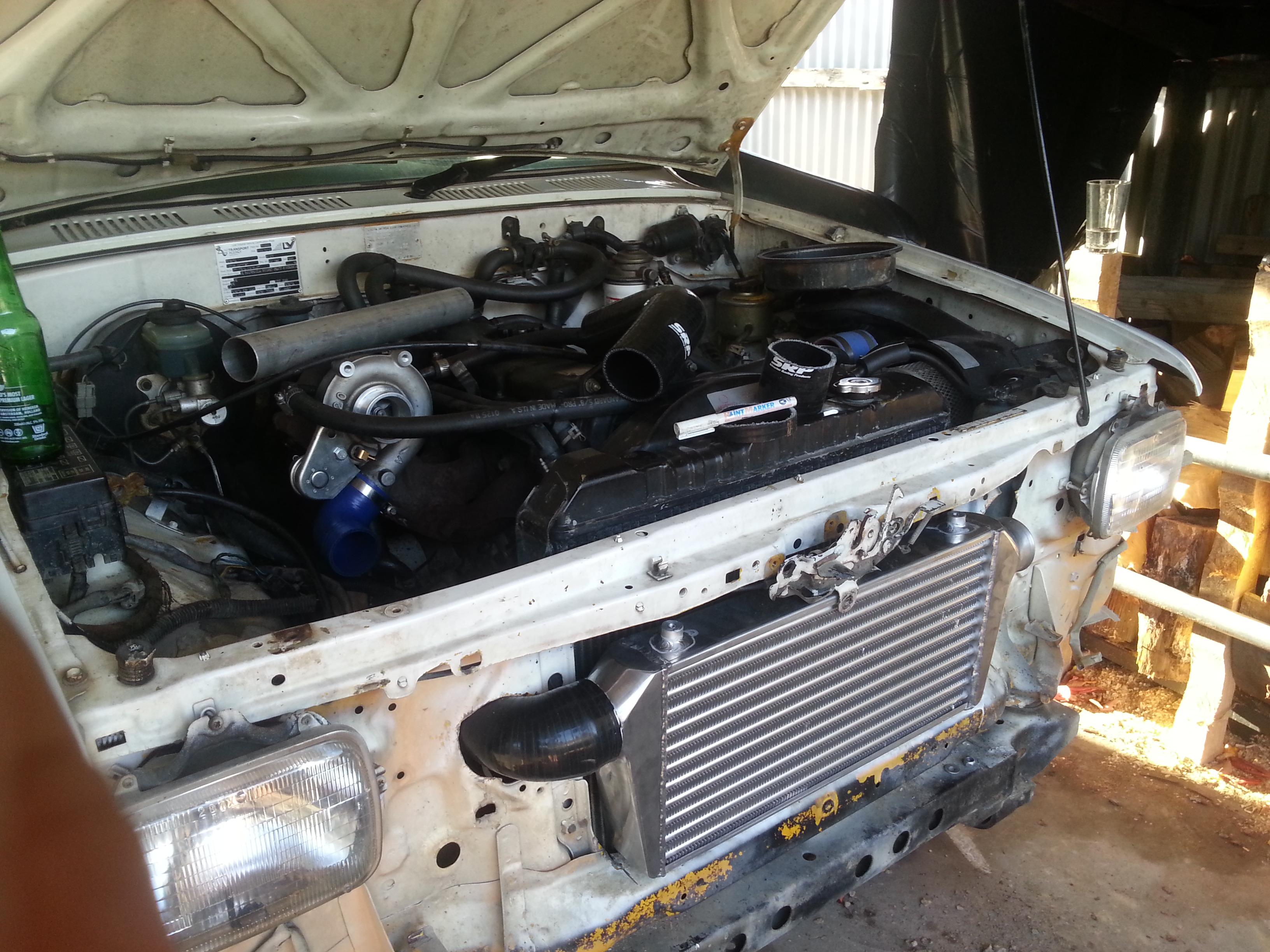

First plan is a front mount intercooler in the grill . Can fit a 500 x 230 x 50 core in there . Nice tube n fin one . None of this bar n plate boat anchor shit .
The turbo is a water cooled ct20 . It goes far harder than I thought it would . I have a modern td04 and a td05 off a subaru in the shed so ill fit these and see which I like best .

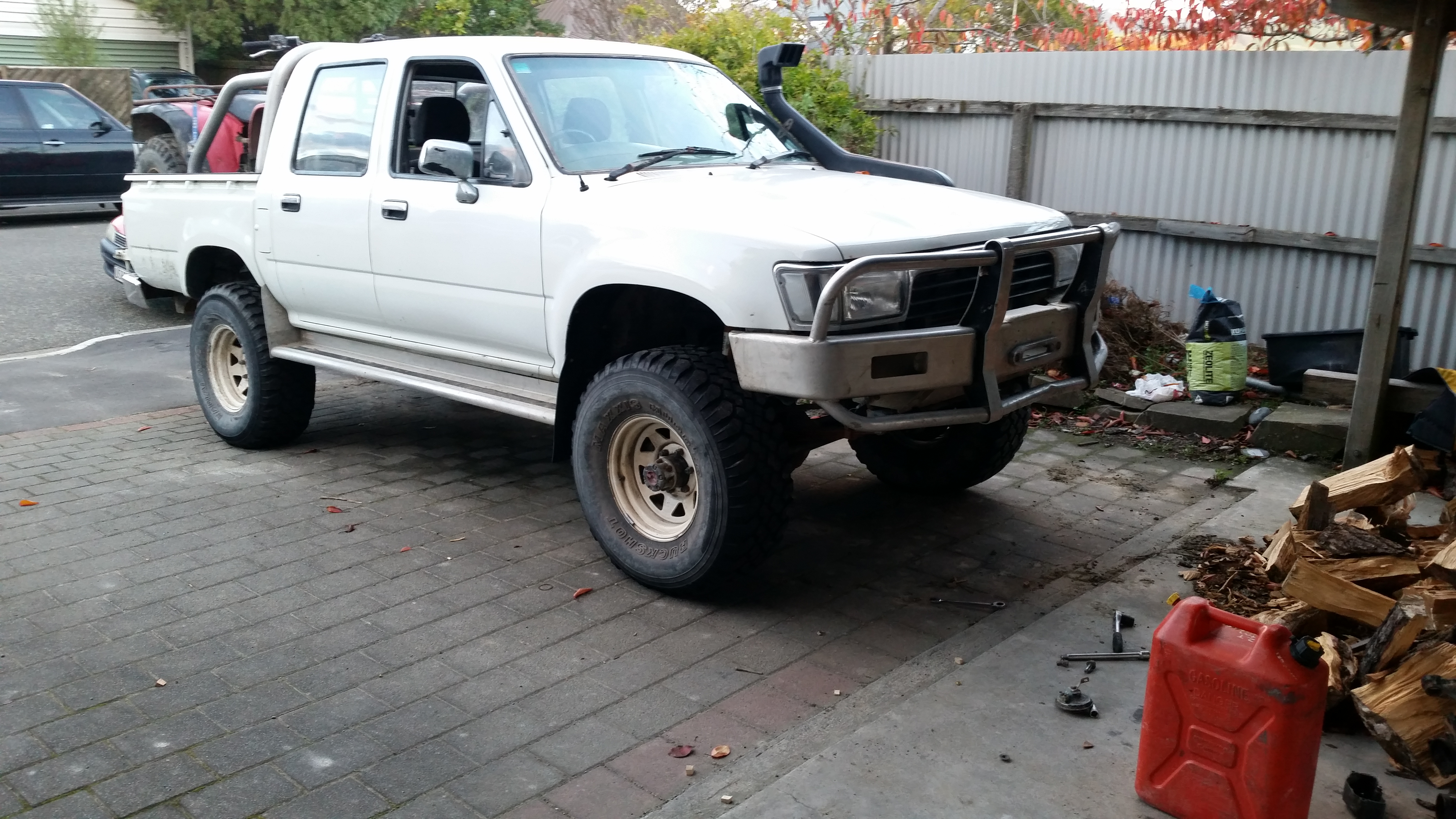

Nice truck mate, this wheels in the 3rd picture are awesome. Any idea what they are or specs, offset etc?
sirLachlan
- Posts: 109
- Joined: Sun Apr 03, 2016 8:28 am
Re: New heap in chch
Lol the 3rd picture is the 31 inch tires standing infront of the wheels on the truck

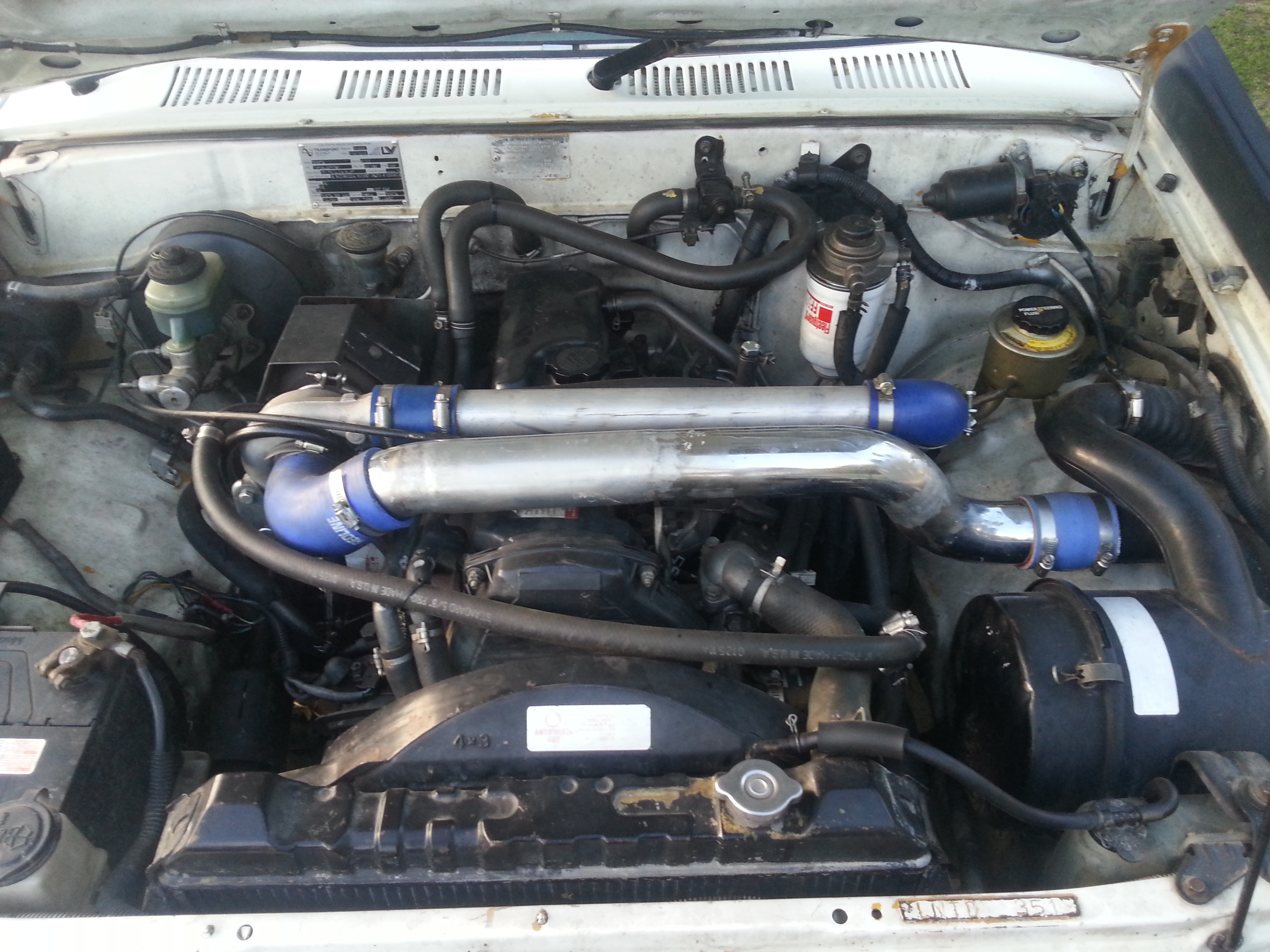

Dammit the driveway pixies didnt finish my intercooler install over night .
Oh well . All the hard stuff us done anyway . All thats left to do it trim joiners and each pipe then button it up . Also did the rest of the exhaust . Once ic us done ive got a bar to mount

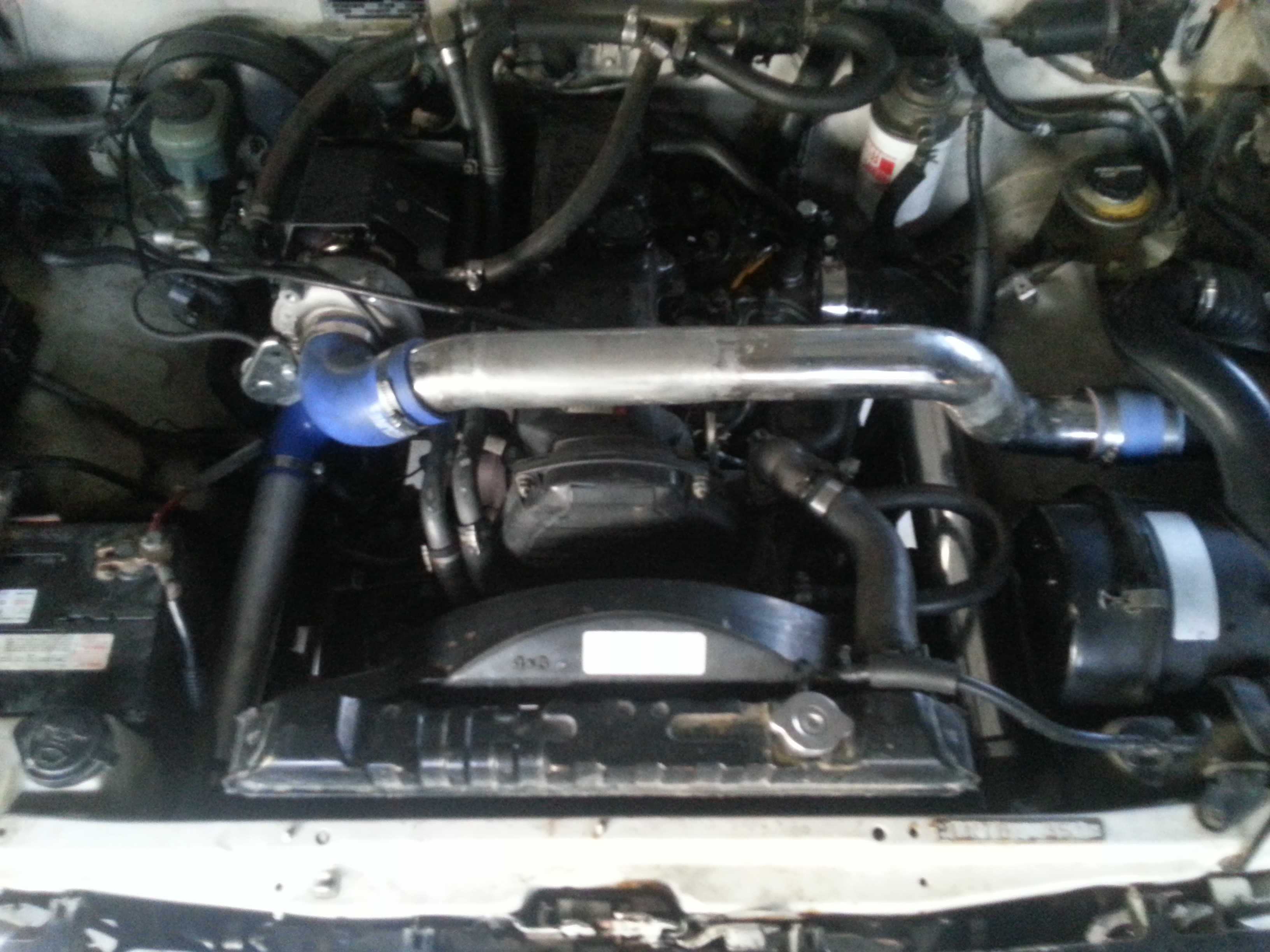

Finished intercooler . Pretty happy with it .
Got a boost gauge on it . Runs 10 psi at the actuator hose . Prolly gunna fit a bigger turbo . It already has a fresh water cooled ct20 but it literally runs about 7 psi at 100 and zero throttle it still has 5 psi untill I get to below 60 kph . Was gunna put a tdo4 ive got on it from a 01 wrx . They are quite nice and support about 200hp . I dont think its much bigger than the ct20 tho . Ive got a td05 16g off a early wrx in the shed also
Also put on a bar I got for free and tidied up the turbo water lines

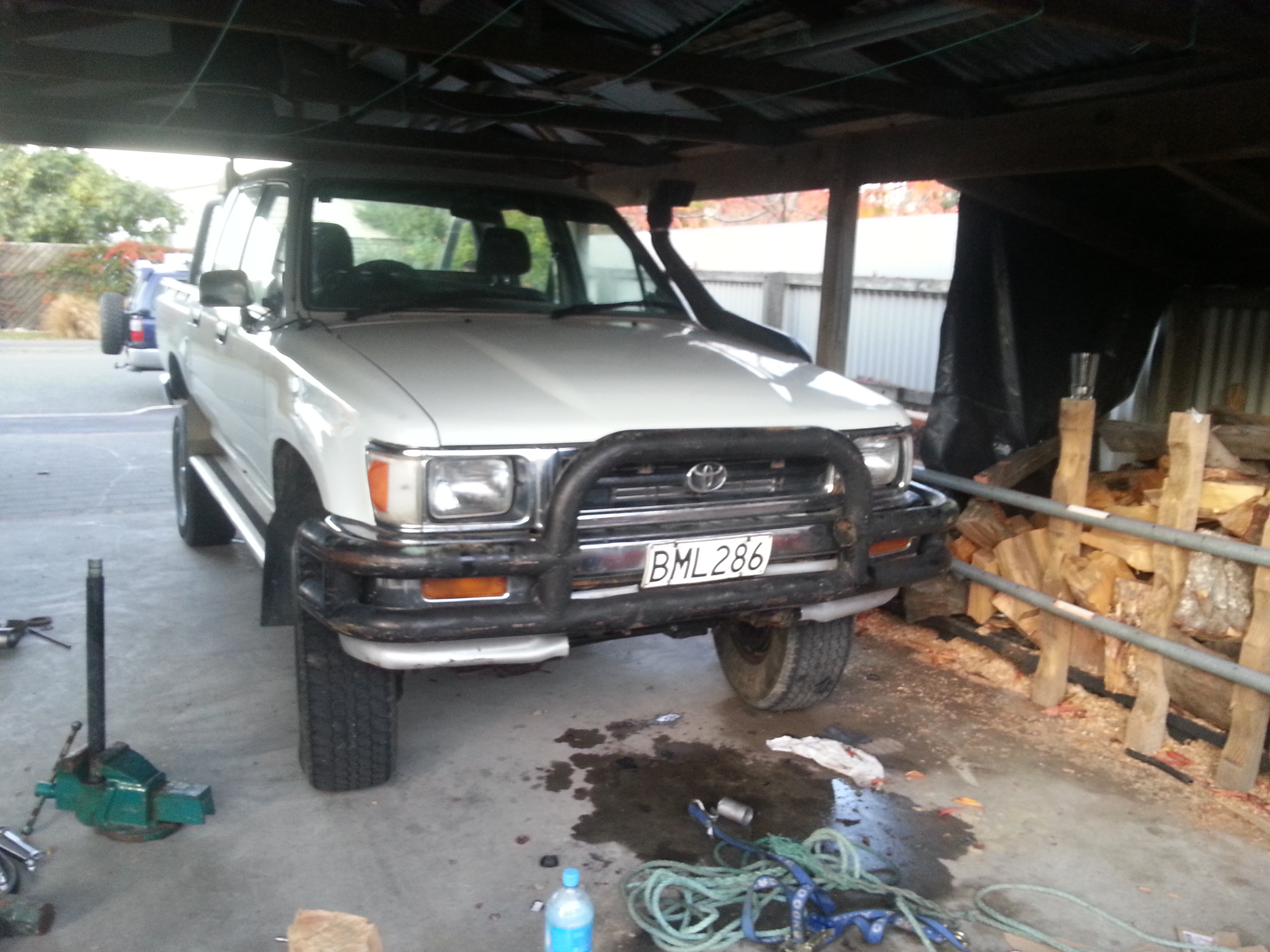

Since then it's had some 33s . Redid all the turbo hoses coz they were shit .
Underseat sub . Coz need tunes .
And tonight bolted on an alloy winch bar I got for 400
StI'll planning to do x over steering . Lsd spacers . Swivel seals . Front shocks to match 50 mm lift springs . Might move front axle forward on leafs .
Goes good .
Uses less than 11 l per 100k on the open road with dirt bikes up in the breeze . Pulls 3rd gear up porters with a empty car trailer behind it and doesn't get hot
Anyone want that black bull bar for a farm hack etc ?
Goes good .
