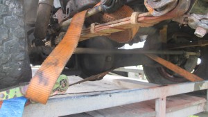

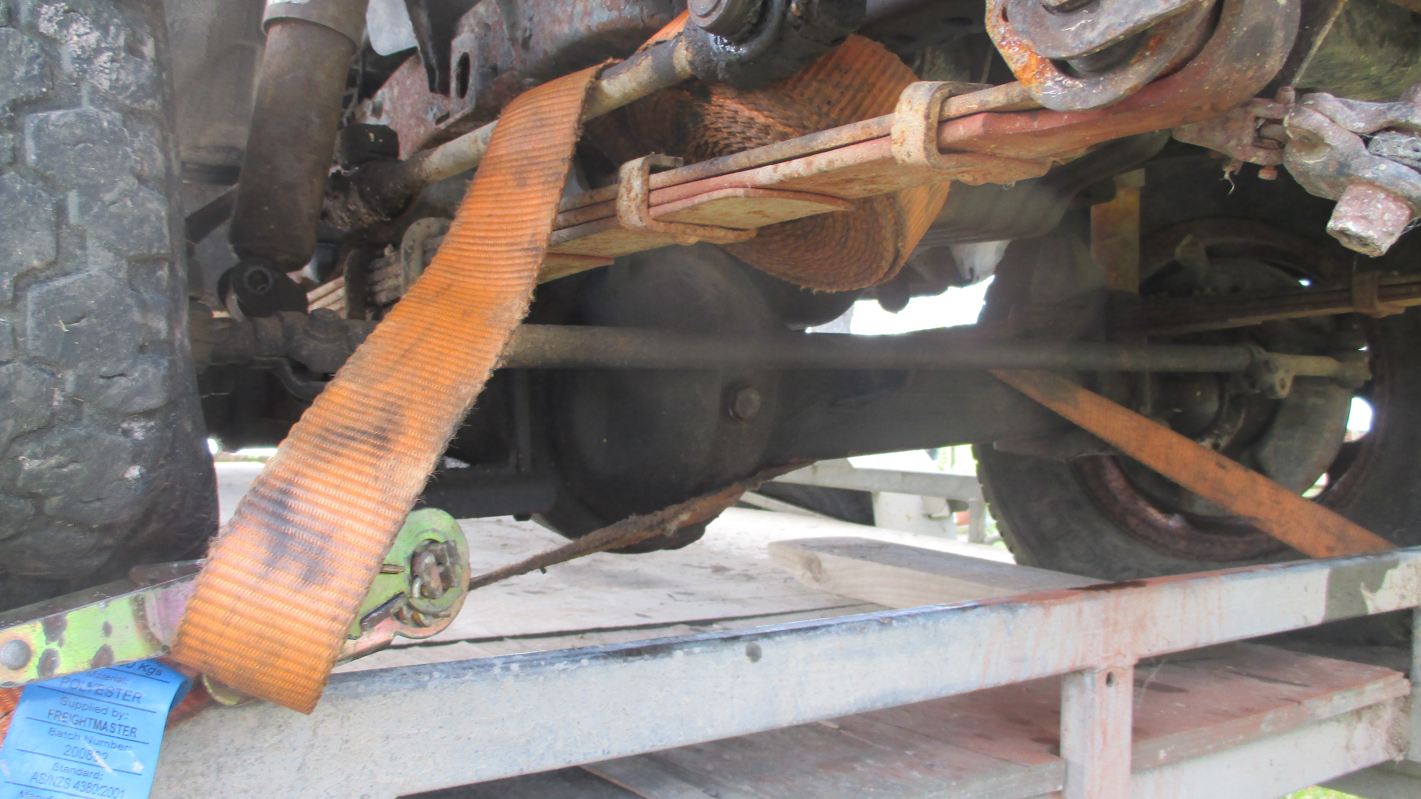

Here's how to fix it... :mrgreen:

yep, only way bro. :lol:

i knew someone would chime in with this.
that would most certainly fix my ifs problems
