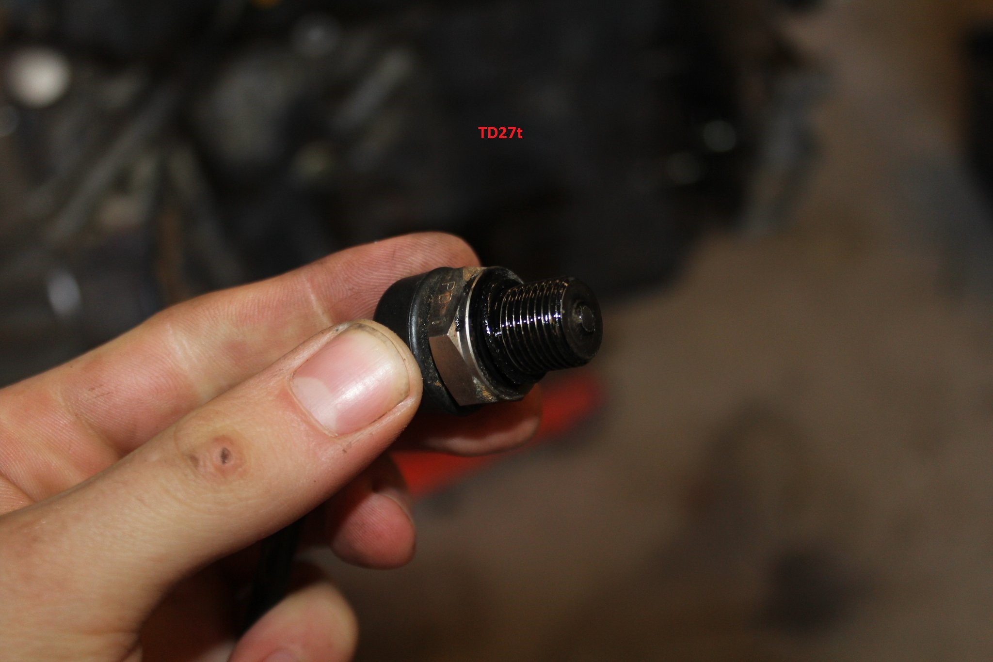

Hi,
I am also in the process of putting a qd32 turbo engine in my 92 terano.
With the engine RPM sensor swapping from the td27 to the qd32 am i right to just drill and tap a thread into the spot on the side of the timing cover? is there anything else i would have to do? any special distance? I have put the qd32 injector pump gear next to td27t and they have the same amount of teeth.

Can't see why not, but td27 one reads off oil pump gear doesn't it? td27 sensor on injector gear is for the EGR computer. Like what your planning to do. Have also read somewhere you can strap that sensor to an injector line to get rpm. Not an expert however. If your plan doesn't work just bung your hole up ?
Re: QD32 into WD21 questions
Posted: Tue May 31, 2016 10:26 pm
by Crash bandicoot
screw it back into the TD cover and measure how far it protrudes into the gear timing cover and replicate it on the QD.
Posted: Tue May 31, 2016 11:37 pm
by travis2ninja
fh2014 wrote:Can't see why not, but td27 one reads off oil pump gear doesn't it? td27 sensor on injector gear is for the EGR computer. Like what your planning to do. Have also read somewhere you can strap that sensor to an injector line to get rpm. Not an expert however. If your plan doesn't work just bung your hole up ?
Na, td27 use the oil pump gear, td27t use the Injector pump gear. Strap sensor to an Injection line? What what

Found it at the wreckers in Albany, had a faulty Injector pump / injectors and was blowing tuns of smoke, picked it up for $220. Its a N/A qd32 which is what I wanted for the 6 bolt transmission. I also have a spare working terrano I picked up for $300 which is what I used for injector pump, turbo and other parts. Managed to find a thread tap and got the sensor off the td27t onto the qd32.

Can't go wrong with a price like that. Be careful when dropping the engine in, the sensor pretty much sits on the steering box when in the vehicle
