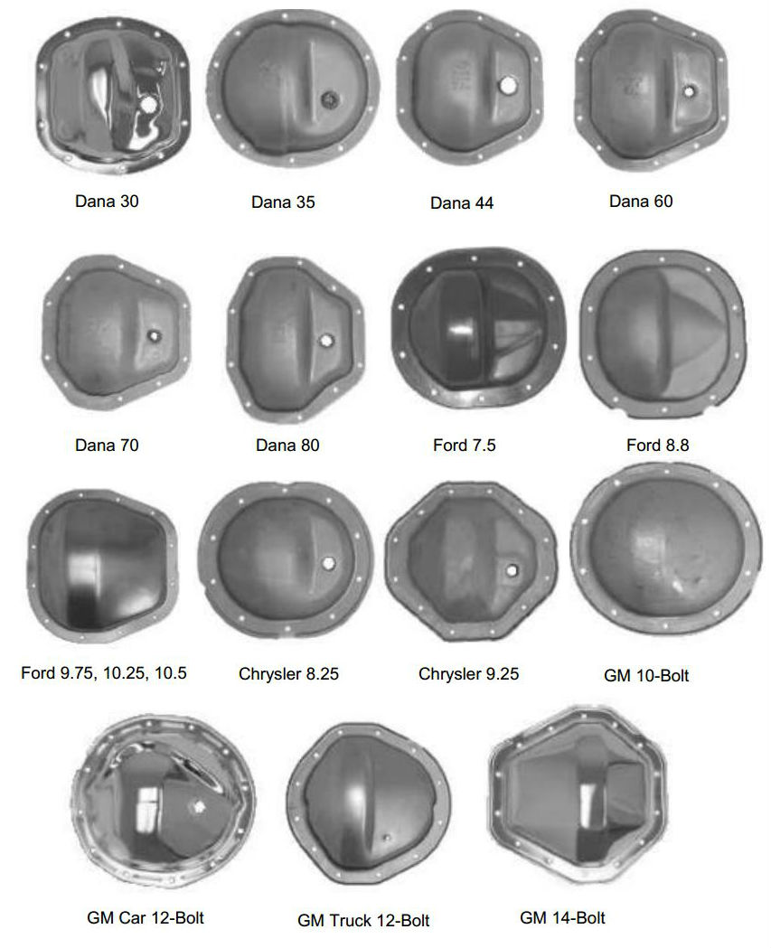

Who is in the know on these. I have had one in my cave for a couple of years. Broke a front axle last time I took it out, but dont know what the front diff is. I have read that they have Dana 44 and 30 but how do I identify them, and who has parts for sale. Cheers

might help might not .......................... :wink:

Thanks, will help for sure
