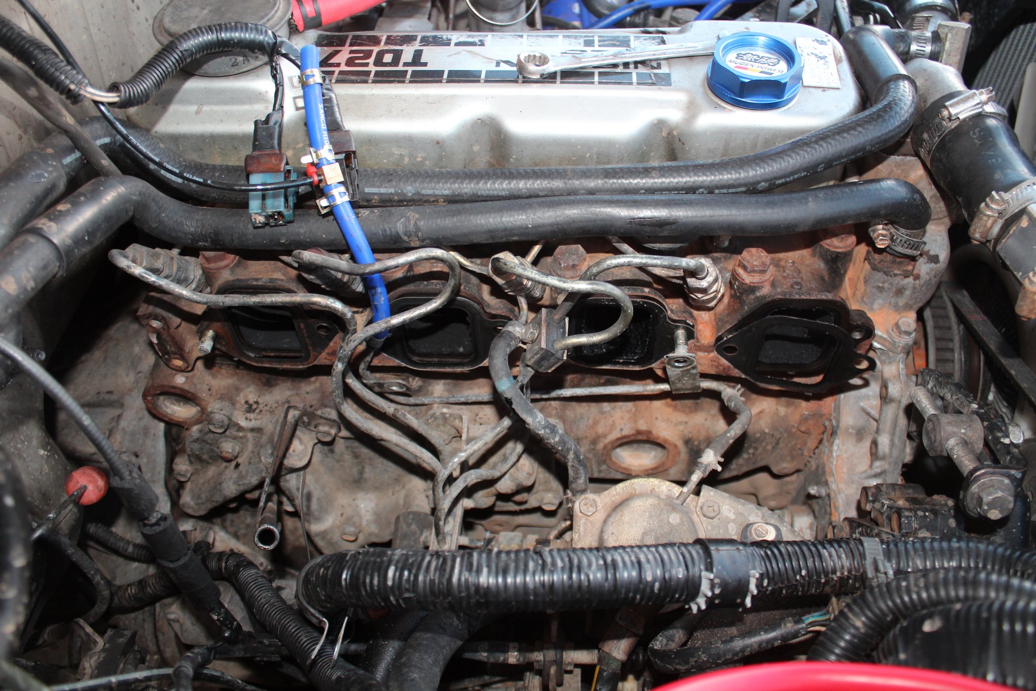

I have a small diesel leak somewhere around the injector pump and I'm in the process of a bit of dismantling so I can get in there and have a closer look. Is it possible to remove the manifold with the injector pipes still in place? I've disconnected them all at the injector ends and that gives enough wiggle room to get out all the manifold bolts except one (4th from the back), which has a pipe junction right over it with a hose coming off running under the manifold - and the bolt is right under the hose. I can get the hose off, but that still doesn't quite give enough access to the bolt head. Do I need to remove the injector lines completely to get the manifold off - and if so how do i get access to them at the pump end to disconnect? Or is there something I'm missing .... It feels like this should be easy but I just can't see a way to get at that last damn bolt.

Yes, should be pretty straight forward. just need to take of all manifold bolts and wiggle past the injector lines.
Is the fuel coming from the injectors or the injector pump?
There is only 3 fuel lines, and if any of them should be able to see and replace without removing the manifold.
Here are some photos with the manifold removed and injector lines still in place.
If you do remove the manifold i would definitely clean it also, it will be full of oily exhaust dust sludge !

travis2ninja wrote:Yes, should be pretty straight forward. just need to take of all manifold bolts and wiggle past the injector lines.
In your first picture, I can see your 12mm ring spanner on the block. Directly down beneath the ring end of that spanner is the injector that is causing me grief, the one with 4 lines coming off it's housing. I just can't get at the bolt directly beneath it - even with the lines removed at the injector end. But obviously you managed it so I'll just persevere and see if I can wiggle it a tiny bit more :-)

Anyway ... for the sake of anyone else who's doing it, I finally realised how to get off that last bolt (and all the others actually). Instead of coming in from the top of the engine and using a ring spanner, you come in from the left with a longish socket extension *beneath* the manifold. What a muppet! In my defence I was trying to do it in a dimly lit garage holding a crappy torch in one hand. Once I pushed it out in the sun it was fairly obvious. Anyway, I can get it off and on again now easily in less than an hour - done it three times already trying to track down this flipping diesel leak. But that's for another thread ...
