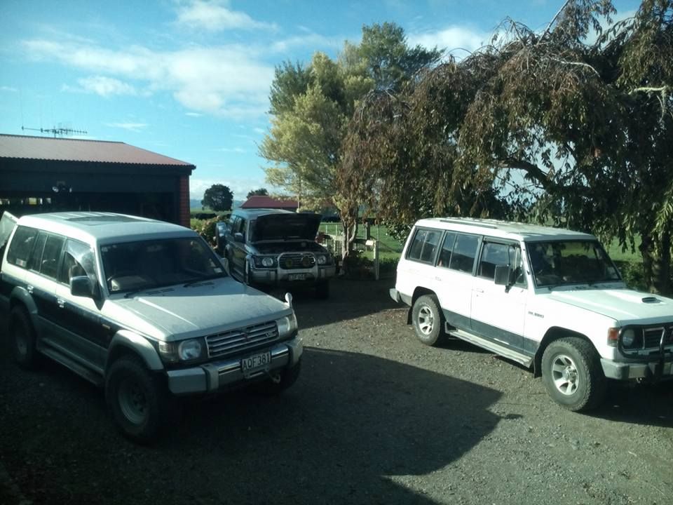

by the examples you have given terrano mistral etc, you may aswell just start hunting around for a LWB GLS or field master spec'd pajero.
I picked one up for 1500 with center diff lock, rear diff lock, 33's 7 seats multi zone climate control, leather interior, 146,000 kms on the clock
another for 1200 not quite so well eqipped and another for 400 that needed engine work.
