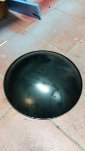

so, I followed Calvin´s advice and gave it another shot...
space is too tight for a fan underneath the IC so I decided to put in an additional heatshield just between the heat shield of the turbo (there are cooling slits right up to the IC :twisted: ) and the IC itself. would say there is a clearance of about 2,5 " between the two.
was thinking how to do that and was searching the garage for some tin sheet when I found the lid of an old Wok pan :mrgreen:
as I like the recycling idea in general I just started to cut it out and bend it into shape an screwed it to the cylinder head.
as there is a nice airstream from the visco fan I finally decided to place some rubber mat from on top of the fan shroud to the lower side of the IC. this way there might be some air stream to blow away the hot air between the to metal sheets. or not. we will see. trial and error but better than before I guess. hope it won´t harm the turbo ?
[/attachment]
lid of wok pan :-)
lid of wok pan :-)
