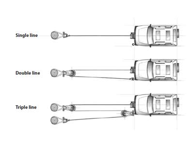

Here is an image that may help also.

Pulling straight line - you wind in 1m of rope and the truck moves forward 1m
Go through a block and back to truck - wind in 1m and truck only moves forward 0.5m as the 1m wound in takes o.5m off each side of the doubled rope. That is where the 1/2 the speed / double the force comes from.

It seems to me that the first picture in Jaffa's first reply and figure1 in his second reply are contredicting each other.
The way I understand pullyes, figure 1 is correct therefore a pullye fixed to a stationary object does only change the direction of pull not reducing the force required. Then the statement "2:1" in picture1 is not correct, as I cannot see a difference between a line running from a winch thru a pulley and back to vehicle (horizontal plane) and a line running thue a pulley verticaly with weight on one end and a pull on the other.
Am i missing something?
In saying the Jeep picture is also true where if 2 line supports a weight, then they hold 1/2 (here 9000lb) of the total load each. This can be true as long as the Jeep is stationary, as soon as it needs to move forward each line will hold 1/2 of the total load, but the winch has to move the total load ie 18000lb. Otherwise how / what moves the other line / side of the Jeep?
The way I looking it if I turn this from horizontal to vertical, the total load has to go up if the winch only pulling 1/2 what happens to the rest?
Then my earlier statement about the "But the tension in the line will not be reduced!" is NOT correct. ( I think)

Using one pulley but anchoring the end of the rope/hook back to the stuck vehicle gives a 2:1 pull, but if you did the same but attached the end of the rope/hook to a stationary object, ie. another tree/vehicle etc. then yes as you say the single pulley only changes the angle of pull and not the reduction ratio so you are still at 1:1
If you want a double line or 2:1 pull with the rope end/hook tied off to something static/stationary, then you would need to use two pulleys to get a 2:1 reduction.
Clear as Mud?

Untill I gain more experience in winching, I have worked out how much rope per winding, so I know if I have "X" meter of rope out my winch torque is reduced by about "Y"% . I will still have to guesstimate how stuck my truck is.
this is the black art of winching, also as you winch the rope will coil up more one one side affecting the ratio. then there is a winching time frame/heat build up/battery amps output etc just to throw more confusion into the melting pot
2,: In a self recovery a snach block does reduces the force on the winch and also the tension in the rope by about half. Note: if the return line is connected back to the winching vehicle than the mounts / chassie of the vehicle will take the full load of being winched inc mud, ect
correct
.....but if the return line is connected to a near by object then it will take about half the load, and the winch the other half.
wrong wrong wrong the winch cable must come back to the vehicle where the winch is to achieve a 2 to 1 pulling ratio. hooking up to a near by tree will only use more rope and recovery will still be at a 1 to 1 ratio
3,: The above will allow a lighter vehicle recover a heavier one by connecting the return line to a nearby stationery object, tree, rock, vehicle.......as it will take about half the load,and the winch the other half.
this comment is correct assuming that the lighter vehicle is not the stuck vehicle
4,:In a "slingshoot" ( front vehicle's forward facing winch assisting the second vehicle via a pulley fixed ahead and the line runing back to the second vehicle) winching the snach block does NOT halfes the load on the winch or the tension in the rope. But as more rope is of the drum the closer the winch gets to is's specified (lb) rating.
??? bit confused on this issue
5,: During the use of 1 snach block the vehicle will move forward with about half the speed the winch is pulling the rope in.
correct
6,: Setting up a 3 line pull (2 snach block) will 1/3 the load on the winch.With about 1/3 ing the speed the vehicle moves forward.
correct

driftinglobo wrote:4,:In a "slingshoot" ( front vehicle's forward facing winch assisting the second vehicle via a pulley fixed ahead and the line runing back to the second vehicle) winching the snach block does NOT halfes the load on the winch or the tension in the rope. But as more rope is of the drum the closer the winch gets to is's specified (lb) rating.
mudlva wrote: ??? bit confused on this issue
driftinglobo wrote:.....but if the return line is connected to a near by object then it will take about half the load, and the winch the other half.
mudlva wrote:wrong wrong wrong the winch cable must come back to the vehicle where the winch is to achieve a 2 to 1 pulling ratio. hooking up to a near by tree will only use more rope and recovery will still be at a 1 to 1 ratio
same thing, but top the winching vehicle is still and second one moving, bottom winching vehicle is moving and 'near by object' is still.
both 1 to 1.
Thanks for the correction, I got that wrong again! This was the senario that started my confusion about snach blocks pulling ratios.

a few uses of pulley blocks
