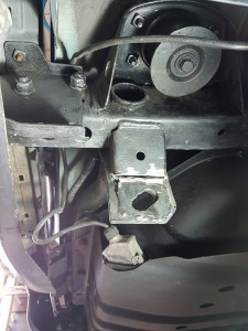

Taking back bumper off my Wd21 Terrano the other day I noticed the main mounts each end of the towbar beam are attached to the bottom of brackets that the factory bumper mounts to. These in turn mount to chassis rails ends, but those are perforated with big holes, I guess to be the first thing to crumple when bumper is hit. Seems dodgy mounting to this relatively weak part. Does this sound legit? Bar also has two small diagonal flat bars that go further forward and bolted through chassis rail vertically, with single bolt each. Dogleg one can just be seen partly behind tow point. Other one is straight though still angled.

more common to see them bolted to that bit of steel that hangs down (seen in the photo between the dogleg mounting point and the place where the tow bar is mounted to the chassis with two bolts) with the angled slot in it, suitable for recovery shackle.
How much weight are you towing? Or are you concerned about ripping it off during a recovery?

thanks Blake, yeah the tow points definitely look like the strongest accessible mounting point. Just not much to mount to for second bolt, assuming the first goes in the oval hole. Similar deal for other side.
Yeah, was worried about it's suitability for recoveries. The end of chassis shown is actually a bit bowed on the vertical part that the bumper brackets bolt through. Must've come down hard on the tow bar at some point...

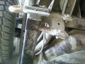

image of another method of attachment, using no rear bumper, custom mounts to chassis rail (with some sort of tubular bar above towbar?), and brace going forward to tow hook.
courtesy of BlakeNZ.
