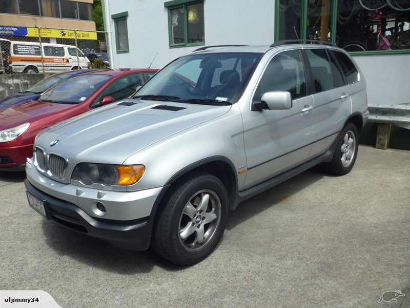

Slow progress, Been for a few good drives & Trans seems to be Ok. phew, I Still don't full trust it But it's looking promising!
Some Pic's from before I got my Hands on it. Had to use the sellers pictures as the first photo I took was in pieces...
